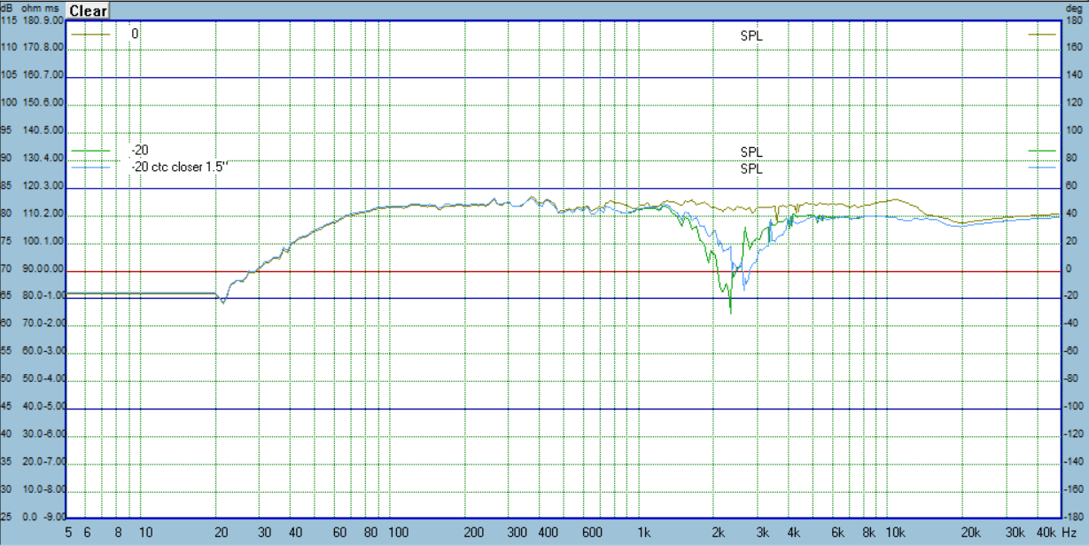

Here are the results of quick & dirty crossover modeling. Doing this mostly to verify the vertical response is as expected from idealized sims. 1.4x CTC...

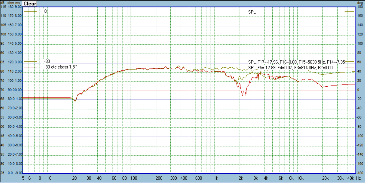

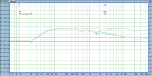

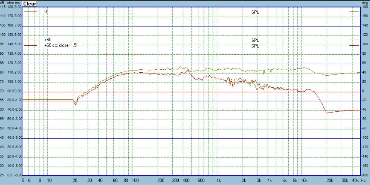

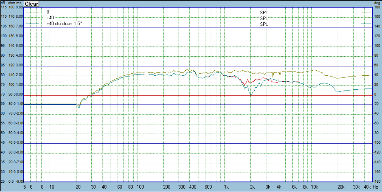

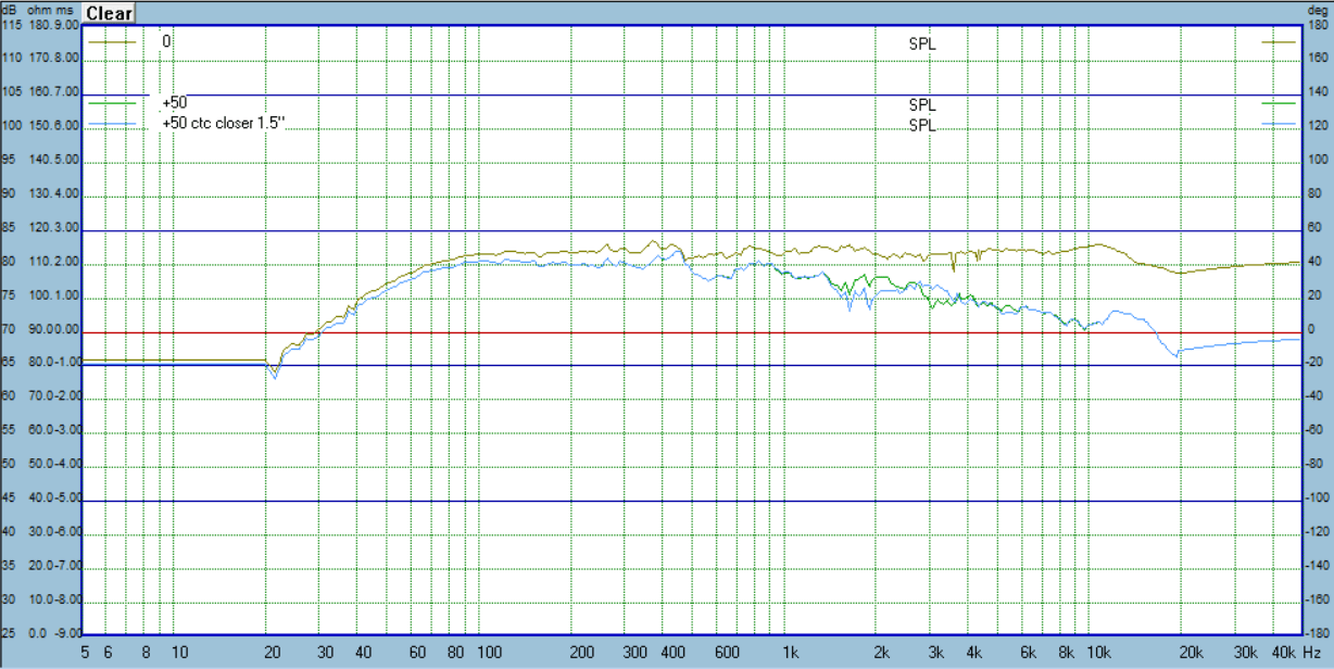

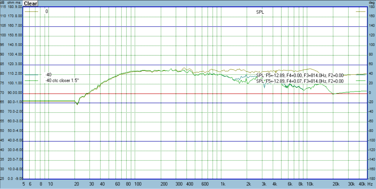

To further verify the vertical performance with regard to CTC distance, I played with the delay to mimic a 1.5" closer ctc. Per CEA2034, ceiling reflection is 40, 50, and 60 degrees, though I put the most weight on 40 when you do the actual math of a typical room. Floor reflection is 20, 30, 40 degrees, and here I prefer 30 degrees for most rooms.
