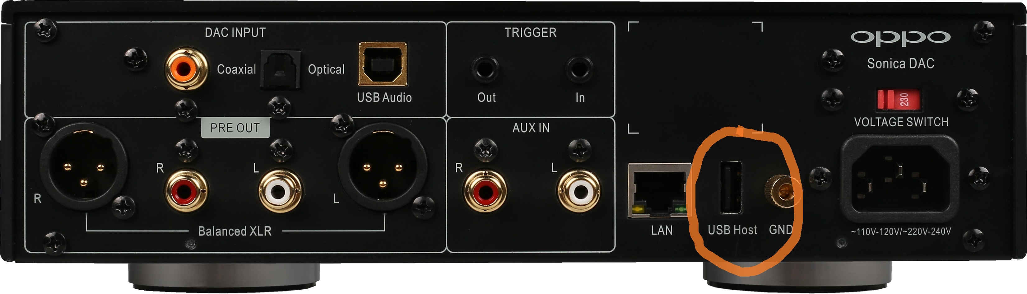

Does anyone have any ideas because the gapless in Oppo Sócnica happens? There is no solution ? How do reviewers not recommend avoiding buying a product with such a failure?
The Sonica DAC plays gapless from its optical, coax, usb and bluetooth inputs (usb input = connect a pc/mac/raspberry via usb). Also Spotify is gapless. If the Sonica DAC streams via DLNA from a networked disk or from a disk directly connected then it cannot play gapless. Only OPPO can tell why.
However, there is an easy work-around (and this DIY audio, isn't it!). I added a raspberry pi, installed piCorePlayer/LMS, connect through usb. Just a normal raspberry pi 3 will do, no additional cards/interfaces necessary. Now, this one takes care of gapless and if you wish also ReplayGain.
The sonica is a great dac for playing DSD and high resolution audio (24/88, 24/96 and up). I feel no need to improve on that. The dac uses a minimal phase digital filter. Many people like that. However, to my taste, I prefer a linear phase filter for CD-like audio files 16/44. Using the raspberry pi in front of the Sonica DAC, you can choose the filter settings that you like most.

Yes, Spotify on Sonica DAC plays gapless, I just double-checked it with Pink Floyds Dark Side of the moon: OK. (I don't have a Tidal subscription so I don't know about that).
If it is as you say it would be something that the reviewers would have noticed.
Both have free trial versions.
Here is the result, tested Tidal Hifi free trial, played Pink Floyd album Dark Side of the moon: NOT gapless on the Sonica. The same album on the PC with the Tidal app in hifi setting: gapless. So I guess, the Sonica app cannot play Tidal gapless, but it can play Spotify gapless.
