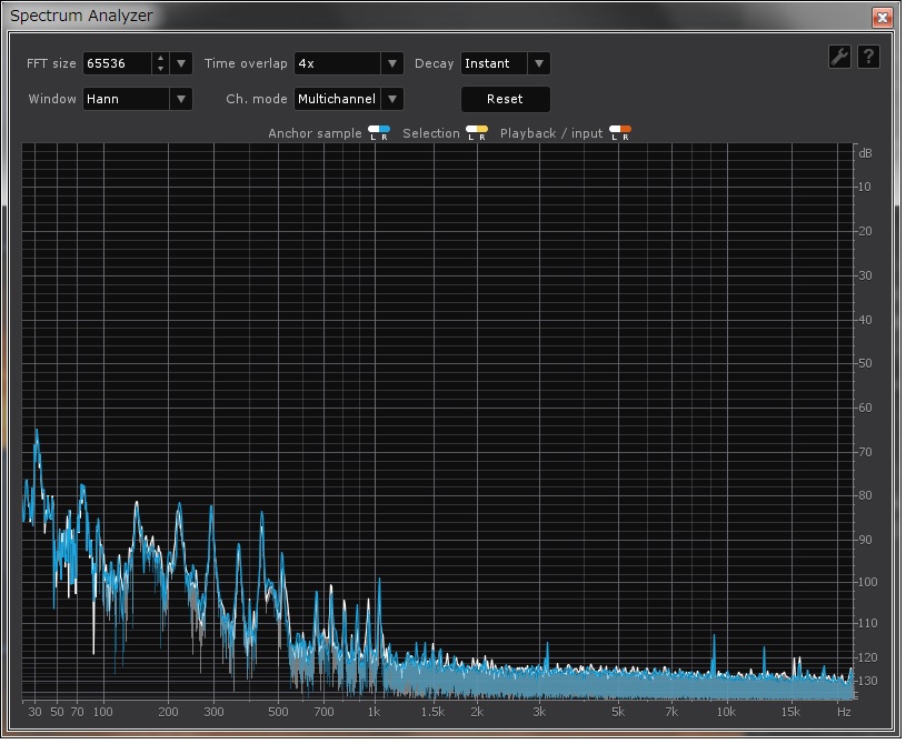

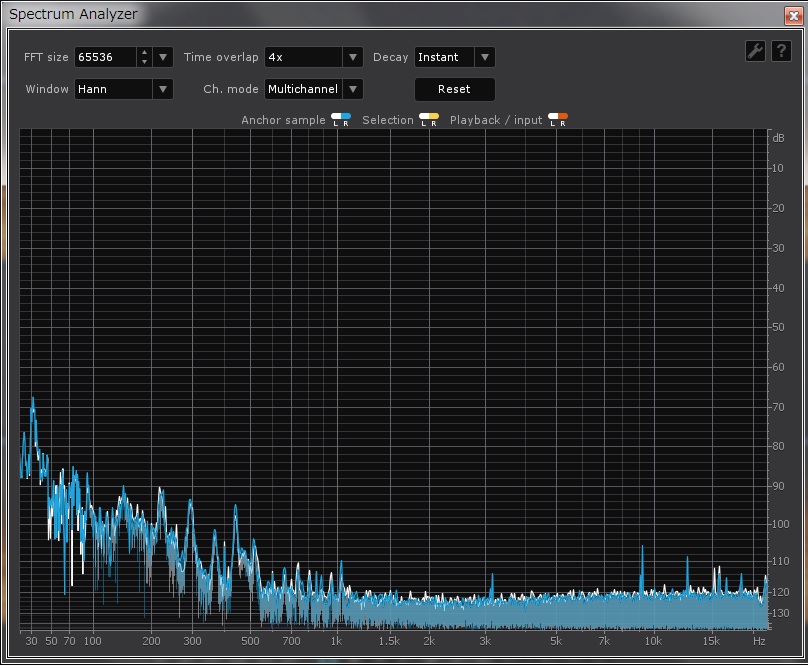

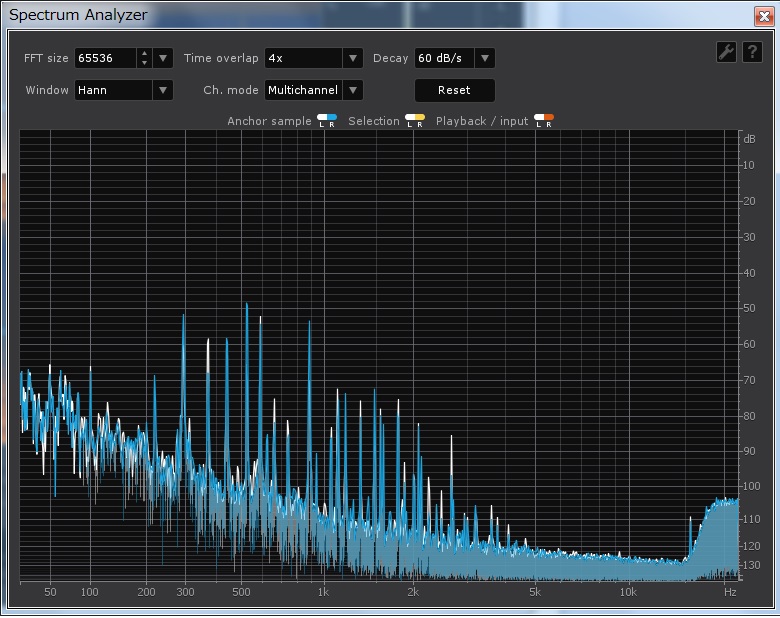

This is off topic but for your reference. There was a little surprise about pre-emphasis last month. I was under the impression that PE was already gone, no need to care about. But I found my music file ripped from "Afanassiev plays Mozart(COCO84057 released 2005)" was PE. I couldn't hear the difference even if they had an HF increase. The 1st pic is correct. The 2nd is incorrect which I used to listen with satisfaction. PE may be an assistant for my aging ear. I guess Wiki has some truth.
But there is a CD which I don't want to listen again because of the "hot" HF. This is the very disc MarcelvdG wrote at #128. "Souvenir by Suwanai Akiko (PHCP9675 released 1998)" has "noise-shaping" even if it's 44.1kHz sampling. The 3rd pic shows an artificial increase from 15kHz which is the consequence of noise-shaping without oversampling. Many CDs had such noise-shaping those days. I guess an engineer had concerning about decimating from 24bit to 16bit. They were in trial and error in the late '90s. I'm sure this was a failure. I prefer without DE to "noise-shaping" though some people prefer "noise-shaping."

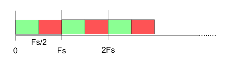

Pictures would help I suppose. Using 44,1 and picturing as a start something like...
@ ygg-it,
you have to keep in mind that the image spectra are a result of the time sampling process while the so-called quantization noise is a result of the quantization process due to the limited number of bits hence the limited number space. An additional contribution comes from the zero order hold if that is used.
"5) Oversampling with factor X, moves the first image spectrum to X-time higher frequency. Sample rate is now X*Fs and the Nyquist bandwidth is now X*Fs/2."
No, but the digital low pass filter tries to remove all image spectra at Fos and up to (X-1) x Fos. (Fos = original sampling rate)
In reality the digital low pass filter will not be able to remove the image spectra but only attenuates it (by how much is given by the so-called stopband attenuation).
The term "new" Nyquist bandwidth isn´t imo not suitable as the original audio bandwidth is still the same as before, but the quantization noise will be spread out over a greater bandwidth, so as a result the noise level in the audio band (0 - 20 kHz) will be lower.
"11) Digital filter mainly removes the "mirrored copies" of the original signal; the following Analog filter has just to suppress remaining noise ("quantization"?) till around X*Fs/2"
As said above, the digital low pass filter left over the image spectra around the new sampling frequency of X x Fos and its multiples (and below the residue to the non perfect filtering = limited stoppband attenuation).
So the now gentler analog low pass filter has to remove the left over image spectra and provides some additional attenuation for the residue.
