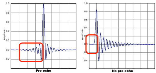

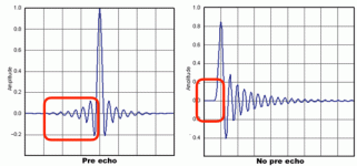

I have done some reading about an upsampling software Izotope and found that its behaviour is similar to the digital filter on a chip with respect to pre/post-ringing in time domain
resample
However depending on the sophistication of the software, the filter phase may be adjustable according to user preference. At the moment the common opinion seems to prefer minimum phase filter which has no pre-ringing and max post-ringing.
resample

A look at Cirrus/Wolfson, AKM, and ESS suggests their higher-spec chips are quite capable, and that dedicated hardware isn't buying you much. But people enjoy a wide range of solutions, and I'm sympathetic to the argument of doing whatever makes you happy. I'd argue people pursue the simplest/most straightforward (i.e. using the hardware given to us) first, and then diverging from there, but NOS DACs are inherently not as integrated.
FIR filter build in the chip can't be sufficient for 22.05K. Try to test yourself with Audirvana (Izotope - oversampling without filter) + Equilibrium (Ultra high end FIR, better than Chord DAC), as I explained in the other thread.
If someone prefers the NOS sound, is the "oversampled DAC but without digital filter" sound competitive (still natural and musical, like NOS BUT much more detailed, live OS)?
The quickest way to test it is just playing back 192K source with both type of DACs, because the ringing is most likely inaudible at that cutoff frequency. I doubt that there is any difference between them, or OS DAC should sound better due to newer architecture.
Too bad for me such softs needs a powerfull pc as I have only a Rpi for that purpose... not sure Sox in a Rpi can equal Audirvana or Signallyst....
If you are OK with one second latency, a few years old Intel i5 can handle FIR at 260000 steps, I believe.
Is it ok to ressample off line, with FIR software like Izotope, some 16/44.1 with our filter choice and upsampling choice then playback this new material to a NOS DAC with the same result (phase, sampling rate,etc) instead the operation was made online (as per the discussion above) ?
... then of course playback through the Rpi if the clock of the NOS DAC permitt it ? Or these new upsampled materials will be just filled with zeros between the original sample rate
