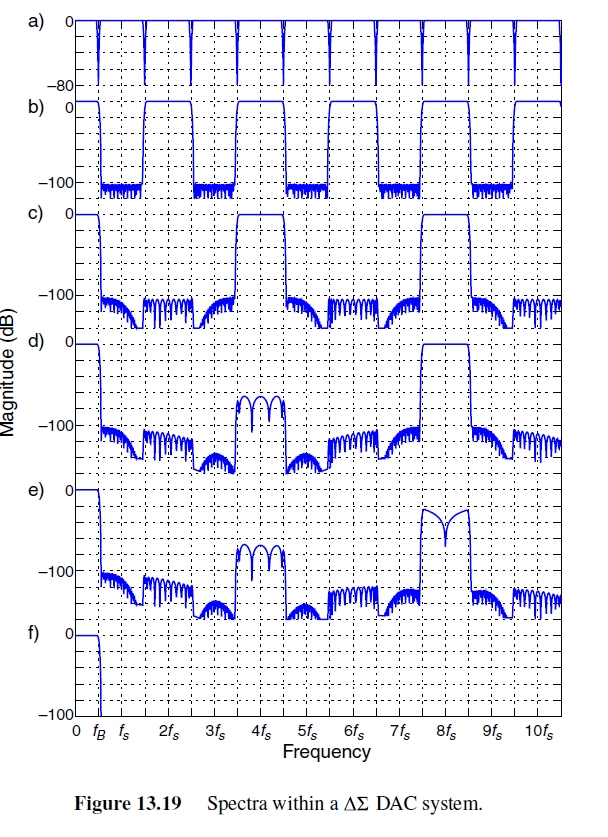

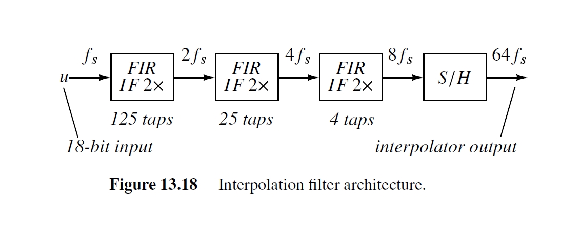

The ideas are explained in the book, Understanding Delta-Sigma Data Converters. Some attachments below illustrate.

How do you think the interpolation points are determined? It's not a simple process like just adding zero at upsampling process, which you call pseudo-upsampling.
The interpolated samples are computed by the filter to be as those values which low-pass filter away the image bands. There is no guessing or estimating involved, within the precision limits of a given filter implementation. So, I've been suggesting that interpolation is easier to understand if viewed in the frequency-domain, where it transforms in to low-pass filtering operation, rather than in the time-domain, where it wrongly tends to be viewed as an estimating of missing 'in between' sample values only implied by the available sample values.
What Plasnu is referring to sounds like it has to do with particulars of how interpolation filtering is best implemented. If we need to upsample by Nx, rather than doing Nx all at once, for example, it can be better to do 2x then another 2x then the last 2x, etc. In that case, the first 2x takes most of the processing resources. (The above assumes N is non-prime.).
Hi, Markw4, yes but that has to do with processing resource conservation, not filter accuracy, precision, or artifact minimization. It is an hardware conservation stratgy most commonly seen in on-chip based digital filters.

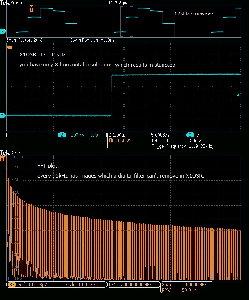

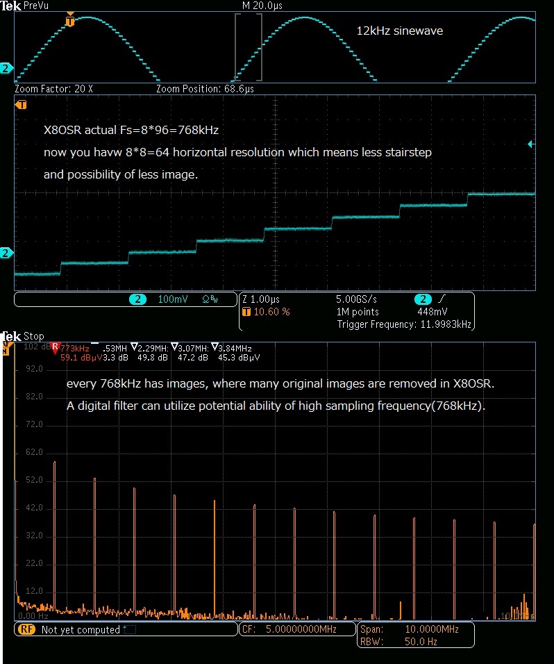

I also like an intuitive explanation rather than the mathematical one. My goal in reconstruction filter is to remove images as possible as I can. Images inevitably created by digital sampling look like stairstep in the time domain. So, if your digital filter can output stairstep-free waveform, your job is successful, intuitively. The 1st pic is 12kHz sinewave sampled by 96kHz(x1OSR), where you have only 8 horizontal resolutions which end up stairstep and probably many remaining images. FFT plot in orange says yes. Hard stairstep is equal to many images. In x1OSR, a digital filter has no power to remove images because their controllable bandwidth is up to Fs/2 while images are above Fs/2(even the 1st is from Fs/2 to 3*Fs/2).
This is a fundamental limitation of a digital filter. If your digital filter is LPF from 0 to 20kHz(precisely speaking, only BPF exists in the digital domain), you can remove images at HF. It's true if your filter is analog. But it's not true if your filter is digital. Why can't LPF remove images at HF??? The answer is simple. A digital filter has multiple passbands while analog one has only one passband. I guess this cause confusion about oversampling. If a digital filter had one passband, you wouldn't need to do oversampling.
The reason why a digital filter has multiple passbands is an inevitable consequence. A transfer function of a digital filter is a series of sin and cos. Sin and cos are a periodic function. So, a digital filter is also a periodic function. In the frequency domain, Fs is equal to 2*pi, where 10kHz and (10kHz+Fs) have the same output,ie sin(x)=sin(x+2*pi). Your LPF from -20kHz to 20kHz always appears from (-20kHz+n*Fs) to (20kHz+n*Fs). This is the cause of multiple passbands. The baseband LPF unconsciously makes multiple passbands which prevent you from removing images because images are also at passband.
The only solution to break the periodicity is to employ high sampling frequency. A digital filter itself has no power. Only high sampling frequency, in other words, high horizontal resolution in the time domain can do the job. Intuitively speaking, only high horizontal resolution can decrease stairstep. You must keep it in mind that a digital filter has multiple passbands because it's a periodic function caused by sin and cos.
The 2nd pic is x8OSR. No need to explain why it works well. High horizontal resolution(64) guarantees fewer images as you see. The 3rd is x64OSR. You can regard this as an ideal reconstruction because the output has almost stairstep-free. The 1st image at 6144kHz means quasi one passband even if a digital filter is used. This is the destination.
The true meaning of oversampling in reconstruction is to break the inherent nature of periodicity. If your digital filter is for crossover, no need to have an oversampling process since your target is below Fs/2 though it has multiple passbands. Reconstruction process must be under Fs/2. After the proper oversampling process, A digital filter can do the job for reconstruction.
