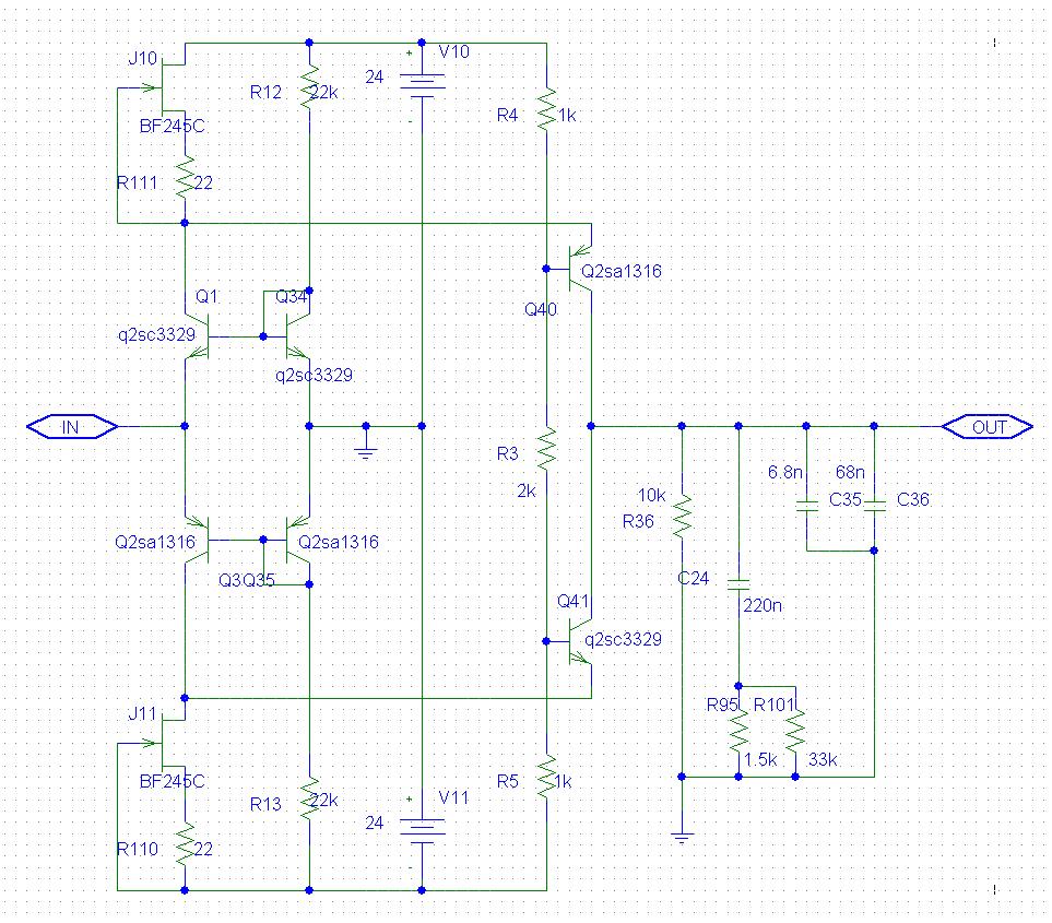

I have browsed this thread with great interest since i´m looking for inspiration for a phono stage that is a bit more universal than the one i am using now. The input stage of my current (pun intended) riaa you can see below, sans servo. I have used it for quite some time and it works (sounds) VERY good on the low impedance carts i use, SPU and Audio Note I/O. On carts with a little higher generator impedance it does sound a bit "over damped" if you will. I also use the same topology for I-V conversion in my dac but with 2sc2240/2sa970.
The output stage in the riaa is..........a tube stage......
BTW, i am not to happy about the idea of an integrated opamp as the second stage here, open loop allways sound better to my ears if done right.

Bappe, this is a good design, with limited application. At this time, fixed, VS variable cartridge loading is being discussed by my associates. We did NOT put variable loading in the JC-3 design. Was this a mistake? To me, being sort of lazy about this cartridge loading thing, I usually am happy with a choice of 100 ohms and 47K ohms for the typical optimal loading, but a number of my associates are NOT! Just as they have an obsession with absolute polarity, they also work hard at optimum cartridge loading. I have heard both effects, and VTA as well. However, when I want to just listen to a favorite record, I don't want to go through the bother. However, my associate, Brian Cheney, who maintains a listening room to show clients the quality of his speakers, is seriously concerned with each and every variable, and every record is marked for polarity, and he gets his cartridge loading to about 1 ohm resolution. It just depends.
Now, back to summing inputs. They work, but not universally, so they are discouraged in this discussion.
