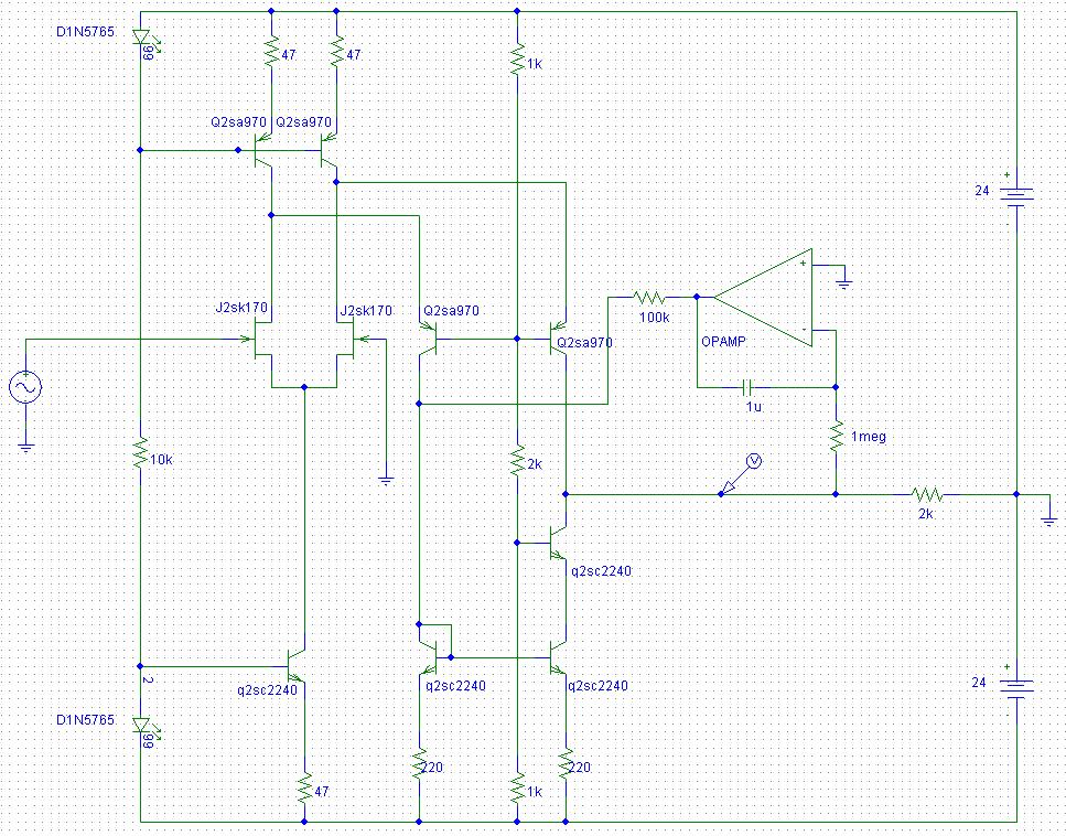

Sorry to break up the discussion about cart loading. Inspired by the Lux circuit and Johns designs i came up with the following basic design for a riaa input stage. It does fulfill the basic criteria of being non inverting and n-channel input only.
BR,
Anders
Hi bappe,
I like this design. I have been a fan of N-channel JFET differential input stages, even though they do not produce as low a noise level as single-ended designs. Even in an MC design, four paralleled LSK389 dual JFETs will yield 1 nV/rt Hz or better noise performance. BTW, my simulations show that 1 nV/rt Hz will achieve a 77 dB SNR RIAA equalized and A-weighted with respect to a 400uV nominal cartridge input voltage. For reference, I believe that the excellent JC-3 is rated at 75 dB SNR under the same conditions.
The differential input stage lends itself nicely to running with no NFB or with NFB. No NFB in the input stage is OK in this application because of the small input levels involved and the use of the differential input stage to keep distortion down. Also, the no-NFB stage makes it easy to go balanced at the input if desired.
Going no NFB does involve some gain and channel balance uncertainty due to the JFET device-to-device characteristics unless they are chosen carefully and matched, but this is reasonable in a high-performance design.
There is still the option of NFB or no NFB in the output stage, given that the levels will be higher. This may be more of an issue for the MM stage than the MC stage.
It looks like you are running the input JFETs a bit on the high side in regard to Vds; this could cause you to incur a noise penalty. If you wish to keep the output portion having as much voltage swing capability, you might consider adding a conventional cascode between the input drains and the folded cascodes.
If you are concerned about JFET input capacitance, you can use a driven cascode.
