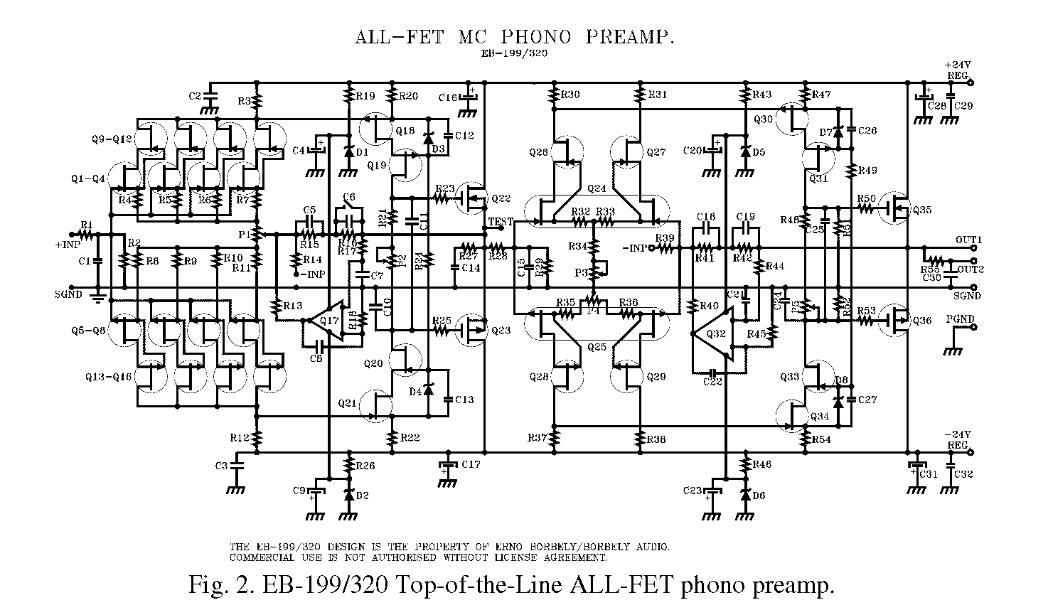

Hi Bob,
how about this Erno Borbely phono amplifier for both MM and MC?

Hi Bob,
No, too much input capacitance from numerous paralleled JFETs. If you get the noise low enough for MC use, you have probably ended up with too much JFET input capacitance for MM use. Bear in mind, this capacitance is nonlinear.
Bob
Bob
Yes, you exceed the recommended C with the FET's alone let alone the cable. The non-linearity at these levels is a problem overstated IMNSHO.
