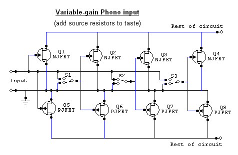

A step in the direction of a "universal" phono preamp could be achieved by making the number of input JFET pairs switchable. Going from four pairs to one would give a 12dB reduction in gain and a four-fold reduction of non-linear input capacitance.
If the gain of at least one input pair is reduced (by means of higher source resistors and/or different JFETs), a bigger ratio can be achieved, with sensibly sized steps in between.
A nice feature of the (simplified) schematic below is that the switch settings don't affect the quiescent operating point, so gain can be changed "on the fly" without fear of overly loud ticks or pops through the speakers.
Hi Godfrey,
This is an interesting idea, although one would have to balance the cost and hassle of the switches against the cost of just having dedicated input stages for the MC and MM functions. Also, you might want to make sure those switches are make-before-break so that no gates are ever allowed to float, even briefly.
My philosophy is that if we are really going for highest performance, we use different input amplifiers for the MC and MM functions, each finely tuned and optimized for its individual application. Indeed, if necessary to achieve the highest performance, even some or all of the RIAA equalization might be duplicated. Of course, the ultimate end of all this would be to have separate MC and MM preamps, where selection between the two applications is done at line level.
