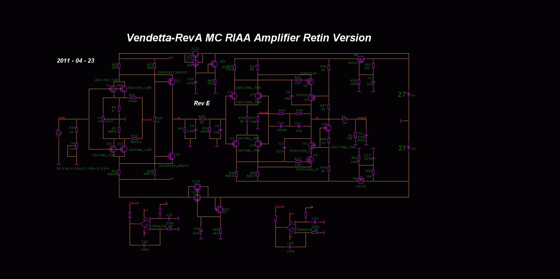

Here's my take on a "VendettaRevA" in Retin style. SNR is 75 dB rel 500uVrms 20-20kHz unweighted. Good enough, IMO. Gain is 64 dB. I remade the
DCservos a bit and I use OPA627 as DC servo OPamp.
I use Zetex ZVP/ZVN3310 at a failry high idle current instead of the original MOSFETs.
The 2nd stage in the first amp-stage is now made outof BJT:S running at around 20mA.

Good point, John. I have advocated the use of N-channel-only phono input stages all along, for both MC and MM designs. The LSK389 is a good part.

would it harm to take the first servo out.. and instead capacitor couple..in order to get too much varped record filtered out a bit..
It is not necessary to take the servo out and put in a coupling capacitor to achieve some LF rolloff to deal with warp. A properly-designed DC servo can be made to provide the desired first-order LF frequency response cut. Just remember that the DC servo is really in the audio path, and should be constructed with audio-grade components. It is part of the whole system. This is especially true when it is being used as a filtering function in the subsonic audio range.
Significantly, you can design the DC servo with an additional pole in its feedback path to achieve a second-order subsonic filter response if desired.

Yes, you can put in a say 10n cap before the 1000k resistor and get a 1st order roll-off at around 15 Hz.
