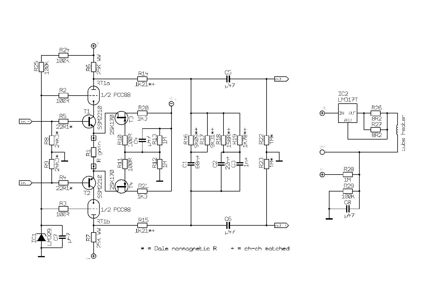

The noise may be marginally higher, but I doubt it is material.
I actually achieved lower noise than the Vendetta measured by Stereophile had using only 4pcs of 2SK170 (and a bunch of tubes, all of it zero feedback as well).

Ingemar, I think Allen Wright did some non-complimentary phono circuits that were also 2SK170/valve hybrids and freely posted the schematics.
Scott,
I have done similar circuits, they are also in the public domain. They are good, but not that good, rather interesting however.

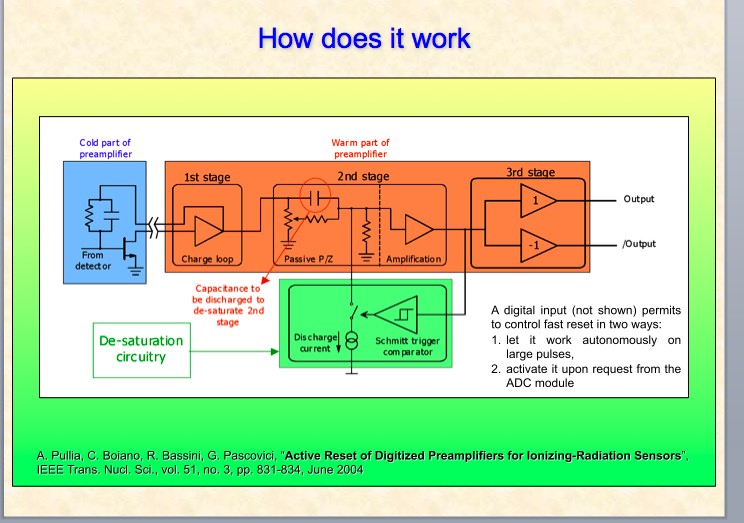

The particular design I referred to uses an input stage that was derived from a preamp designed for the AGATA Project (particle physics research gear), this is also in the public domain with a schematic, of course it was adjusted for audio use.
Anyway, the point was that a quad of 2SK170's can be as silent as the Vendetta measured by Stereophile. Actually, the Vendetta was one of the Units I considered to be benchmarks for low noise during the design phase and hence to be equalled or exceeded.

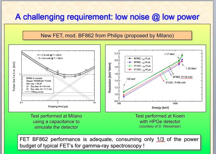

This seems a later version perhaps from the one I looked at, maybe not, your slide has little detail?
At the bottom line there are 4pcs 2SK170 in parallel in my design, with some unique twists that allow me a 42dB range of adjusting gain without significant noise penalty (unlike for example the common Microphone preamplifier chips) and low enough effective input capacitance for MM cartridges despite these 4pcs in parallel. The actual design methods are entierly conventional of course, just pure open loop.
I doubt too much of this design is of use for DIY anyway, it was arrived at to produce a certain set of parameters and features for a certain commercial nice.
A DIY'er can optimise things by far more for a single pickup, commercial products, especially in the high end of the high end must take "all comers", so the same performance is much easier to attain in a simpler DIY circuit.

Thorsten, when you use the AGATA circuit you better cool it down quite well. I do not think you do so what is so special you do ?
We do not cool it.

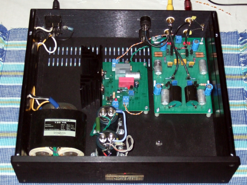

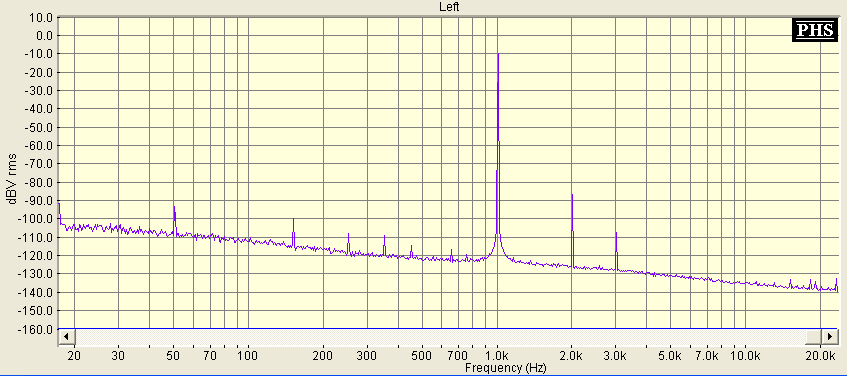

Indeed, the bloody things they smell AC mains fields if Tx is in same box even from the wiring. You can see the harmonic mains needles on my 61dB open loop DIY. But I can live with it at that level when still in small sized single box, I have a small rack. That is from 3XJfet front end & 2XBJT cascoded. (Graph=0.25mV input, 0dB=1VRMS).
Yes, the amount of shielding we build in is heroic, all AC wiring is twisted. My one is 72dB maximum gain... I learned things I NEVER wanted to about how magnetic fields behave in designing this one.
Next time, if I can, I put the mains transformer into another box, preferably a few meters or even kilometres away...
