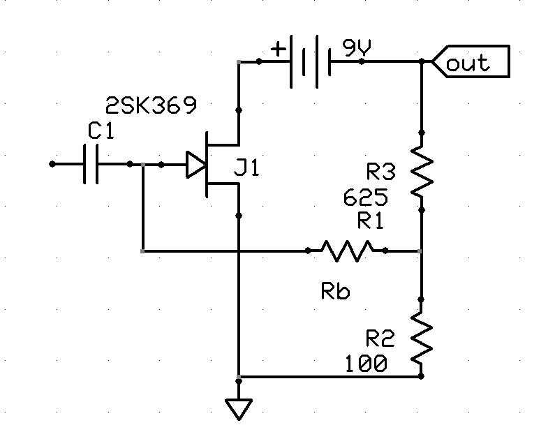

Let's not, Ed you are welcome to demonstrate -90dB number but ..... Here's a fun circuit. The simplest possible (I think) .4nV, 40dB or so head amp. Suitable for headshell mounting and phantom power. Cin and Rb can be traded off for low end noise/cost. .33uF and 5G Ohms works pretty well. The rest of the values need to be tweaked to split the supply and run the FET at around 5mA. MC only in this form due to input C though one might be able to work a cascode FET in there.
EDIT nope THD is only good for MC.
Looks like expresspcb's schematic program. (You missed a connection at Rb)
So how do you convert to jpeg?
Screenshot
I usually don't bother with the T connection, from now on I'm going to have Jan redraw all my schematics.
This was intended originally as an improvement (I hope) on the front half of the pre-amp in the Levinzon IEEE paper. With his current-in second stage it might work for MM. Just playing around.
