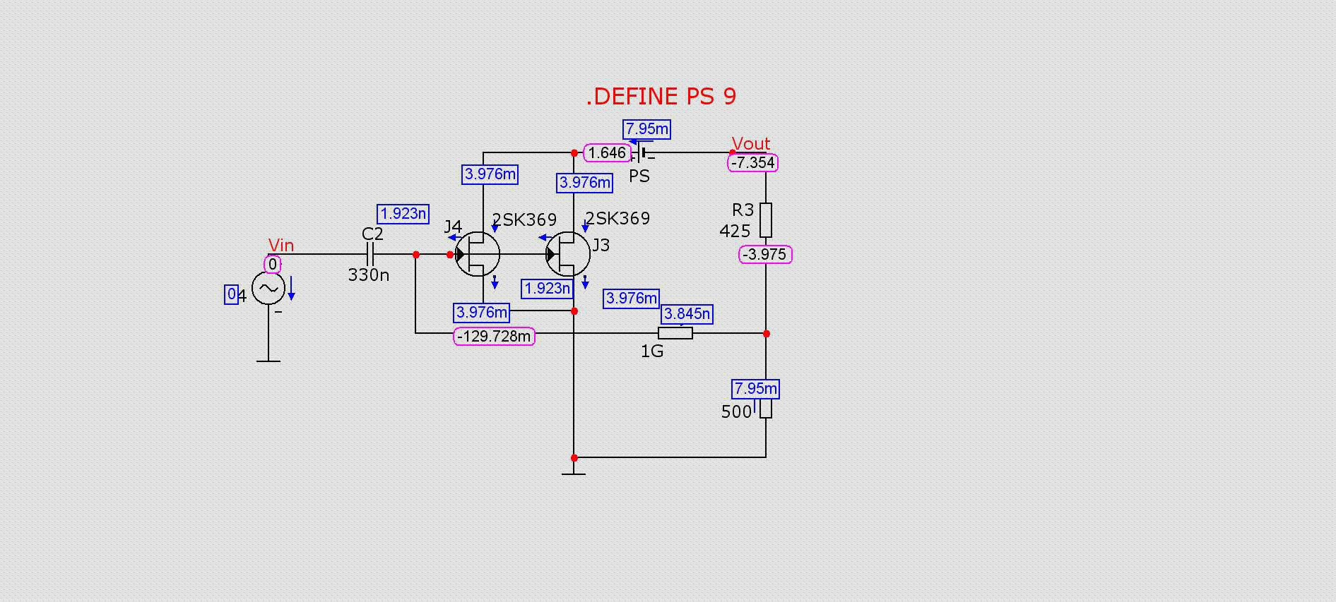

This was intended originally as an improvement (I hope) on the front half of the pre-amp in the Levinzon IEEE paper. With his current-in second stage it might work for MM. Just playing around.
Cool circuit!
I verified the circuit in my simulator. Well, I got 0.5nV/SQRT(Hz) at 20KHz, and a total noise of 80nV from 20-20kHz.

Let's not, Ed you are welcome to demonstrate -90dB number but ..... Here's a fun circuit. The simplest possible (I think) .4nV, 40dB or so head amp. Suitable for headshell mounting and phantom power. Cin and Rb can be traded off for low end noise/cost. .33uF and 5G Ohms works pretty well. The rest of the values need to be tweaked to split the supply and run the FET at around 5mA. MC only in this form due to input C though one might be able to work a cascode FET in there.

Unfortunately the FET's would need heroic matching, better to think servo but have not considered it. I probably ignored the parasitic Rs and Rd of a few Ohms each. As it is couldn't be more Zen.
I'm not up on battery noise, but there is some PSRR (25dB or so) but if the battery was horrible you might want to bypass it well.
EDIT AudioXpress found 9V alkaline noise "unmeasurable" and the series resistance is 1-10 Ohms.

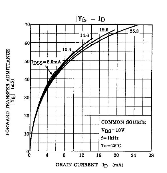

EDIT - 2 at 8mA total gives 72mS gm or ~10 Ohms noise resistance. My Quan-Tech measurements showed the Toshiba Fets to be right on the 1/.7gm as the equivalent noise.
No, Scott, the Gm of the part at 5 ma.
Sorry I said I misread Lorizen's data. A 2SK369 has ~36 mS at 4mA so two (2) in parallel @ 8mA will have 72mS or 9.72 Ohms (+-) noise equivalent resistance. Syn08 did a little better with BF862's but he used a lot of them.
OK, but that is like going from a 4 cylinder car to a V8. That is how difficult it is to get 10 ohm equivalent noise with jfets.

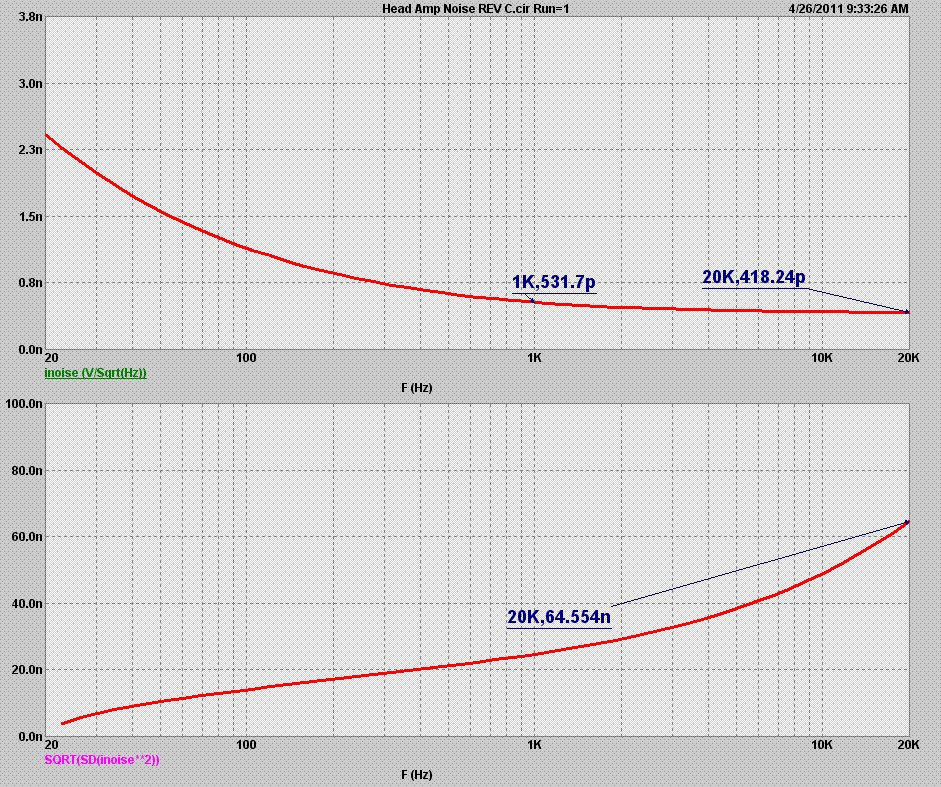

Adding another 2SK369 with my values as in the attached schematic gives about 0,531nV/SQRT(HZ) at 1kHz, and a total noise 20-20k of 65nV.
