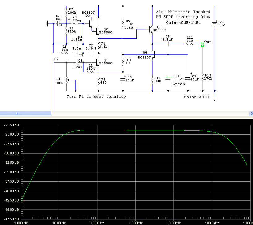

Can you draw a little schematic?
I can, except Altium quit on me after installing Win 7 SP1 and my ancient copy of PSpice quit working when I went to Win 7 64 Bit. SO I do it when I get everything reinstalled.
Untill then it will have to be over a pint of linn dubh (known to the ungodly as Guinness) or two on the back of a serviette (don't worry, I get drunk after one beer, I just can never remember if it is the 13th or 14th)...
Meanwhile, there was a schematic for the Creek OBH-8SE posted in this-here venue, courtesy of Alexander Nikitkin aka xpro (who's Idea I appropriated) which can illustrate the principle, if using mostly transistors suffering from split personality (bipolar disorder).
Ciao T
The SE has a Jfet cascoded by the lowest NPN Transistor instead, but the principle remains...
Very smart it is too. It is not a SRPP BTW, more a Mu-Follower, but with a pentode analog in the lower position, meaning gain without the load is sky-high.
Ciao T

Yes, a J something...
Link to SE Schematic is in this post:
http://www.diyaudio.com/forums/analogue-source/151527-how-convert-creek-obh-8-mc-cartridges.html#post1983686
Ciao T
Can't remember how Alex was designating the topology in old posts exactly, but now you say I remember the Jfet too. Was it a Jxxx American fet?

Your missing my point.
I offered a circuit that makes its own minus voltage so you don't need source resistors to bias at less than Idss, a cute trick (I saw it years ago at least 1976). I think Salas has carried on a long thread on another way to do it. If you parallel devices and set the drain current via another feedback loop as here matchiing buys you nothing and you don't need any source resistors.
I don't know why things get so sidetracked, I could care less about the last iota of noise.
EDIT - I've corresponded with Charles, ironicly nowhere does he say to match the 2 FETs in parallel on his amp (it does not matter).
Scott,
Sorry for missing that, maybe because I work mostly with tubes and this "trick" is quite ancient in the tube world (mains powered 1920's Radios and Theatrical Amp's often got their bias that way) and very common?
FWIW, several of my products and some DIY designs all across the board use this "trick". So sorry, for not picking up on your intention with this circuit, I just did not think it all that great an idea overall...
In this specifc circuit your trick imposes an AC coupling cap on the Fet Input (there is yet another trick to avoid that of course which was also common in 1920's Tube circuits, but it only shifts the cap to somewhere else).
At 1KHz your 0.33uF Cap has an impedance of 480 Ohm.
While in itself noiseless as a reactive element (just like a choke and the OLD MM Cartridges 0.5h INDUCTANCE IS MOSTLY NOISELESS), the impedance of this capacitor will be in series with the cartridge and hence will appear as impedance across the input of your Preamp, where you have large value resistor (at least 56KOhm to get around 8Hz -3dB point) to apply your bias voltage.
This resistors noise will now be shorted only by the Cartridge and the 0.33uF Cap, so at 1KHz your effective noise will equal sufficiently closely 482 Ohm + Cartridge Impedance as not to make a difference.
You need to increase the coupling cap 100 fold to 33uF in order to get around 5 Ohm Impedance at 1KHz and your noise at lower frequencies will still be high. Hence one frequently sees very large value coupling caps on MC Stage inputs, I should think a few 1,000uF would be needed before this cap does not severely degrades the SNR.
Hence my recommendation to direct couple the cartridge to the gate, to avoid this noise source entirely.

This will make a cute enough headamp, add a few uF output coupling cap (to reduce the hum pickup and noise on the input of your MM Phono) and done.
Me, I'd probably use a 317 to make a higher voltage and then a few 150R/3,300uF Elna Silmic RC filter cells (around 3V per cell) to get the 317 noise down.
With 150R/3300uF the filter corner is 0.3Hz, so with 3 cells we get theoretically 120dB attenuation of the 317 Noise at 30Hz, practically less, but it should suffice, a well set up 317 is only around 2-3uV RMS.
The voltage from the 317 should be around 20V, we loose 9V in the filter-chain, I would probably trim the 317 Voltage for 8V on the 2SK369 Drain.
Lower noise is possible, but to get at least 6dB improvement on the single, source resistorless 2SK369V (or 2SK147V if you have them) is a major PITA and in my books less than 6dB improvement to a "pretty much good enough" circuit is not worth the hassle...
Yup, makes two of us, I just want low enough noise to listen to music...
Ciao T
Ciao T
Its not only about noise IMHO. Its the Zo of a PSU and its shape which is very important too. That is why I opt for super shunt regulators. The input CCS that lends the 'super' term (by Stax in the 70's) its not the end all firewall at all for downstream gremlins from the rectification and general grounding, for those where in frequency and how they circulate in the loop areas it would not do more than a resistor in practice, but it lends the benefit of steady current draw from the feeding loop. That is the main benefit of CCSing the regs in my opinion. That opens the road for less concerned use of passive filtering elements in the main PSU also. Now for Vref considerations or a real regulator, not a filter, and noise:
IngemaR had simulated 25nVrtHz for a V1+EF LED string referenced 18V shunt reg with Toshiba Jfets and BJTs when the ref is filtered with 220uF or more. That will be equivalent to a 39K resistor and 3.55uV across 20KHz BW output noise. With that kind of psu noise the flat extended mOhm range Zo especially when the shunt element is buffer driven (+EF) becomes attractive IMO. The passives, Teddy Cmult, etc. pale for Zo spec and shape, which becomes increasingly problematic for interactions of low psrr ccts the more stages we want to feed from as simple a psu assortment as possible. The shunt route takes us a long way towards low impedance rails with just one central psu arrangement even. That is build economy. Remote sensing keeps the psu away enough safely for low Zo on another board so not to heat up the input devices and make them noisier by psu sinks proximity in a low MC phono. The subjective dynamic rendering and resolution gains had been reported back in a steady anecdotal vein by a multitude of happy campers if it matters at all. So its a matter of architectural approach mainly, many ways to skin the cat, but that is my preferred approach more analytically so to speak since I have seen it shortly discussed noise wise for passives VS actives in a previous post.
