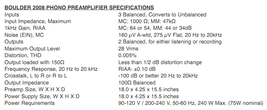

BTW, if I'm not mistaken, the $20+k Boulder preamp is specified as having about 190 nV equivalent input noise, and has been described as dead quiet by a Stereophile reviewer. If we assume that 190nV spec by Boulder is for a bandwidth of 20 kHz, weighted flat since it is specified as input-referred, that would seem to come out to 1.35 nV/rt Hz. I freely admit that I may be wrong in interpreting the Boulder spec, however.

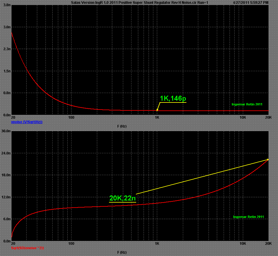

I simulated 26 nV TOTAL output noise from 20-20kHz (and not 26nV(SQT(Hz)!
See attachment.
/IR
See attachment.
/IR

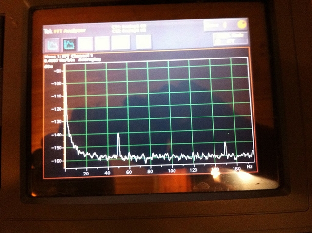

Its built a bit by now...like in the FFT screen post #609. Has no external loop feedback or opamp. The reference is not RC filtered, only shunt C 100uf for that FFT.

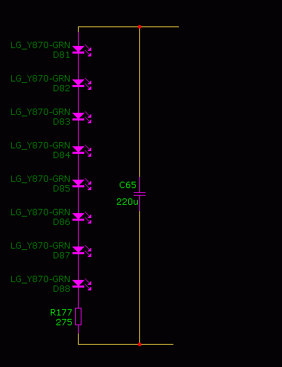

Real green LED's are around 0.5uV noise at 1mA, a little less at more current, more at lower current.
You have 8pcs strung in series for around 16V reference voltage and 8uV noise.
This is around 6db better than the rather noisy LM329.
I'm not sure of the slope impedance for the LEDS, but it is usually a few ohm to 10's of Ohm. Let's take 20 Ohm, so 160 Ohm total. You add another 275R for a total of around 450 Ohm.
With a 220uF cap we have 36 Ohm at 20Hz and so 0.7nV|/Hz...
The 3dB noise corner on that assembly is 1.6Hz.
I think it would be highly desirable to feed this whole reference circuit into a CCS to minimise any AC current through the string, probably also using a J-Fet as error-amp to avoid drawing AC current through the reference chain would be good.
And it still is not really any better (except LF impedance) that a single 3,300uF Cap at the end of an RC filter chain where it matters.
It may be oldfashioned, this RC filter chain thing, but the engineers from Neumann, Technischer Aparatebau, Pulse Technology and co. knew what they where doing, in part at least evidenced by the high regard these old units are being held among the cognescenti in recording for outstanding sound quality.
Well anyway, I know what my first choice would be... ;-)
Ciao T
Ciao T
Noise voltages do not add arithmetically. But you probably already knew that. It would equal the square root of the sum of the individual values squared, if totally not related. Which is almost the example here, although some coupling could occur due to poor construction techniques.
So the noise for the string of 8 would approach 1.414 uV
