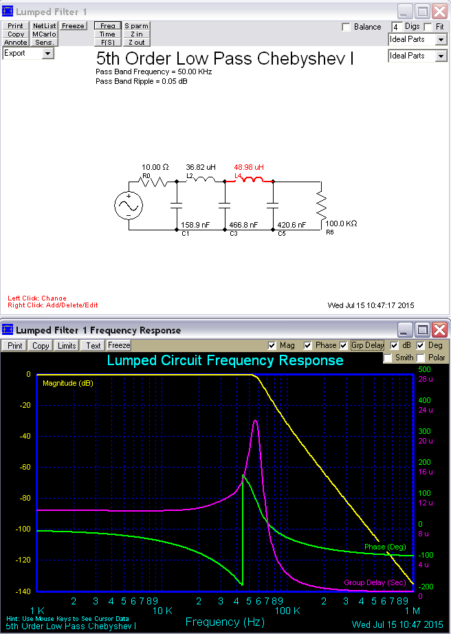

These are 250W Class D amps with significant 480KHz output that clips the sound card input buffers. :(

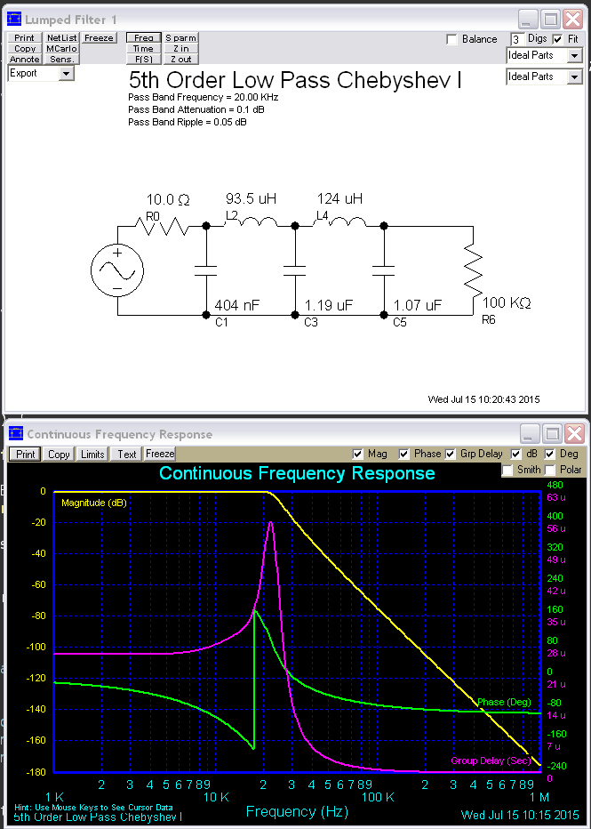

Here is a simple passive filter which does what you need. Beware that
the 10 Ohm source impedance is important and that the values should be better than 2%.
Use Polypropylen capacitors and good wire wound inductors, ideally with an air core.
The second filter has a -3dB of 50 kHz and imperfections of L and C do not effect the audio band as much as the first version.

JohnW, It is the input opamp that I am clipping because of the high amplitude of the switching "noise". The clipping issue is no different with an active filter because it also uses input opamps similar to a sound card. With a passive filter network, the switching noise would be reduced and not clip the input opamp of the sound card.

In my experience the AUX-0025 is only required with AP's - I've never need to use it with my R&S. The use of the AUX0025 introduces quite high distortion - around 0.0025% IIRC.
If low distortion is important then I do not recommend a L/C filter design as standard inductors struggle to achieve THD below 0.001% due to there core hysteresis - air cores are linear but it requires great care to prevent them coupling with the chassis & each other.
A very simple single stage passive R/C filter will reduce the high dV/dt EMI of a ClassD output stage to a level that will not upset a decent opamp.
