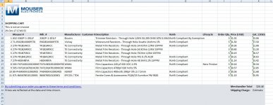

Bumping this up. Got myself a Prism Dscope IIIA+ I'm using when repairing/playing around with amps (car audio stuff). As expected, having some problems with class D amps. Seeing higher than expected thdn and some crap aliasing down. Confirmed by playing with some caps at the analyzer input.
Test rig consists of large non inductive power resistors on aluminum bar and a diy server psu supply with current and voltage monitering, good to 60A at 13.5v.
Anyway, not looking to be spoon fed but curious if anyone had any new diy passive implementations rather than splurging on a AP aux-0025 or Prism Sound ds-lpf. Both are completely passive, haven't been able to find any guts pics of either.
Thx
Going for it, mouser bom attached.. Don't test classD often, but irritated when i do. I ordered 1 extra of each component..
Add 28awg inductor wire, proto pcb, and aluminum case. Oh xlr's too..
