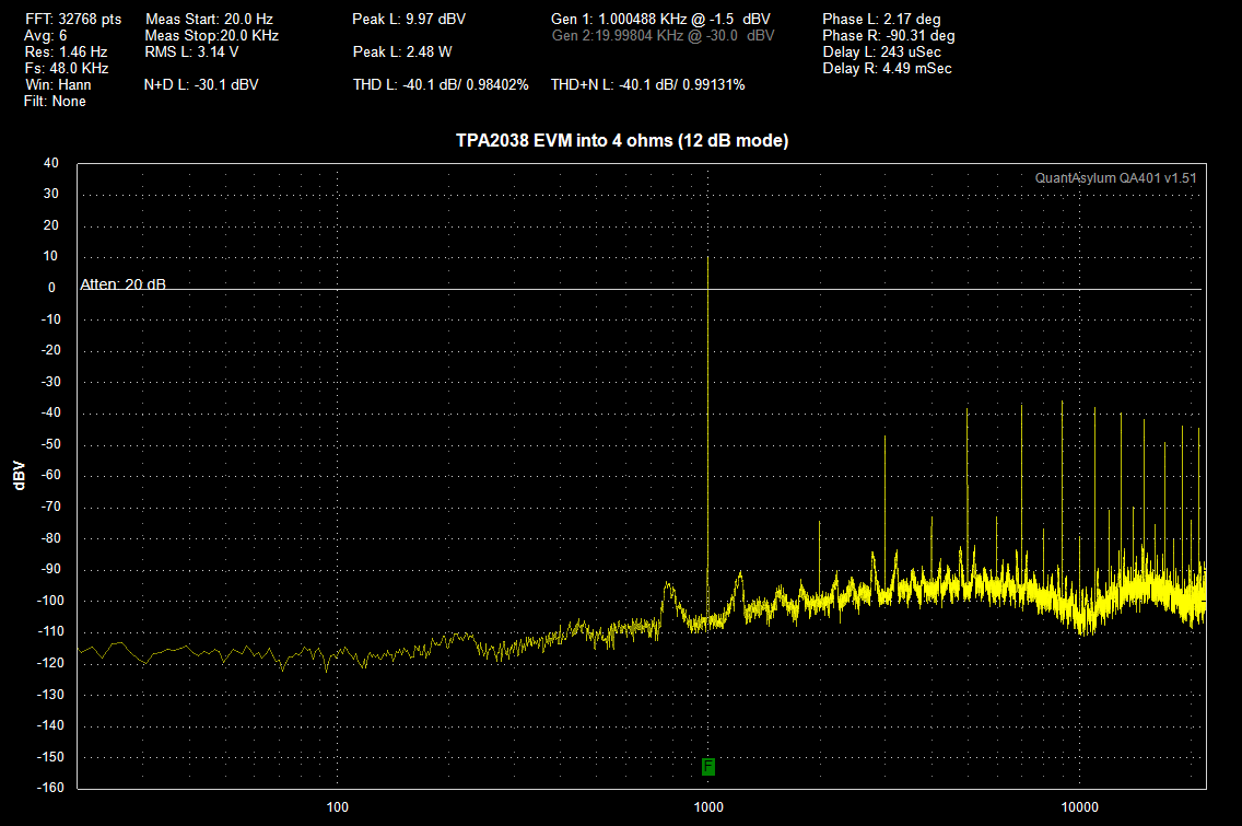

If you put the output of these amps directly into an analyzer, the slew rates cause big problems. But it's easy to fix: just run the amp output through the TI-recommended first-order 30 KHz RC filter posted earlier in the thread. That it! That filter smears the fast edges of the switching signal just enough so that the CMRR of the analyzer can take care of the rest.
Here's a capture of a TI TPA2038 filterless class D. It's rated for 1% at 2.5W into 4 ohms from 5V, and the measurement confirms that. This was using TI's prescribed first order RC filter.

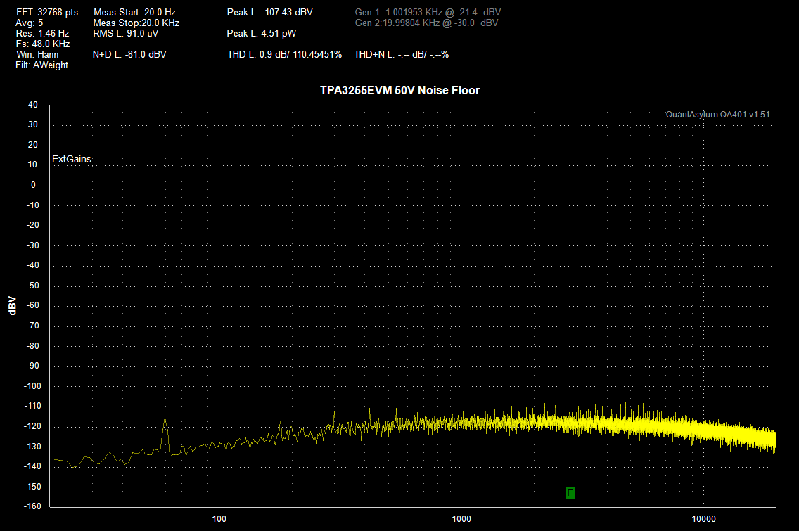

Here's a TI 300W class amp (no input) running at 50V rails straight in with no filters. 91 uV of noise A weighted, 20 to 20 KHz. TI typical spec is 85uV.
Yes, I think AUX-0025 is fair for measuring THD. TI specs their THD measurements with 80 to 80 KHz bandwidth specified on the analyzer BUT with an AUX-0025 and an AES17. So, effectively a brick-wall beyond 20 KHz.

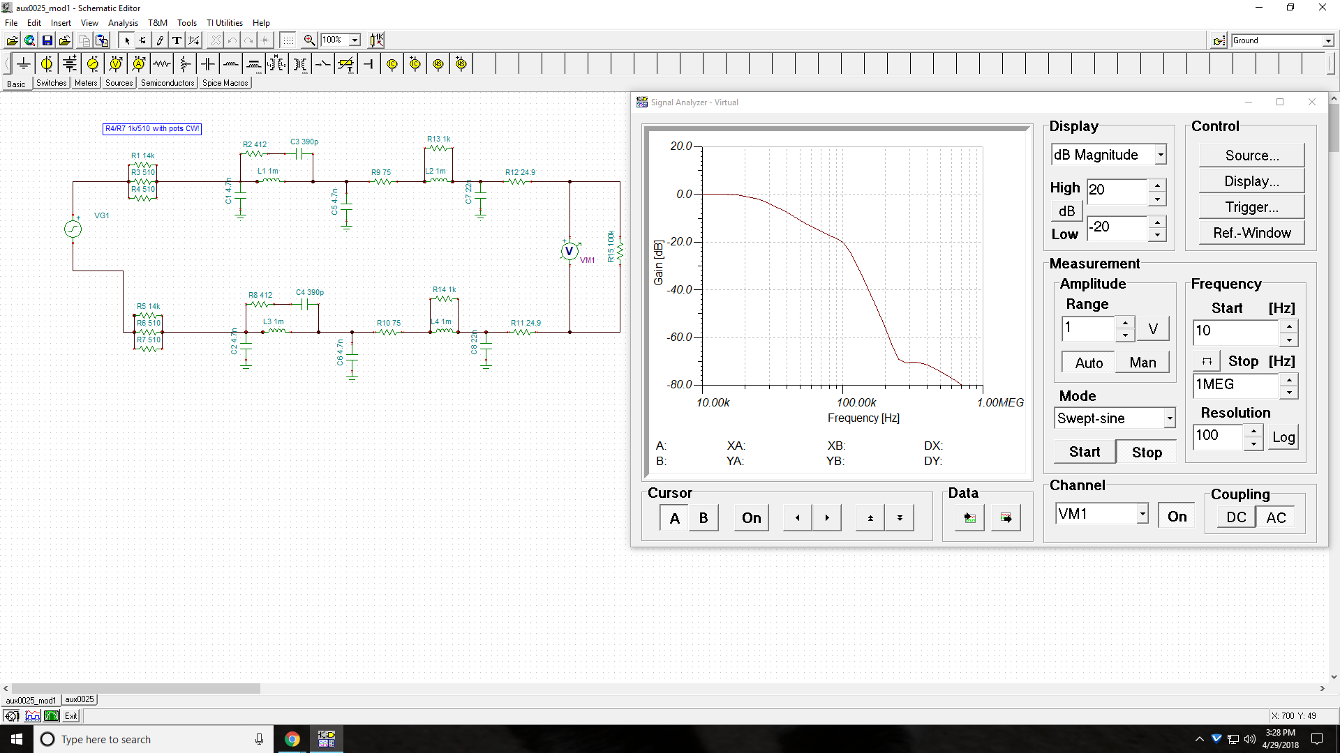

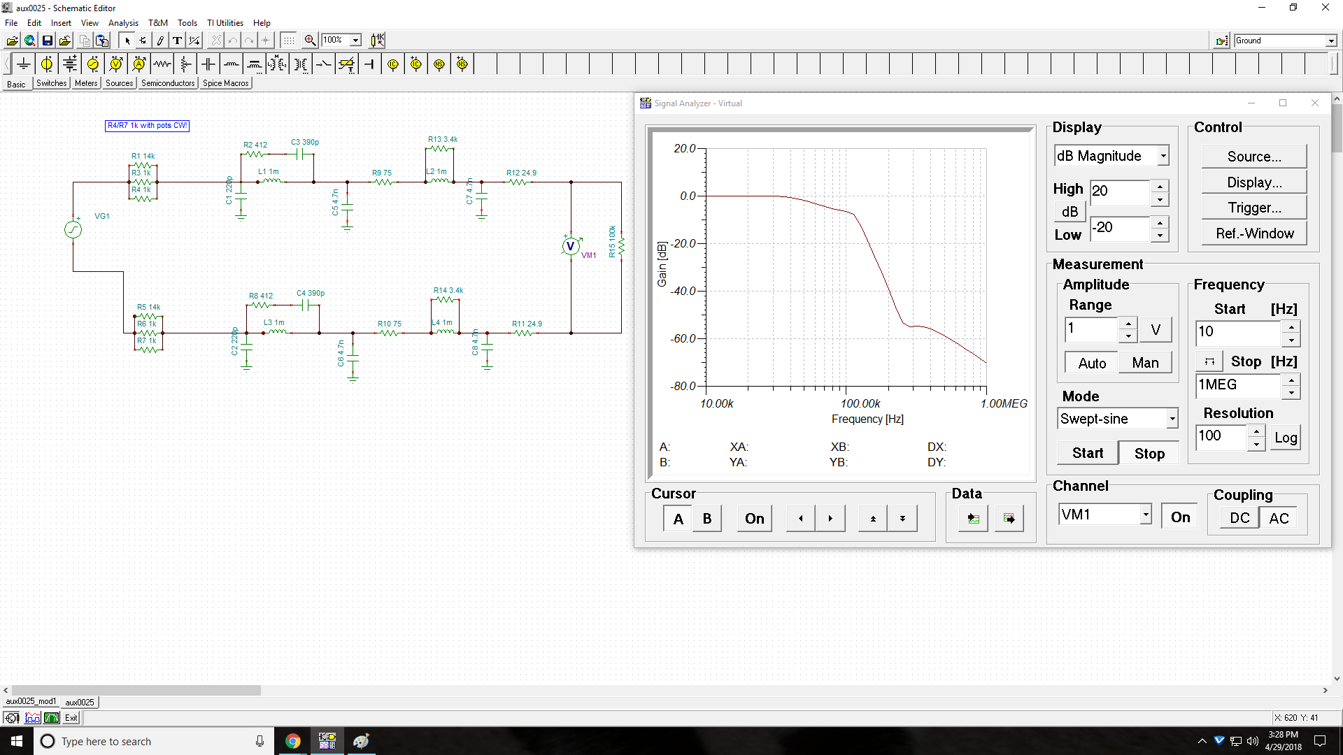

Still picking up some major hash in 50k region with some class D amplifiers at test. Think I'm going to rework my filter to below. First pic is the aux_0025 setup, 2nd is what I'm thinking.
Took a lot of guess and check (as i'm no filter expert lol), good chance i'm overlooking something like over-loading one of my newer low-value resistor choices. Guess we'll see 🙂
Down a bit more than half db at 20k.. not too concerned with that, tried to get the best roll-off i could from 20k-100k without a total gut job.

Hi bnae38
The AUX0025 filter is used to stop the MEASURING ANALYZER from overload/slewing/creating distortion products. The AP’s have a 500 KHz plus analog BW and some HF noise or carrier could cause some form of IMD. The output filter on the Class D amp or design is needed to reduce the carrier output.
The speaker cable is an antenna that radiates the carrier to the world.
Modifying the filter does not make the amplifier any better.
Duke.🙂

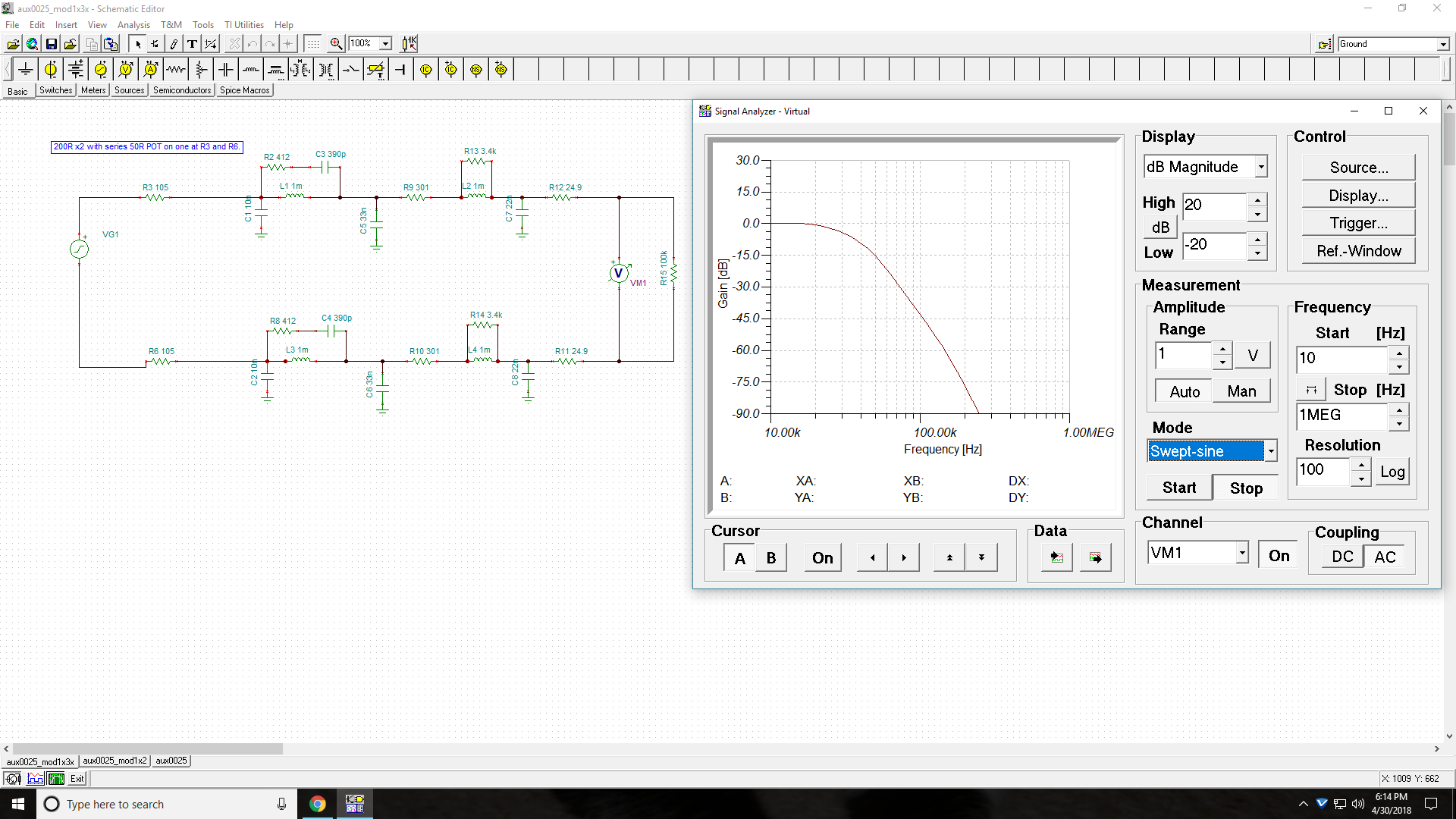

Anyway, my train of thought could be off base here.. but thinking i'm going to go for this. Is a more stout filter after 20k. May just fubar my phase response too i suppose, but think it's worth a shot.
I think a harder slope is more practical for measuring class D, no? ....Like most things, everything is a compromise.. So i could be missing a major issue here.
Response crosses -100 at about 600k (which will probably never actually happen..). Graphing goes wonky if i try to zoom out a touch more, it zooms way out. Response is down about .75db at 20k, peaked at about .35db at about 13k.

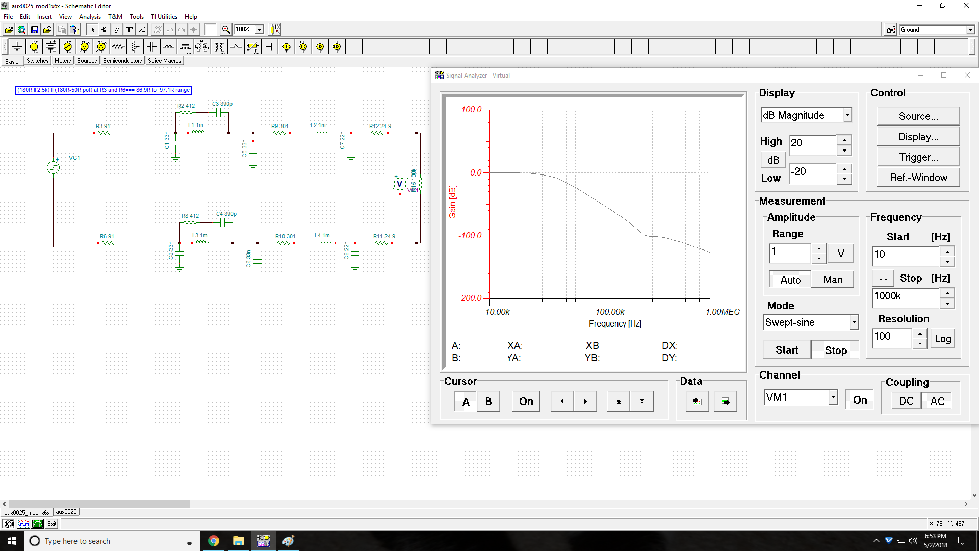

One more rev, 92R (not 91) in front to 33N.
Within .25db all the way to 20k and a bit more rolloff 🙂. Not quite as good as the original in flatness, but damn close.
