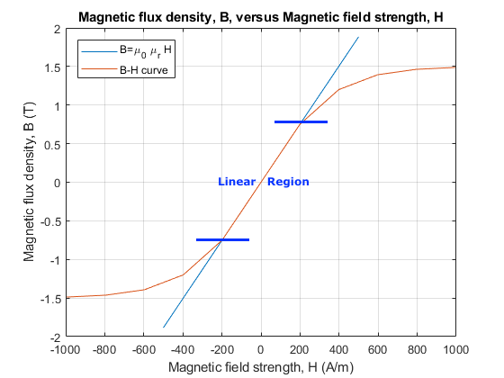

Inductors with ferrous cores have a linear current handling range determined by the magnetic permeability of that core. If the current exceeds that range, the inductance will vary in a non-linear fashion called saturation as conceptually shown here:
![Inductor.png Inductor.png](https://www.diyaudio.com/community/data/attachments/596/596119-853c74fb45efa3ae2e6f368d7dd11759.jpg)
Air core inductors don't saturate, they can get hot and increase their resistance a bit before they melt, but that's about it. When dealing with high level currents that power amplifiers are capable of, only air core inductors can maintain their linearity. At lower levels a properly spec'd ferrous core inductor can remain linear as well.
