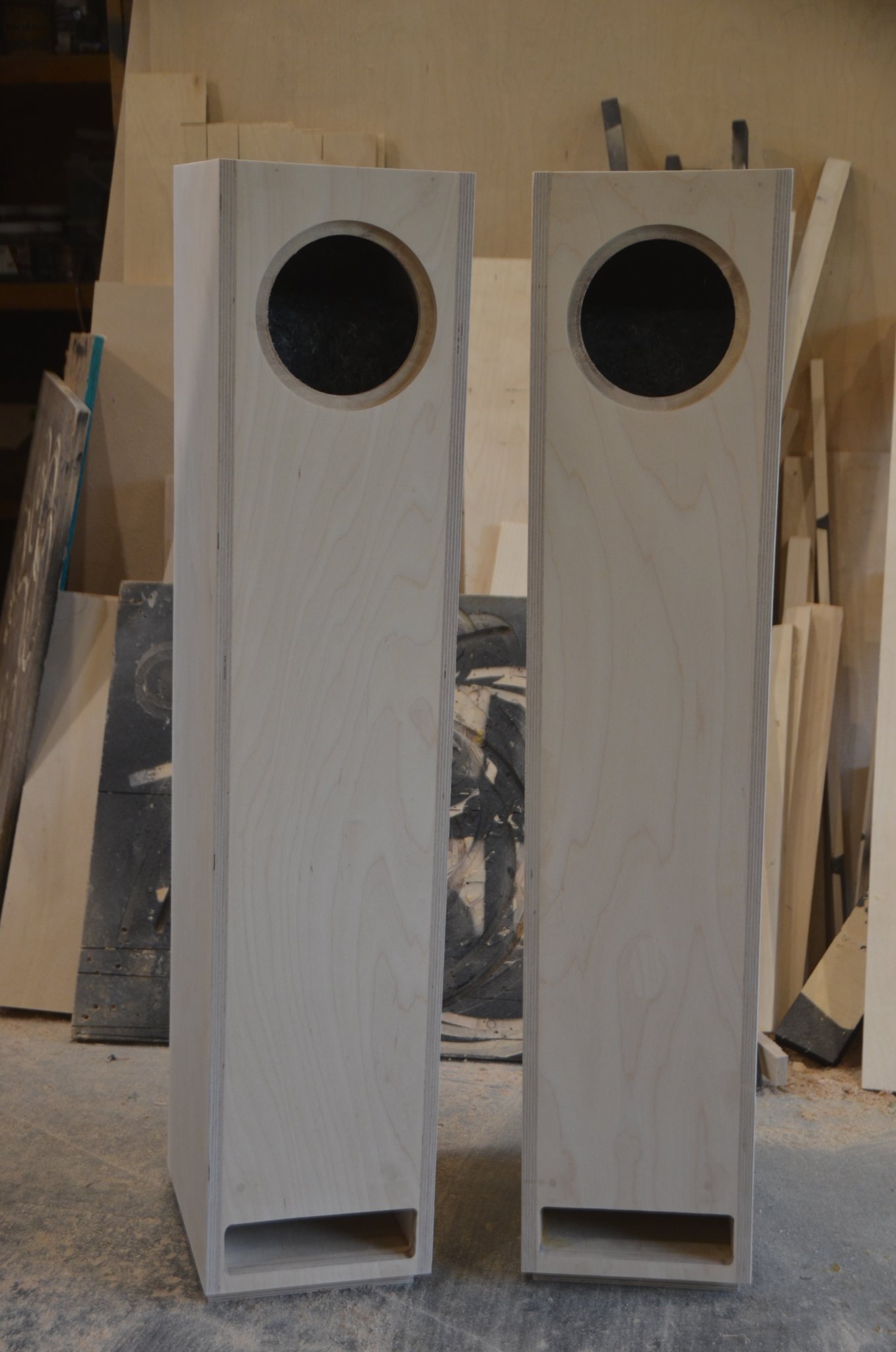

Well, I just got the news that the cabinets are done and going to pick them up after the July 4th holiday week is over. Toronto is about a 4.5 hour drive each way from my home, but I can’t wait to see them in person.
in the meantime the builder sent a picture of the completed cabinets to hold me over until I can get them home.
After that, they are off to my refinisher in Grand Rapids and hopefully come back home with a beautiful gloss black piano finish. Hopefully, the plans that were published will do them justice to the real ones!,

I am just curious about the opinion of the guys in this forum that are following this project. I guess my first question and using a little imagination, how do you think these cabinets compare to the real ones?
Without seeing them in person and providing the build plans to my speaker cabinet maker, who does this for a living, I noticed two things immediately.
First, the bottom section of both cabinet bases should be doubled according to the plans and the originals. I dont think it will make any appreciable sonic differences, but then you never know?
The second thing that I noticed is that he rounded the corners of the vent / port on the bottom of the cabinets. the originals look flared out to me? Whether on not it makes any appreciable sonic differences is subjective and it may not make any difference?
I may be a little nit-picky or maybe even a little OCD, but I am thinking that a lot of research and trial and error, went into the original design and then fine tuned acoustically be an experienced audio engineer / musician.
So, there is an old saying that the “devil is in the details“ and I want to make sure that I captured what the original designer had in mind, or am I being overly cautious?…
Your thoughts, anyone?…

About your “ second thing “: it looks angled or flared out because they use mitre joints every where (sides, front, back, top and bottom). I hope it helps.I am just curious about the opinion of the guys in this forum that are following this project. I guess my first question and using a little imagination, how do you think these cabinets compare to the real ones?

I wonder if a judicious handful or two of stuffing here and/or there might get you to where you want to be.
certainly Scott and Dave represent that their enclosures are designed to within an inch of their lives... but then indicated that moving the driver out 3/4" to accomodate a thicker baffle.
maybe rely on your driver choice first and foremost?
