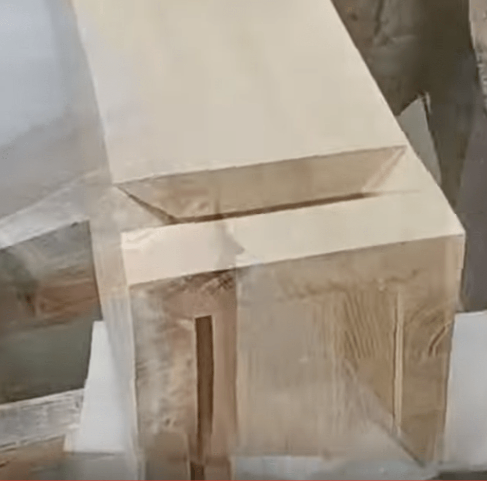

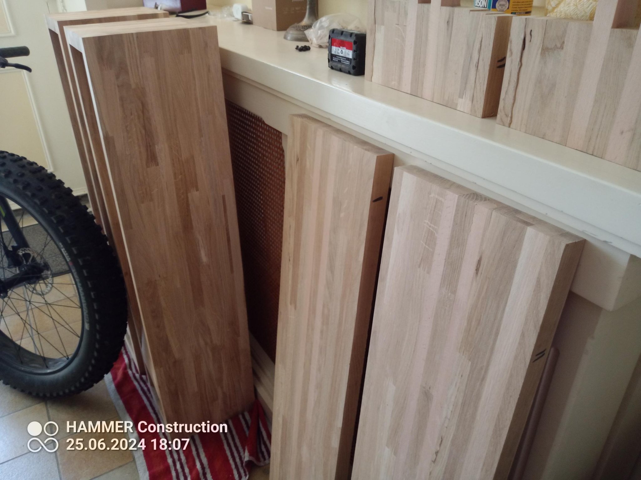

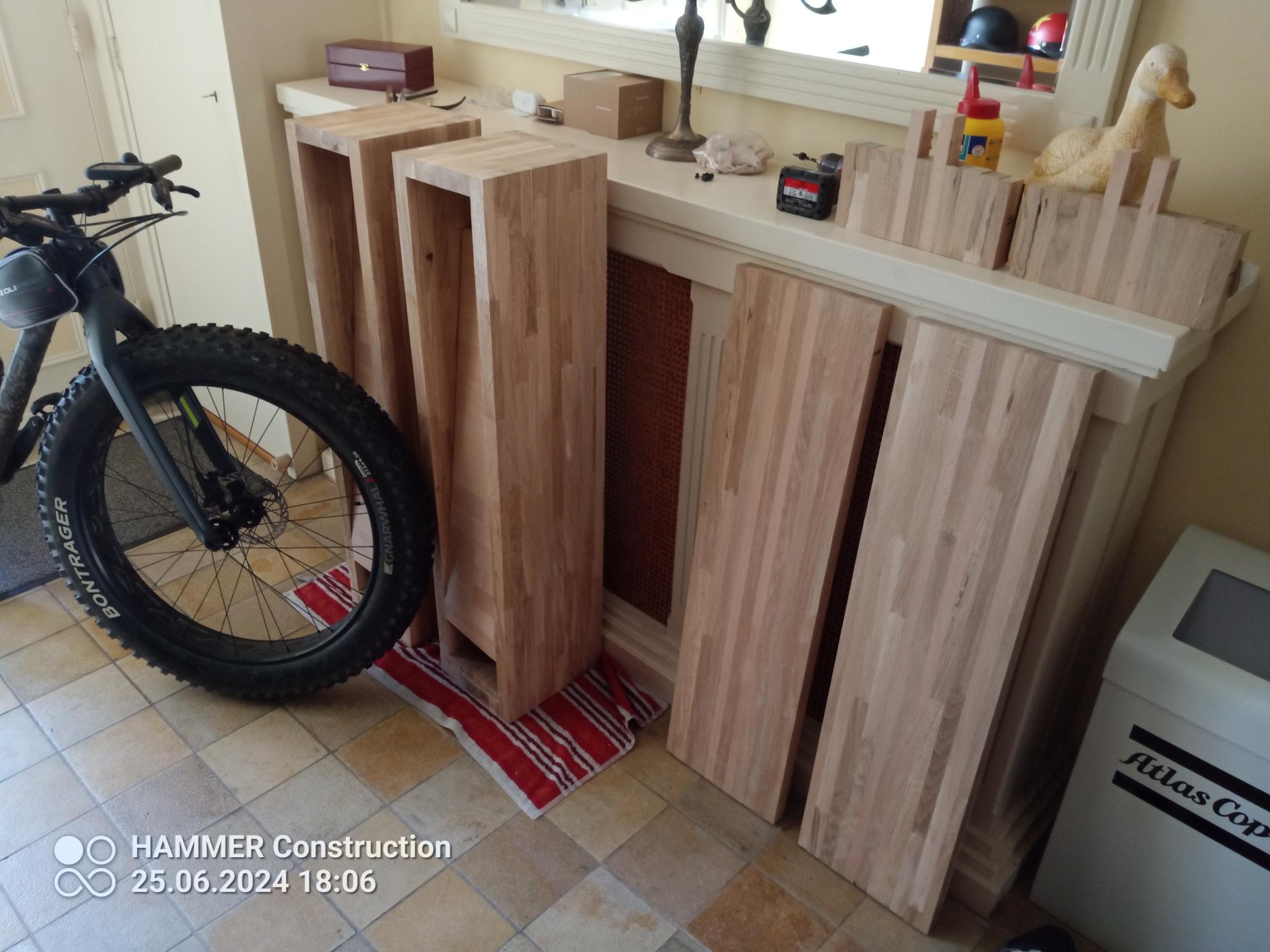

Well, when you buy pair of drivers from MA, not Maop, they are not really matched. We know that Sibelius drivers are not stock Alpair, but they are not become 8" Fostex after tweaks. Still, noone simulated stock Alpair in this enclosure so this is guess and hope for the best project. I will make it, but first from old closet particle board, then some measuring and if I like it ill invest in proper material

Nice build!I saw this last night on you tube and for those who want a video on how to build a Sibelius cabinet, here is what it will take:
