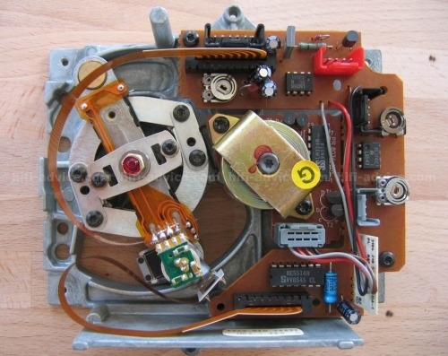

I just checked the SM of CDM-1, I believe the CDM-0 is similar. There is a 4x op.amp NE5514 that amplifies the current of the 4 detector diodes. Its output pins 7, 8, 1, 14 are at 0V when there is focus and the laser is on track. I would monitor these outputs during playing. Their output is matrixed, forming two signals for the radial servo. That is a bit complicated, but there should be a DC offset adj. TP and a radial offset trimmer to adjust 0V on the TP during play.
That's another of those fixes that can be open to debate... if resoldering had 'fixed it' would that because of an unseen dry or the would it be because the heat somehow temporarily 'fixed' an issue with the diode array.No result in my case. But we're clutching straws, aren't we?
ok interesting. we have 3 TPs (trimpots?) on my motor board (pic). so which screws to turn eventually... if needed to get back to 0V?
I'd need some more guidance on this.
Laser power we know. More current = more RF. So that should not need altering at all.
Focus gain as far as I recall won't alter the DC conditions but if it is low the player will be prone to jumping in response to physical shock and vibration and if it is high the focus coil in the RAFOC can be noisy and hissy as it gets fed a lot of high frequency content as well as the basic lower frequency focus voltage.
Focus offset... having looked at the typical nightmare of all the Philips versions and methods I'm going to say adjust for best quality of RF. Sometimes the meaning of what they say doesn't always tally with what you expect and so if by chance adjustment of this pot does not alter the RF quality then I would set it empirically for best playability i.e. see where things go wrong in one direction and where they go wrong in the other and set it in the middle.
I like Philips stuff but a lot of the procedures are very convoluted.
Hm, none of these trimpots are for radial adjustment. Please check the SM from here, especially page 23:
Philips CD-204 Service Manual
It seems there is no trimpot for the radial adjustment, unlike in CD-74/84* that I am more familiar with. Try the usual "heating test": is there any component overheating? If there is anything suspect, try a freeze spray. Also try carefully heating the ICs (6211 ... 6218).
BTW the check method is described on page 32 (G and H). Perhaps worth going through it.
