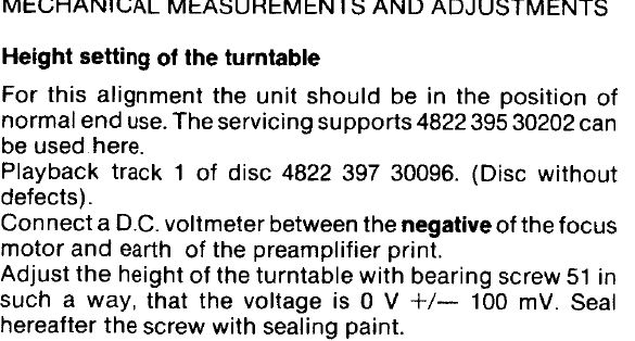

Something I could use clarity with respect to is how to go about adjusting the height of the spindle motor. Am I correctly interpreting the attached section from the CDM1 service guide to mean that I want to adjust for 0V, or as close to that as possible, while playing a good quality disc (in lieu of the actual Philips test disc)? I ask because I read somewhere else that the goal is to adjust so that the voltage at the test points is the same when the unit is in Stop and Play, which very likely won't be 0V.

If the skipping occurs at >60 min, it is at the outer edge of the disc. Perhaps the swing arm that holds the laser is not perfectly parallel with the CD. The distance between the lens and the disc varies as the arm moves outward. It is difficult to adjust the parallelism, but you can try to set an average. The deviation of the offset voltage from 0 V (set by the Torx screw) should be equal at an inner track and at an outer track. One will be +, the other -.
Interesting, this is now a third method for adjusting the spindle height. I can try that.
