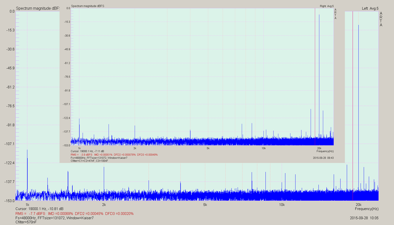

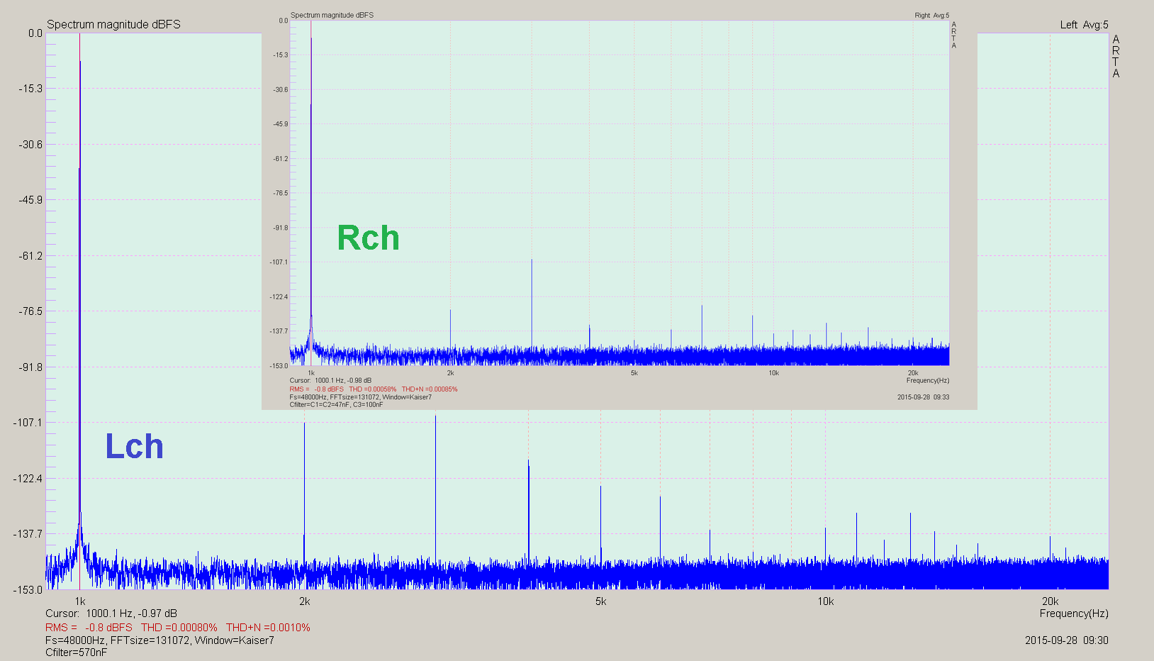

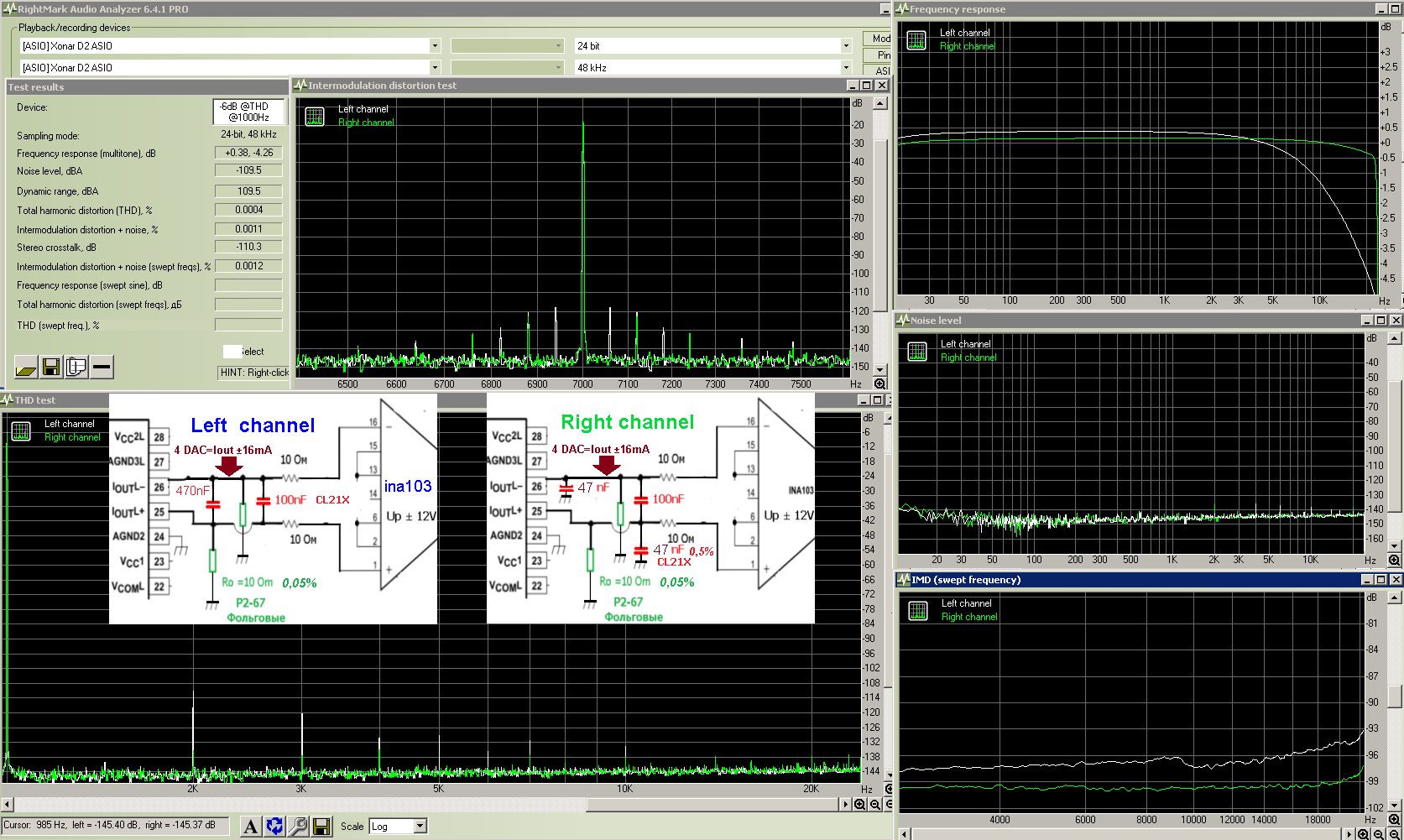

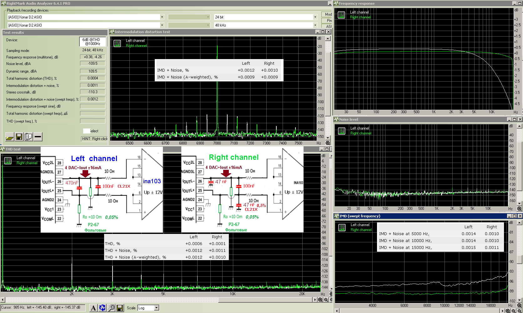

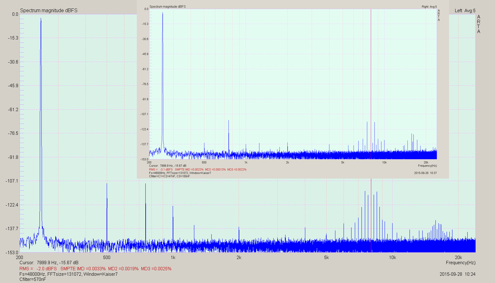

ARTA
Cfilter = 570nF @ Left channel
Cfilter=C1=C2=47nF, C3=100nF @ Right channel
Cfilter=C1,C2=47nF, C3=100nF @ Right channel
I was thinking to the same measurement approach: one stereo channel normal setup, while the another one modified. You already did it. Interesting results so far. Quite predictable the altering of the frequency response. This is a obvious direct consequence of applying this filter.
I intend to measure this way on my system, when the circumstances it will allow me.
There is so an accepted way to do it? Comments?
