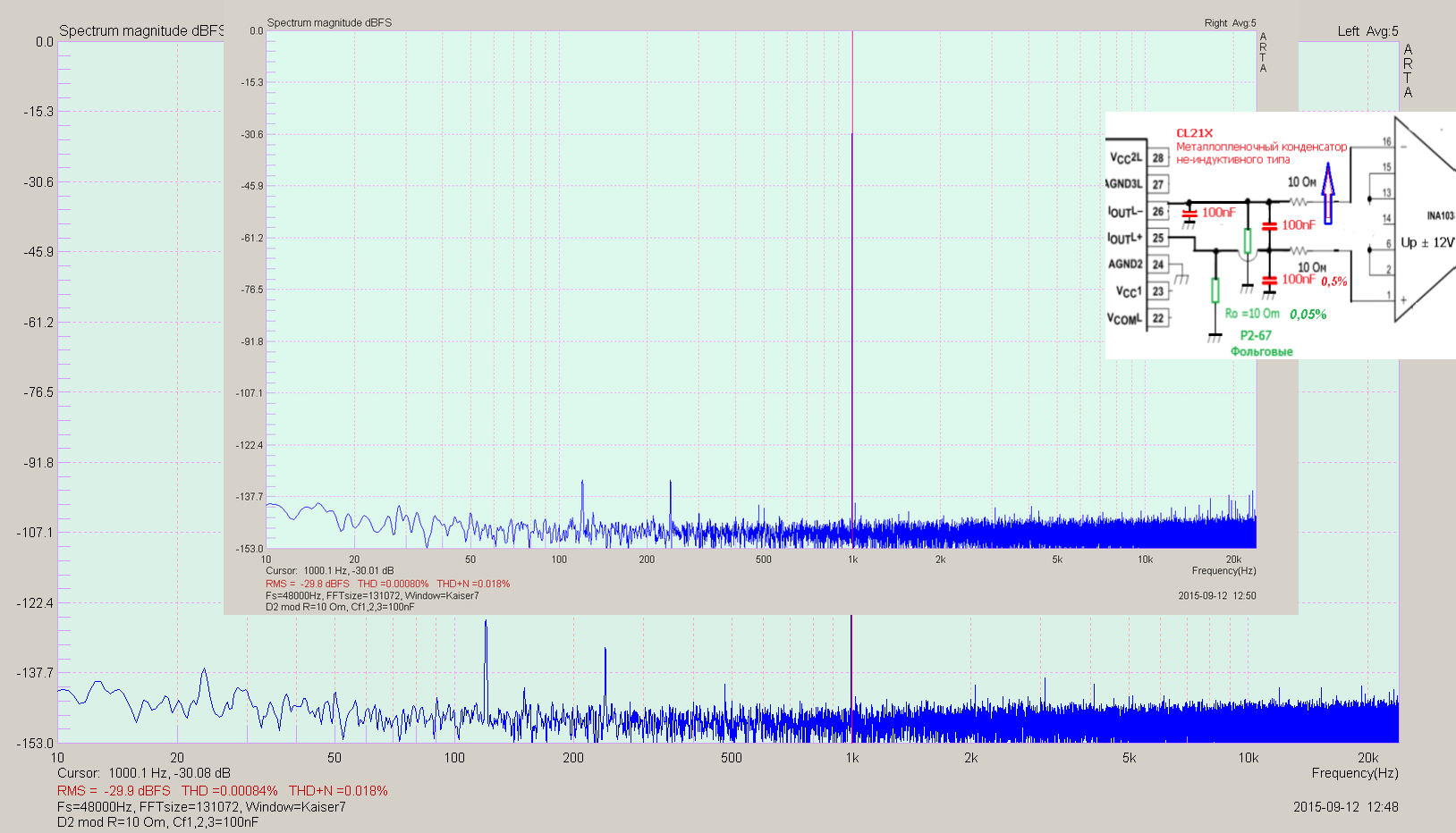

It this old DIY design i used I/U that forms 2nd order Bessel LPF(60kHz -3db) with current input, actual values of C78, C79, C84, C86, C87, R46, R49 i don't remember.

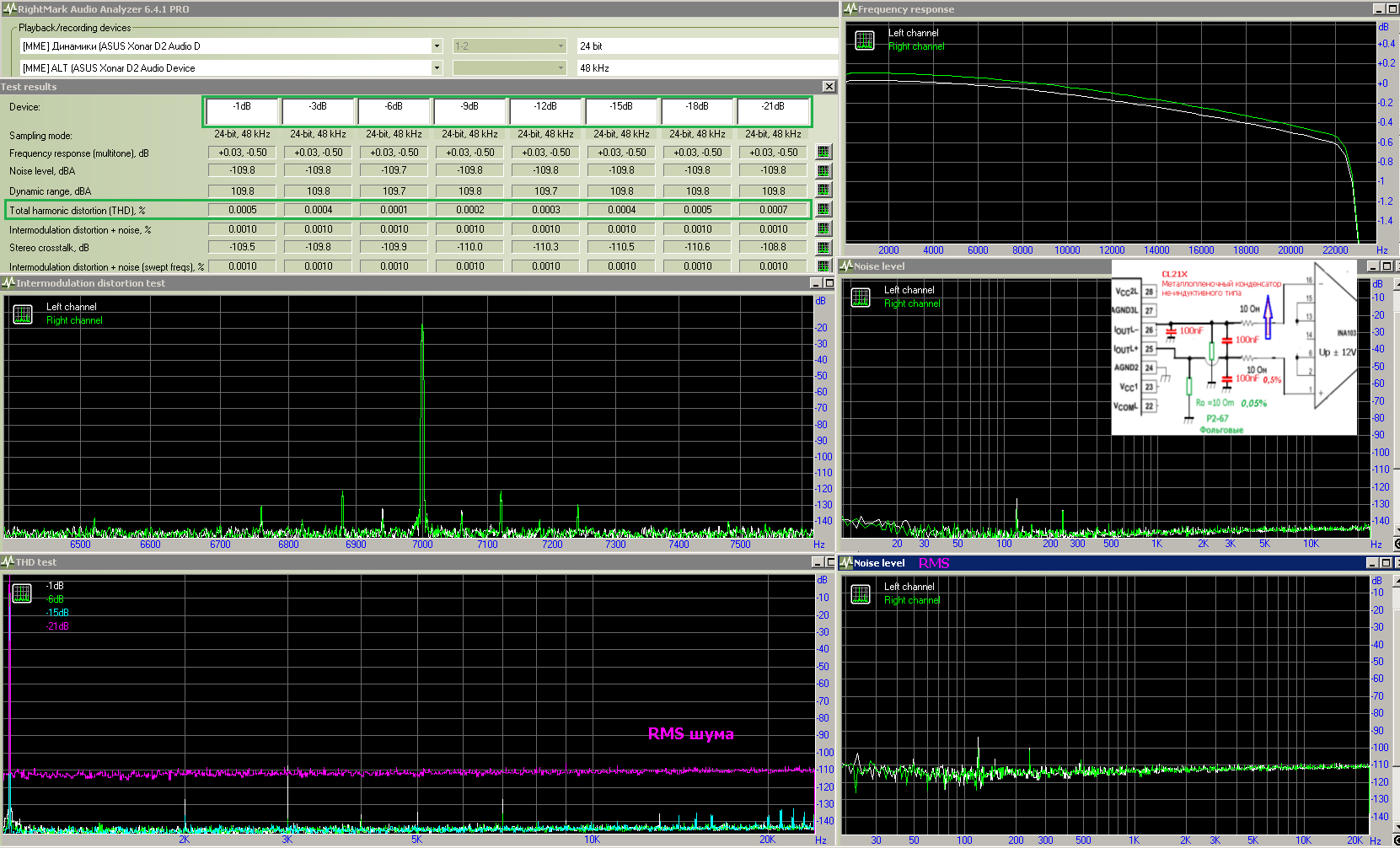

Re oscilloscope, look at Post #6, adjust RC Zobel to give that result, shown in the three screen shots.
Needs a bit of trial and error, but keep in mind C largely controls 10KHz and R 20KHz. Read the text in Post #3.

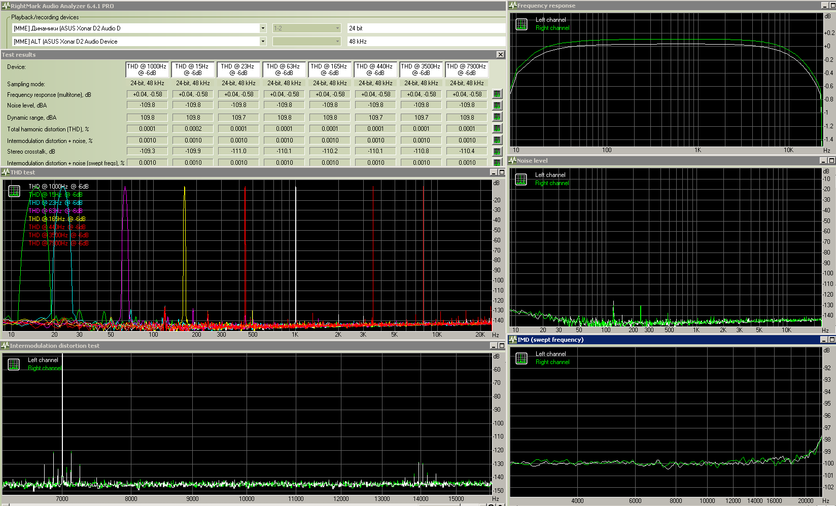

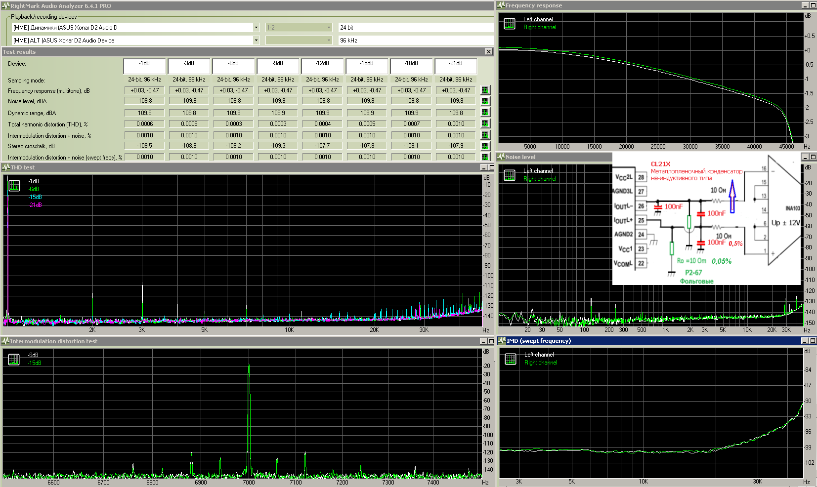

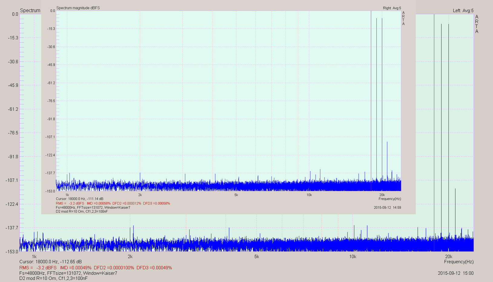

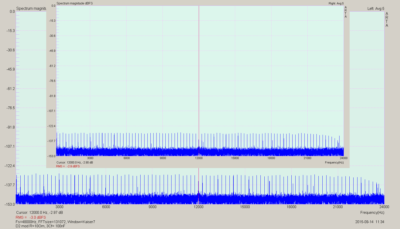

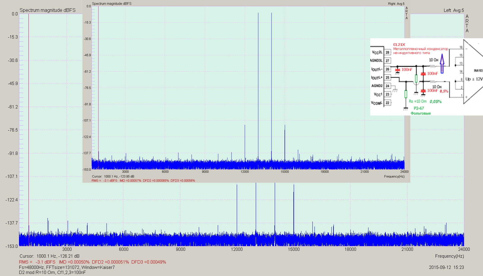

This is my definite favourite : 4 DAC(Iout=16mA p-p) PCM1796 @ R=10 Om + ina103kp:Круто:
nice surprise: ура:
![RMAA @48kHz @ 20 Om @ 3Cf_100nF.png RMAA @48kHz @ 20 Om @ 3Cf_100nF.png](https://www.diyaudio.com/community/data/attachments/469/469607-859664a46edeba1ae518ba157eddb785.jpg)
nice surprise: ура:
I use a ESS9018 K2M dac with tipical datasheet output. What components and values i should use in order to gain this effect discussed here ?
My DAC has more sources than PCM179x described in the first page (2xdigital and 3xanalog), should install supercapacitors to all of them ? Now are decoupled with 1uf||0,1uf ceramic caps.
Thanks!
Thanks!
My suggestion is to use large capacities for all power rails decoupling in analogue processing stages.
Another suggestion is to have a reference for the I/V stage a more stable zero/GND, instead that divider powered from AVCC.
Else please examine the suggestions in the beginning of the thread, to find that configuration may fit for you. Mainly the cap should be placed in between DAC`s outputs (here L+/L-).
