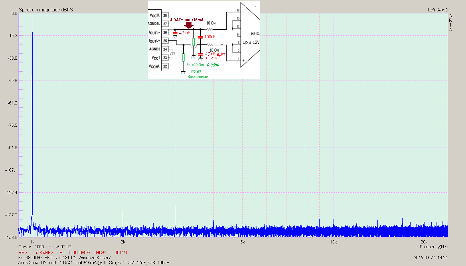

This is my definite favourite : 4 DAC(Iout=16mA p-p) PCM1796 @ R=10 Om + ina103kp:Круто:
nice surprise: ура:
Thank you Vovi. What is your test setup / ADC / soundcard etc?

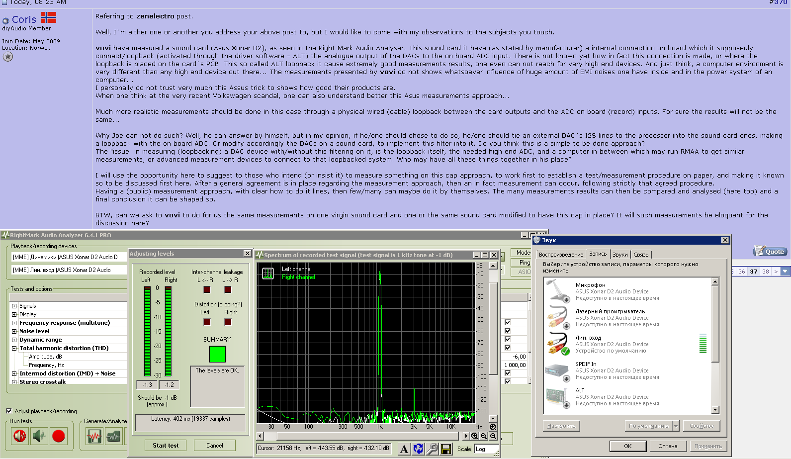

Referring to zenelectro post.
Well, I`m either one or another you address your above post to, but I would like to come with my observations to the subjects you touch.
vovi have measured a sound card (Asus Xonar D2), as seen in the Right Mark Audio Analyser. This sound card it have (as stated by manufacturer) a internal connection on board which it supposedly connect/loopback (activated through the driver software - ALT) the analogue output of the DACs to the on board ADC input. There is not known yet how in fact this connection is made, or where the loopback is placed on the card`s PCB. This so called ALT loopback it cause extremely good measurements results, one even can not reach for very high end devices. And just think, a computer environment is very different than any high end device out there... The measurements presented by vovi do not shows whatsoever influence of huge amount of EMI noises one have inside and in the power system of an computer...
I personally do not trust very much this Assus trick to shows how good their products are.
When one think at the very recent Volkswagen scandal, one can also understand better this Asus measurements approach...
Much more realistic measurements should be done in this case through a physical wired (cable) loopback between the card outputs and the ADC on board (record) inputs. For sure the results will not be the same...
Why Joe can not do such? Well, he can answer by himself, but in my opinion, if he/one should chose to do so, he/one should tie an external DAC`s I2S lines to the processor into the sound card ones, making a loopback with the on board ADC. Or modify accordingly the DACs on a sound card, to implement this filter into it. Do you think this is a simple to be done approach?
The "issue" in measuring (loopbacking) a DAC device with/without this filtering on it, is the loopback itself, the needed high end ADC, and a computer in between which may run RMAA to get similar measurements, or advanced measurement devices to connect to that loopbacked system. Who may have all these things together in his place?
I will use the opportunity here to suggest to those who intend (or insist it) to measure something on this cap approach, to work first to establish a test/measurement procedure on paper, and making it known so to be discussed first here. After a general agreement is in place regarding the measurement approach, then an in fact measurement can occur, following strictly that agreed procedure.
Having a (public) measurement approach, with clear how to do it lines, then few/many can maybe do it by themselves. The many measurements results can then be compared and analysed (here too) and a final conclusion it can be shaped so.
BTW, can we ask to vovi to do for us the same measurements on one virgin sound card and one or the same sound card modified to have this cap in place? It will such measurements be eloquent for the discussion here?

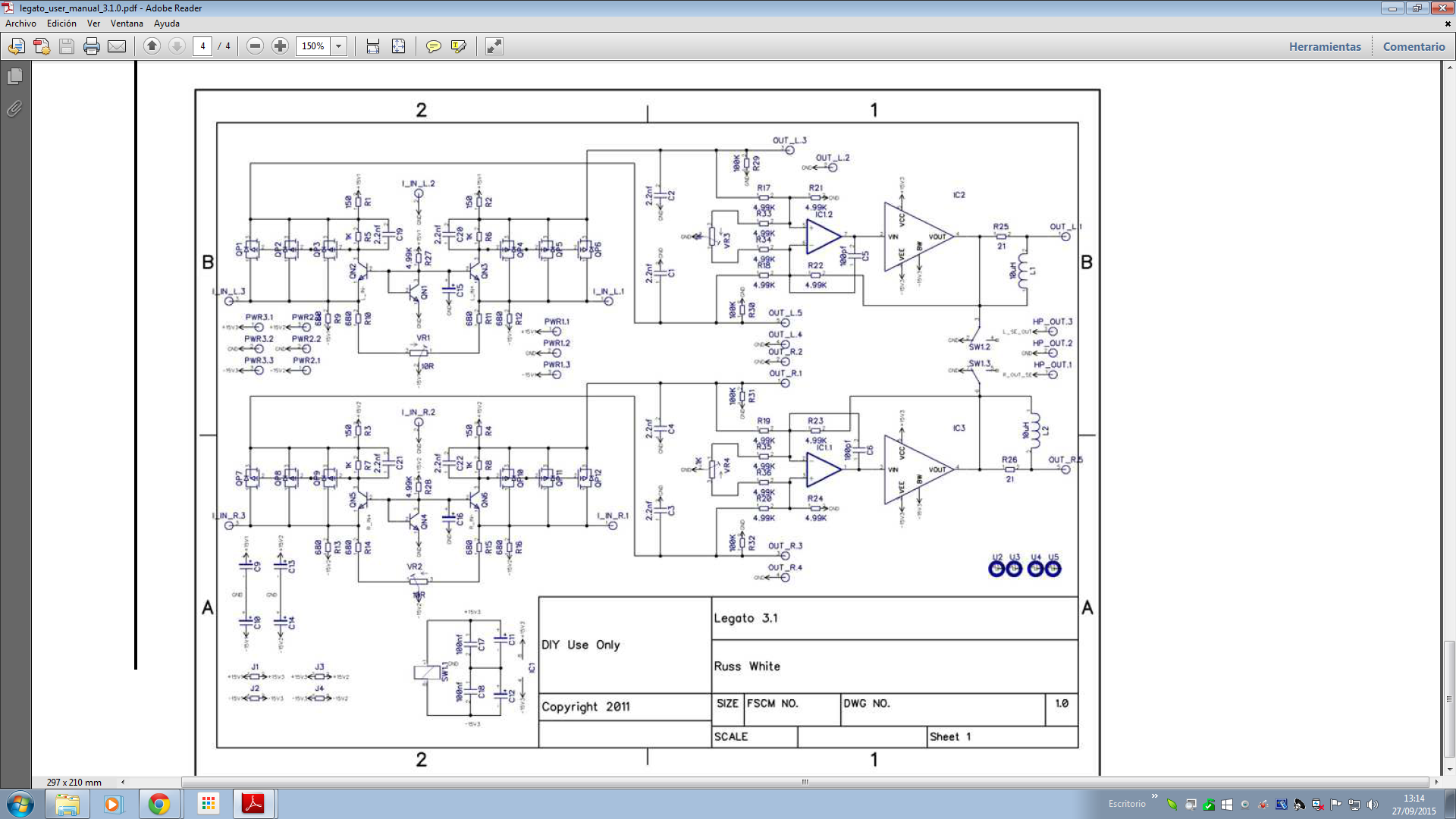

Joe what will the mod for TP Legato
Bit hard to tell, the resolution is poor, but I assume that the two pairs of inputs are approximating a virtual ground? If so, cut the track from the DAC and insert 3R3 on both phases, then on the DAC side of 2 x 3R3, wire a 1uF film cap across that, on the DAC I repeat. If it is not virtual ground, then need to know what it is - but again I think it looks like virtual ground?
Does anybody have a clearer version of this Legato 3.1 diagram by Russ White (Buffalo)?

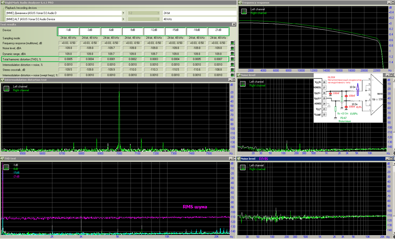

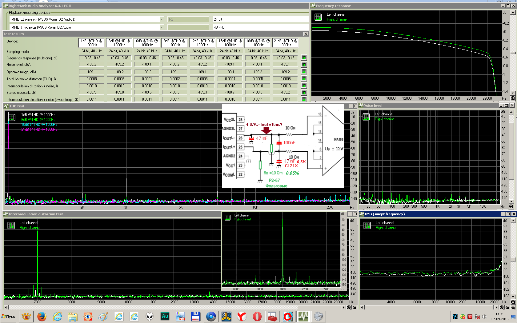

YES! I have measured a sound card Asus Xonar D2 mod 4 DAC=Iout ±16mA @ 10 Om, new Cf1=Cf2=47nF, Cf3=100nF.
External loopback (line-out - line-in): ура:
