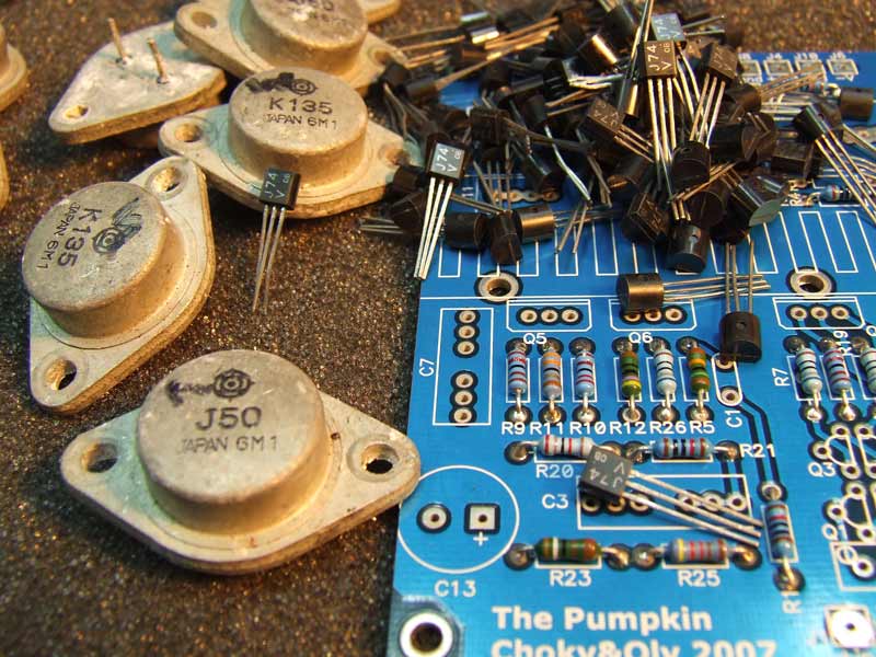

On a totally different note, I have some of the unobtainable Toshiba 2SK369V's, so I have you all racing me and you will never get even near.................he-he-he The 2SK369V's are the finest regarded Toshiba's everHe-he, just had to say it!

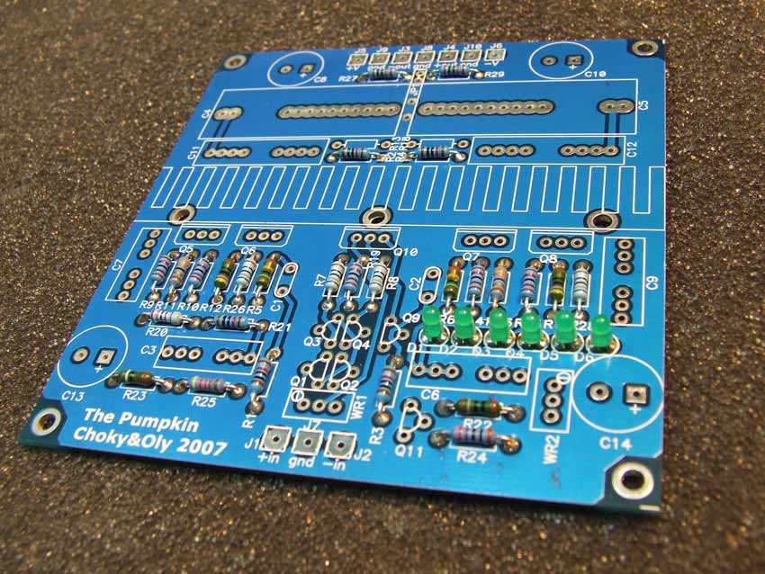

mpmarino said:You guyz are a bunch of show offs, with all your fancy dance fets and all.![]()
Edit:
And just so ya know, R5 is in backwards.![]()

can greedy people get just main boards, without fancy dance pants reg?
ya mean - without pcbs for this beauty :

> On a totally different note, I have some of the unobtainable Toshiba 2SK369V's, so I have you all racing me and you will never get even near.................he-he-he The 2SK369V's are the finest regarded Toshiba's ever He-he, just had to say it!
Steen,
I make it a habbit of not posting anything just to p*** people off, but I could not resist replying to this .....
I have 100 pcs each of 2SK369Vs & BLs sitting in my stock for at least half a year, at 40 cents each. See who is racing who !!!

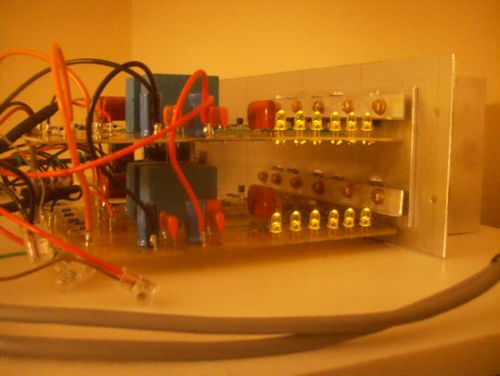

I am not in doubt any more, this pre. is really giving 'punch' to my setup. Difficult to explain, but in partnership with my F4's the Bass is 100% controlled, which i never heard before on my spk's ! all thing's which 'used' to sound a bit irritating is suddently become alive.
I am not the owner of the best listning ear's but what i hear doe's not cheat me nor does the music
... Pumpkin rules ----> BUT, i hate to admit, but i have an issue.
After 1hour warm up, the thing is approx. 5 degrees above ambient temperature (not enough i know), it's very difficult to adjust 100%, The DC-offset between GND and +/- out (before cap's) are not completly stable.. swings a bit up and down, the same ofcause with DC-offset between + and - out. After output cap's the voltage is rather low, within 1 - 20-30mV. so i guess this is acceptable but i don't know for sure.
What do you think ZenMod ?, is it due to my heatsink's to big for now, or is there another issue for this instable condtion ? Or should i just try decrease my sink's to half size ? -- Thank's anyway ZenMod, really great work you have done here . really...

you seems haven't any issue , from multiple reasons ..........
first - just for record - you must measure any steady condition (as Iq and offset are) without any signal,and with pot on zero .
second- you can't have any DC offset after output caps ,just because that's impossible ... at least if you made F4 right from the book,with 1K in series with input ,and 47K to gnd .
third - this type of circuit is , as any other , result of compromises and decisions in construction..... I decide with clear mind (if that sentence is ever applicable to me) that I don't want just another UGS ,or (God forbid!) BT based circuit ; inherent symetric (both up-down and left-right ) structure of both mentioned circts results in somewhat more predictable and easier to maintain DC behavior than
![pumpkin :Pumpkin: :Pumpkin:](https://files.diyaudio.com/forums/images/smilies/pumpkin.gif)
that both from initial power up state and later , during warm up and also later-= when temperature equilibrium is reached .
one also ( often neglected) important issue in making Papalike (simple) gadgets is - necessity to preserve steady temperature and air circulation conditions ; that's -at least for me - visible in all his Serv. Manuals ,starting form Treshold era ........ you can almost read between the lines : "do not breath,poor bstrd!!" .........
so - you can't laugh in front of
even not sneeze , or cry or dance with your better half ...
nothing of that if distance between you and your new toy isn't more than 20" ......... and expect that poor critters have same temperature-read current-read voltage- all the time .
make a case , put lid on , power it up,let them critters cook for a while and then pull lid off and wiggle with WRs.........
put lid on, wait a cigarette time,then remeasure ........... just then you can expect that offset values can be steady ........... I repeat - with case .
