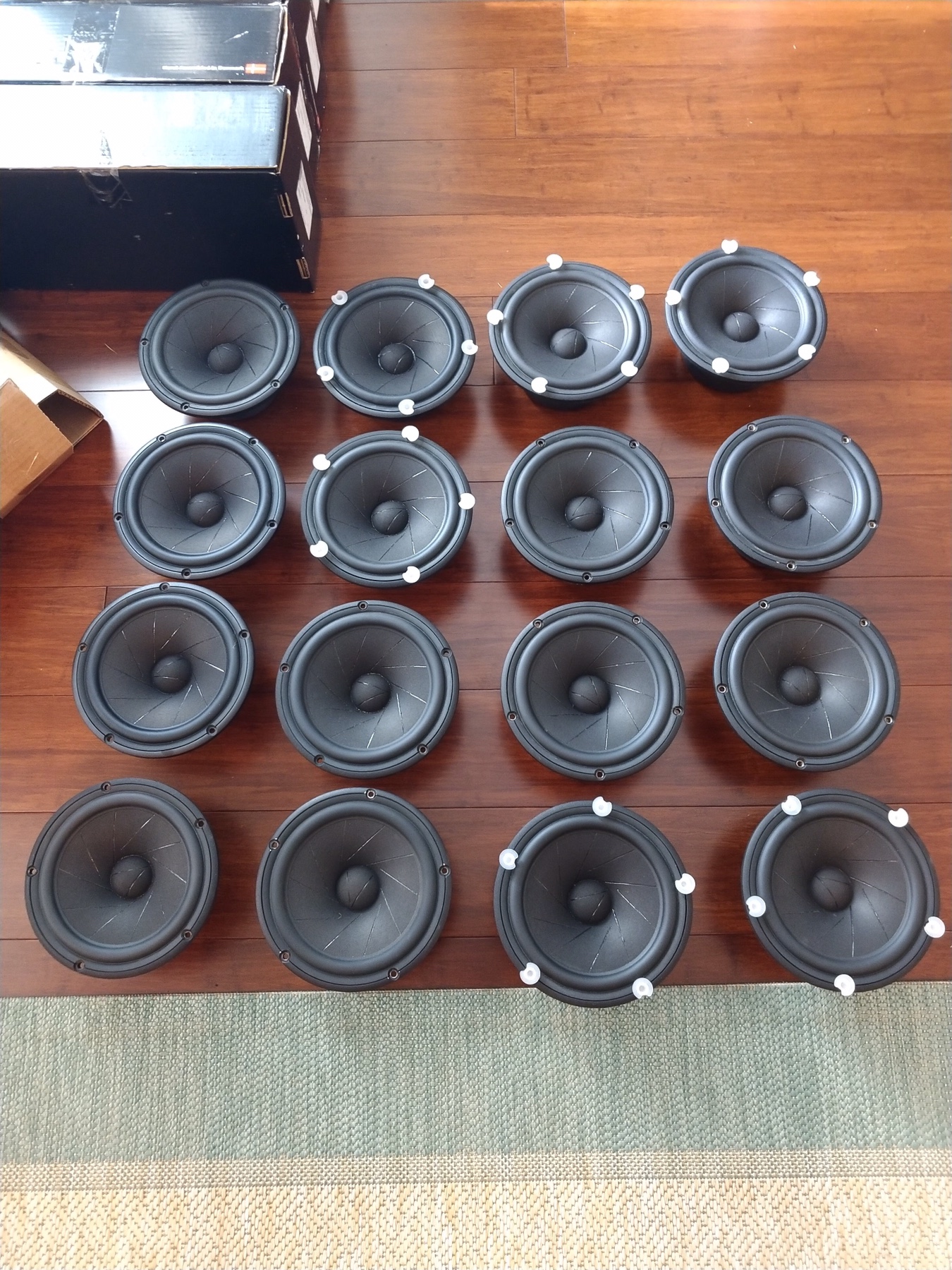

This is what I had to do to get low distortion out of a 6.5”...

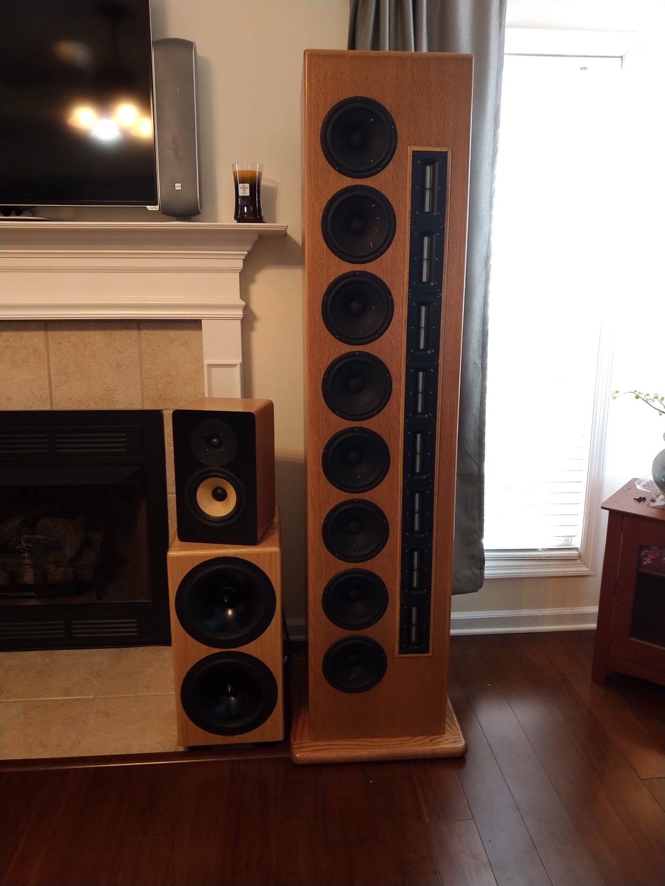

Now if I could only afford 6 channels of Purifi 1ET400A!!! Yes I would like a pair for the servo controlled woofers also... [emoji6]. The ones in the picture are servo controlled but they are not the reference woofers for these line arrays.
