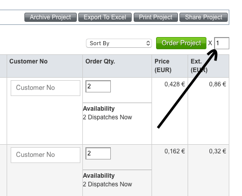

Yes, you need to multiple the order with the number of boards. On mouser page see top right corner. For 12+1 multichannel you need 13. :cool:
For other documents check your mail.
Tibi
