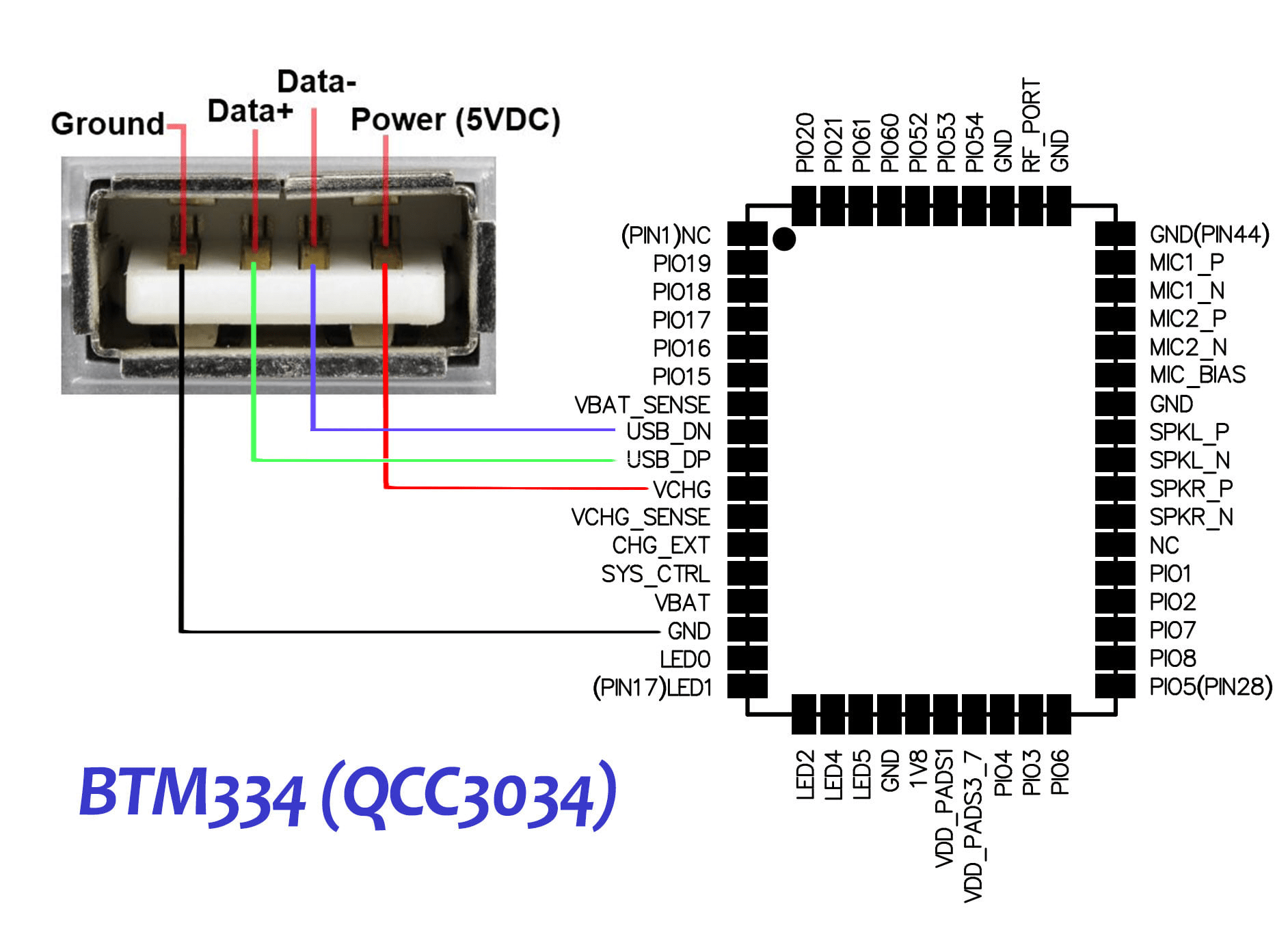

Do you have use a TTL converter from 3.3V to USB 5V for this connection ?I tested connection:
GND -> GND
Data+ ->USB_DP
Data- ->USB_DN
+5V ->VCHG
And it works! I unlocked the device and now I'm trying to work with MDE.

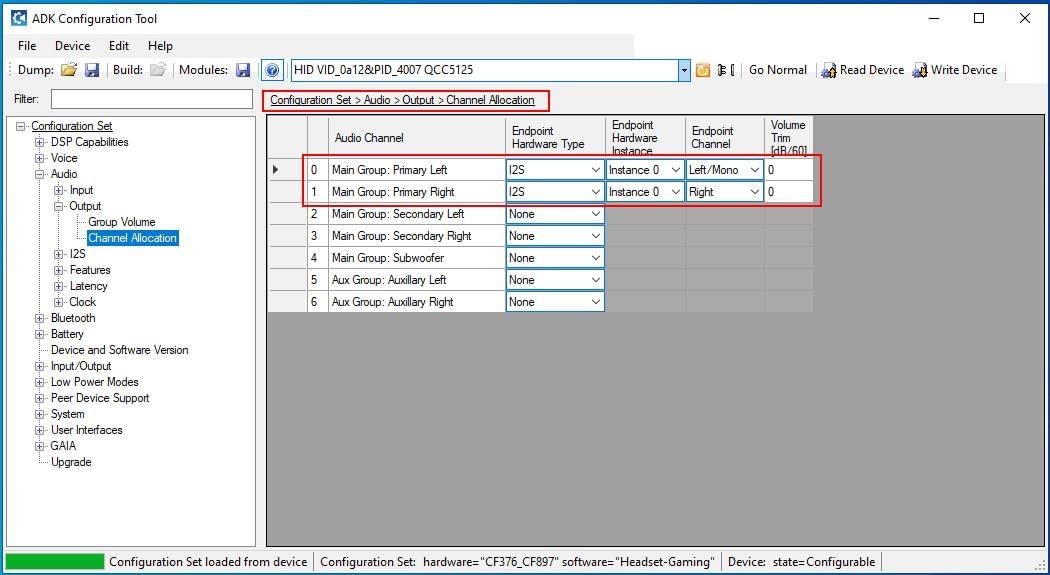

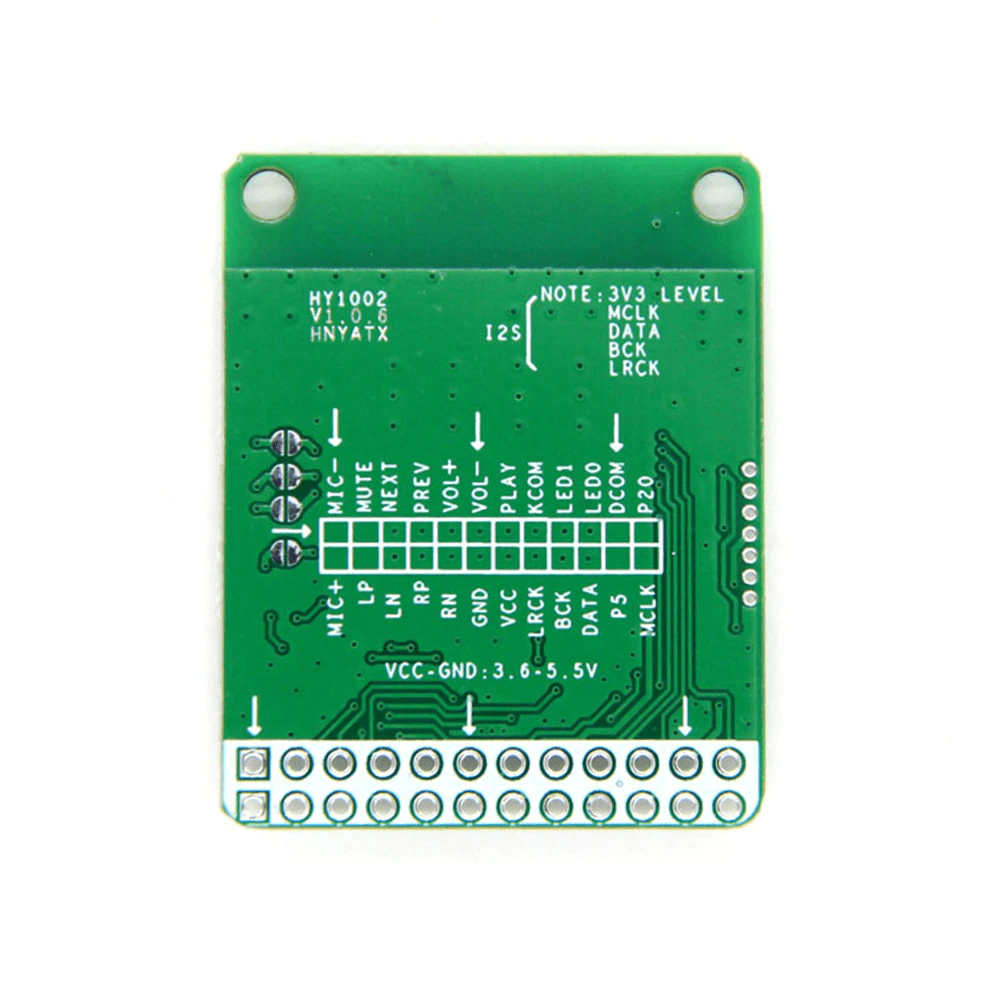

Hello. I'm new to the forum. I bought a module with the QCC3031 chip (photo). I thought I could get an analog differential audio signal (LP, LN, RP, RN) and I2S from it at the same time. However, only the I2S output is active. Is it possible to change the configuration of the chip to get both signals at the same time? I will be grateful for a hint.

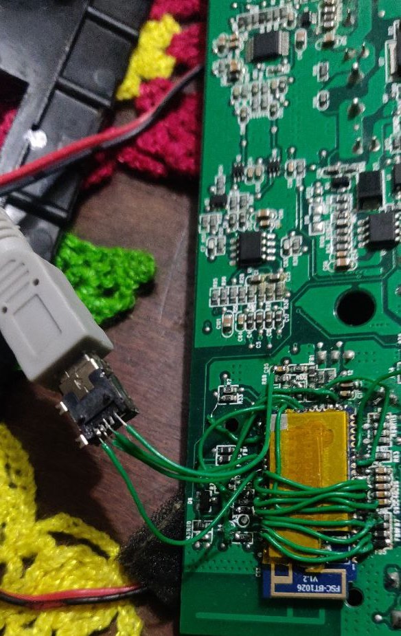

Hi everyone
I'm new in this forum and I'm doing a personal project upgrading bt speaker using FSC-BT1026E (qcc5125). But the default Feasycom's firmware is a little basic and I can't enable i2c in order to turn on sta369bws module. I'd already install ADK Qualcomm and unlock usb device and dump default firmware. However I didn't found Qualcomm MDE. Someone have a copy of it? Thanks

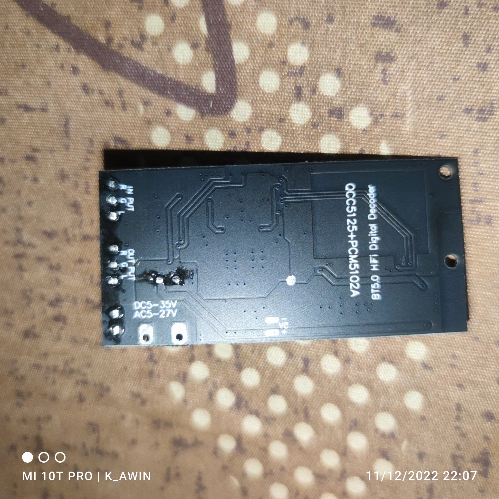

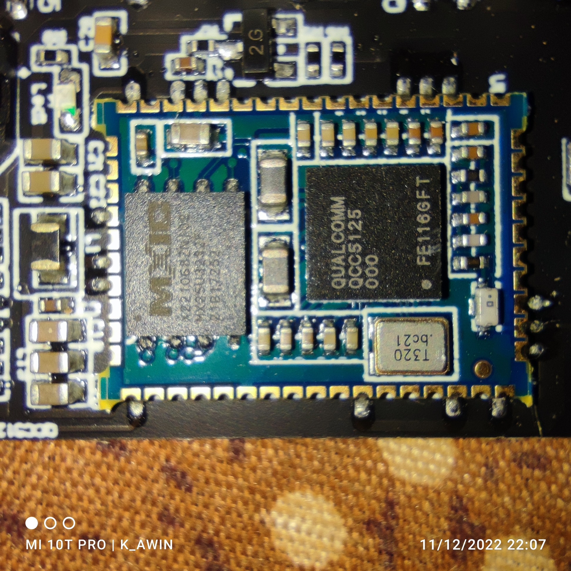

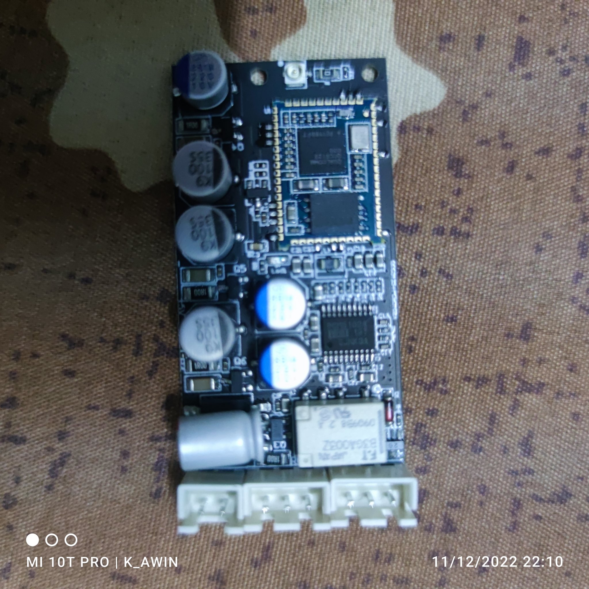

Hello, I have qcc5125 board with pcm5102a, it has LDAC codecs. I use QCC_tools to rename bluetooth, success once then i go to QATC try to EQ it as the same time i change the name of bluetooth again. It brick, I press Reset button in QCC tools, and reboot, but nothing change. Then I press Erase button in QCC tools and Burn some Firmware dump from same boar but bluetooth can't turn on, still can connect debug with pc, but can't Read data or set any thing in QCC tools, QATC can't connect. What should I do? Help me please!

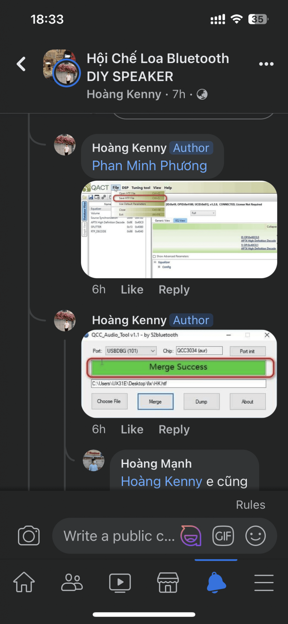

Use qcc tool to merge *.htf fileHi Tornester,
Were you able to somehow save the new EQ parameters to the chip? I'm trying with the QCC3031 chip and the QACT_v7.2.8 tool and so far I haven't found a way.
If you have any tips, I will be grateful if you share them.
Use Nvs App to burn your firmware (*.xuv file)Hello, I have qcc5125 board with pcm5102a, it has LDAC codecs. I use QCC_tools to rename bluetooth, success once then i go to QATC try to EQ it as the same time i change the name of bluetooth again. It brick, I press Reset button in QCC tools, and reboot, but nothing change. Then I press Erase button in QCC tools and Burn some Firmware dump from same boar but bluetooth can't turn on, still can connect debug with pc, but can't Read data or set any thing in QCC tools, QATC can't connect. What should I do? Help me please!
Gửi mình sửa giùm choHello, I have qcc5125 board with pcm5102a, it has LDAC codecs. I use QCC_tools to rename bluetooth, success once then i go to QATC try to EQ it as the same time i change the name of bluetooth again. It brick, I press Reset button in QCC tools, and reboot, but nothing change. Then I press Erase button in QCC tools and Burn some Firmware dump from same boar but bluetooth can't turn on, still can connect debug with pc, but can't Read data or set any thing in QCC tools, QATC can't connect. What should I do? Help me please!
where can I get the qcc tool? seems mine is differentUse qcc tool to merge *.htf file
