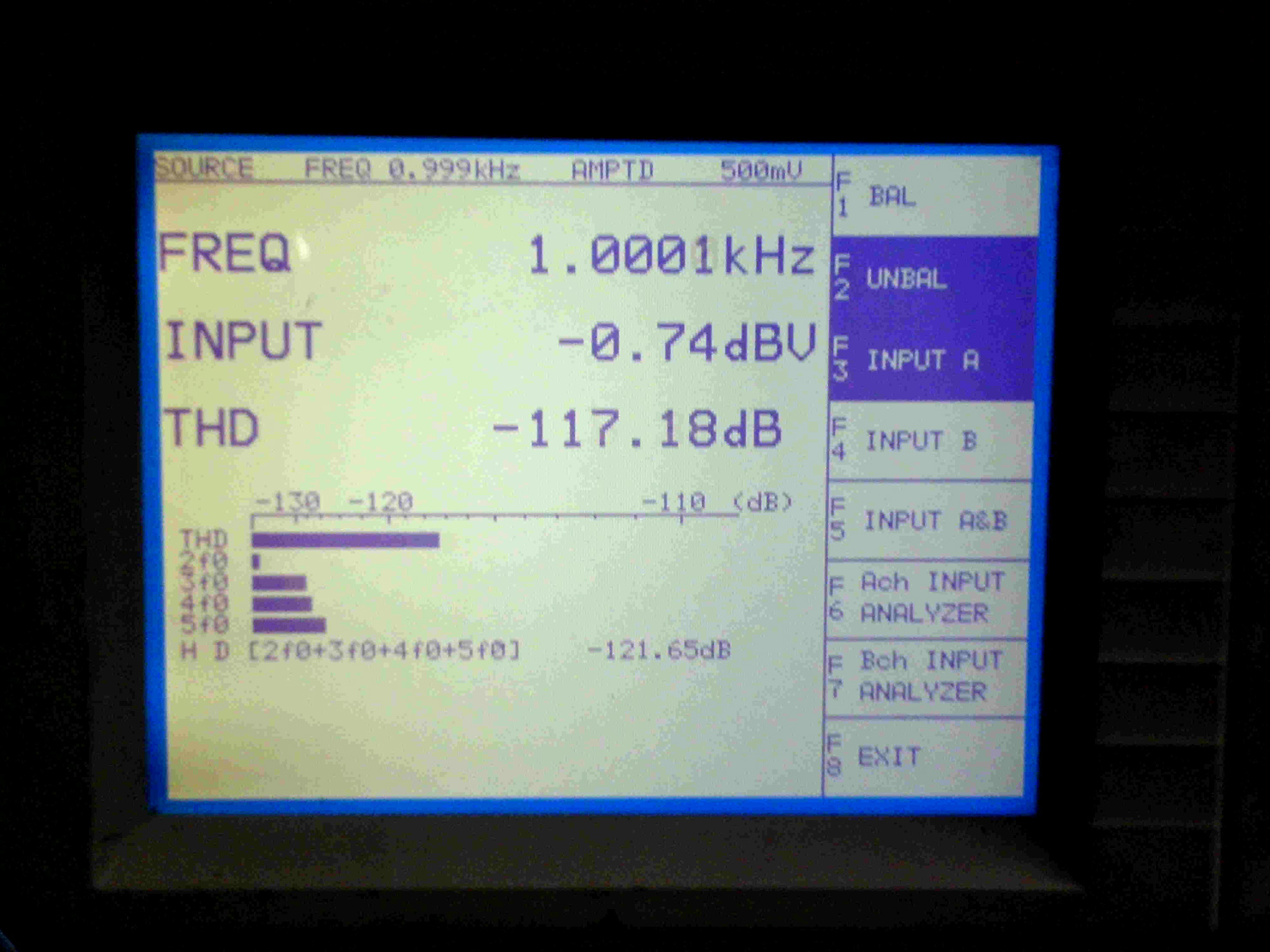

QA Oscillator alone
I did a very fast check of the QA oscillator.
It is set to the default of 1kHz and 0dB.
The VP-7725 shows almost nil 2nd order! Look at the image.
This was one of the best readings I got, it bounced slowly up and down, going up about 5-6dB.
Important to note this is with both instruments *cold* as in outside temp, which was about 55-60deg F. Thinking the QA works better *cold*.
I also did a loopthrough on the QA. Best readings I have ever gotten thus far. Noise floor happened to be in the -135dB range.
So, I think we can safely conclude that at least the 2nd order spurs in the QA are not from the internal oscillator.
There is some uncertainty however, as setting the level lower than 0dB in the continuous run oscillator dialog box did not produce a signal that the VP-7725 was able to read. I did not put a scope on it to confirm what was coming out of the QA, but loopthrough said it was working fine at that level. (at least I think it did, it may be that I imagined this, as the RUN button probably pulls the continuous feature off) This is part of the uncertainty of operating the VP-7725, it is difficult to know what it wants or what it is really doing at any given point - you hear relays clicking, but it's not clear why or what they are doing. It's unclear that there are not one or more faults either.
I also explored the hitherto unknown "Notch" menu. It shows "AUTO" - so apparently there is an automatic notch applied. If there is a way to take it off AUTO, I could not find it. Another situation where a manual would be nice.

Yes, I was surprised to see 2H so low!
But it does serve to indicate that the 2nd harmonic spur in the display of QA is not being generated by the oscillator, so that is almost certainly off the table now.

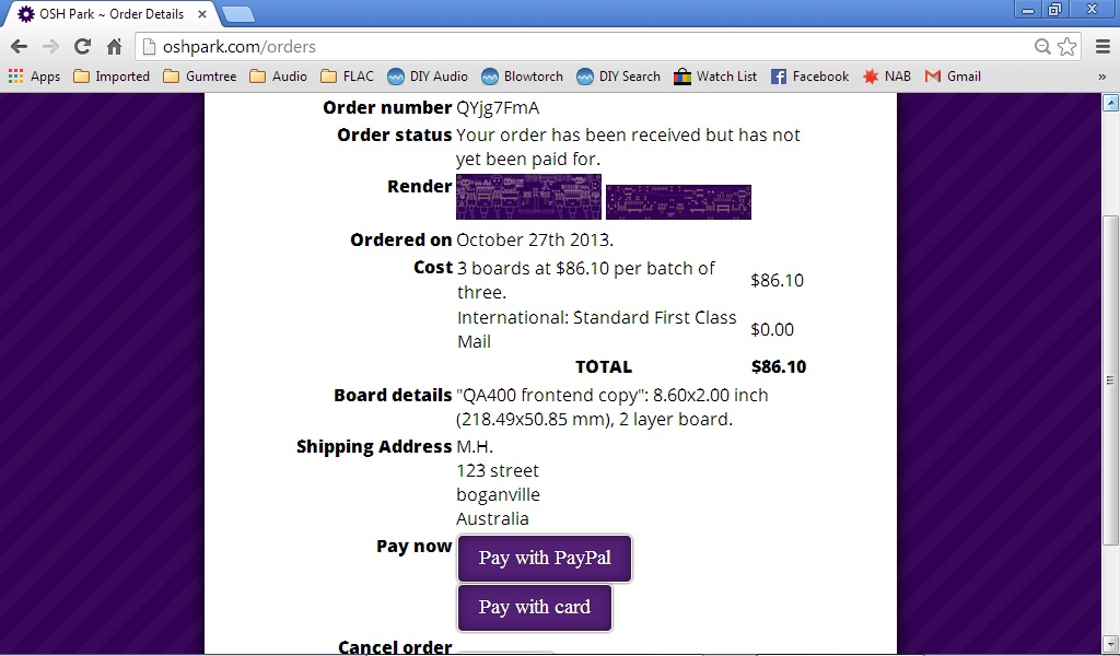

QA400 frontend
Looking for more information about the QA400, I found this project.
Not only found more details about it. But it seems very interesting.
OSH Park ~ Profile for prettygoodaudio
Yes, but I have not figured out how to order, if one wanted to. Maybe you have to create an account first? In particular it's unclear how much the board would cost... and they seem to say that they make a "panel" of them to drop the cost, so maybe they are pre-made?
Also in a very fast look, did not see what the power supply might be... and if there is any text documentation...
_-_-
_-_-
_-_-
It seems that you need to order multiples of 3 at 28.70 each.
http://oshpark.com/ said:Your design will cost $86.10 per set of three
The questions are, will it work
And last but not least, there is the work of '1audio' will this be a buildable project, and will we prefer it (I do until proven otherwise
