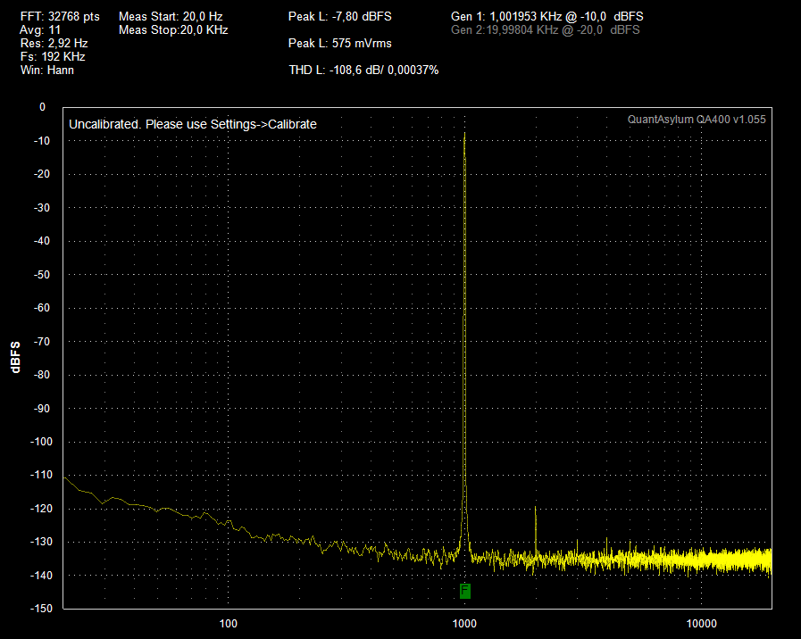

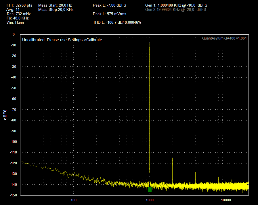

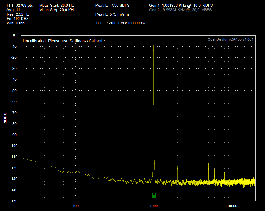

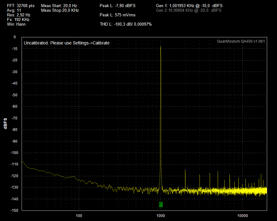

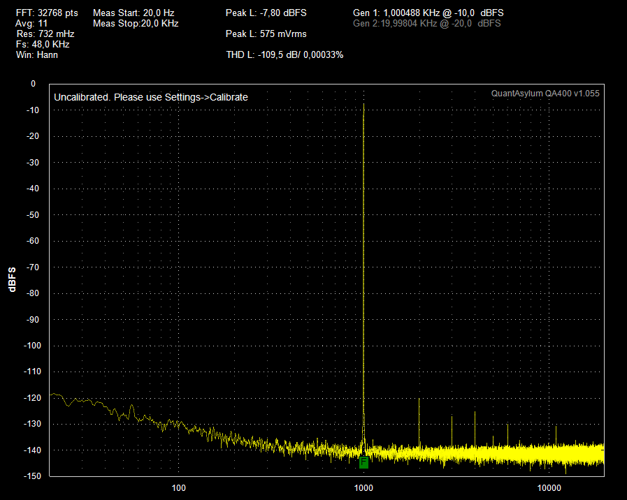

Set the system to 48 KHz, take a measurement. Shut it down and restart the app. See if it changes at all. Do the same with 192.
Here is my plot. From left.
1. Start application and set settings to 48KHz.
2. Close application and re-plug the QA400 HW. Start application and make Measurement at 48 KHz
3. App still running. Change 48KHz to 192 KHz. Make Measurement.
4. Close application and re-plug the QA400 HW. Start application and make Measurement at 192Khz
3 and 4 differ a lot even the settings didn't change between these 2 Measurements.
I agree. There must be a SW bug at play here.

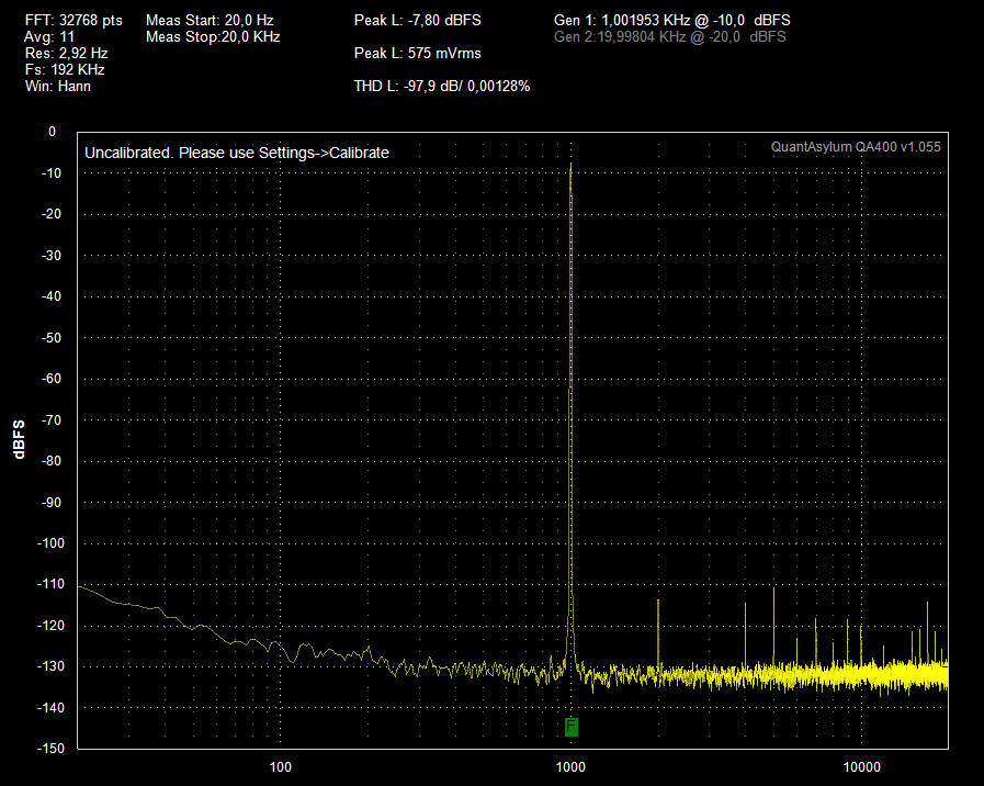

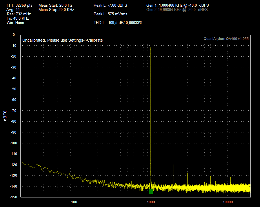

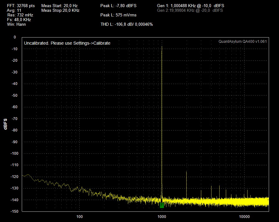

Here is the same exercise with Pre-release 0.61. From left.
At least they are consistent. But spectrum not as "clean" as some of my others.

I would be suspicious of the clean plots. They are too good to be real. The dirty ones are probably more real. With windowed measurements there are other potential artifacts that can surface from timing errors etc. Do you set similar results with more averages?
Have you tried the melt noise option? It will show synchronous stuff that won't go away.
