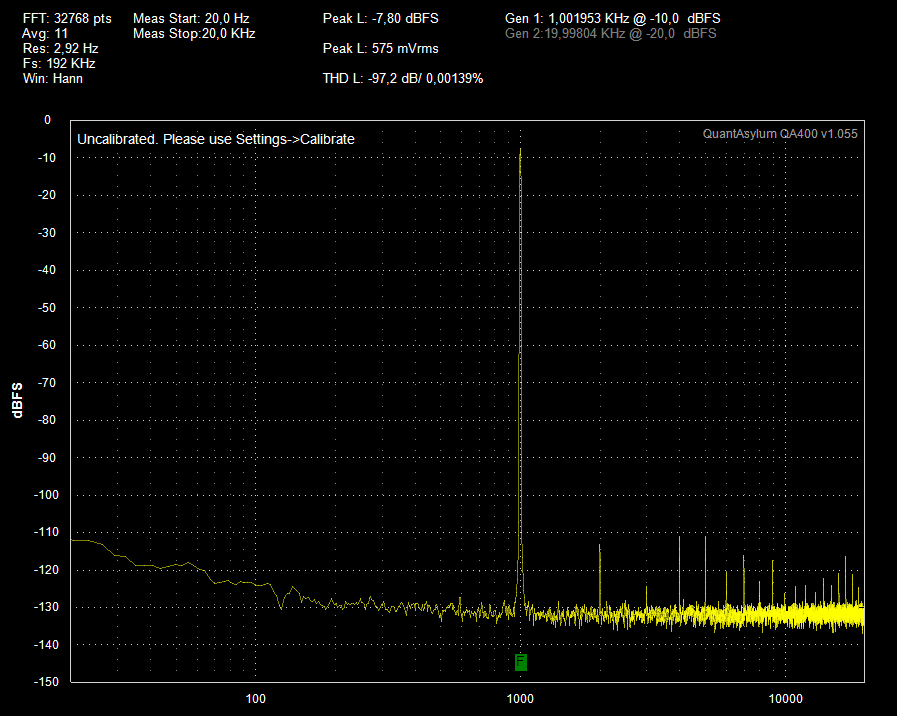

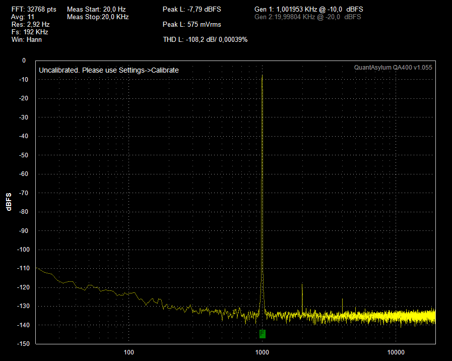

Hi Demian,
MKC- That's really good. I would not trust it to give you the same plot again. At 192KHz sampling I don't get anything that good. Which version of the software are you using?
Sorry, I can't remember. Since the version number is not visible, it could be a rev. 1 or one of the pre-releases.
Anyway, there seem to be something going on here I don't understand. I just made these 2 plots. The only difference being that the first and "cleanest" one was taken with the QA400 just powered up and SW just started. The second one is taken after fidling a littlebit with the settings and a trail run at 48 KHz. But, as you can see I have restored the settings to be exactly the same as the ones used for the first plot. I can't understand the inconsistancy. I have seen this behavior with all the SW versions. But, I have never been able to figure out exactly what causes it, but changing sample frequency seems to be able to provoke it. As a SW guy my stomach feeling would be to start verifying the generator path. I think this must be a SW issue.

Does it happen when using an external generator source.
Joined 2004
The first plot shows 192 KHz as the sample rate but the measurement noise floor only happens at 48 KHz sampling. I missed that detail at first. Its a software bug of some sort I think.
Set the system to 48 KHz, take a measurement. Shut it down and restart the app. See if it changes at all. Do the same with 192.
