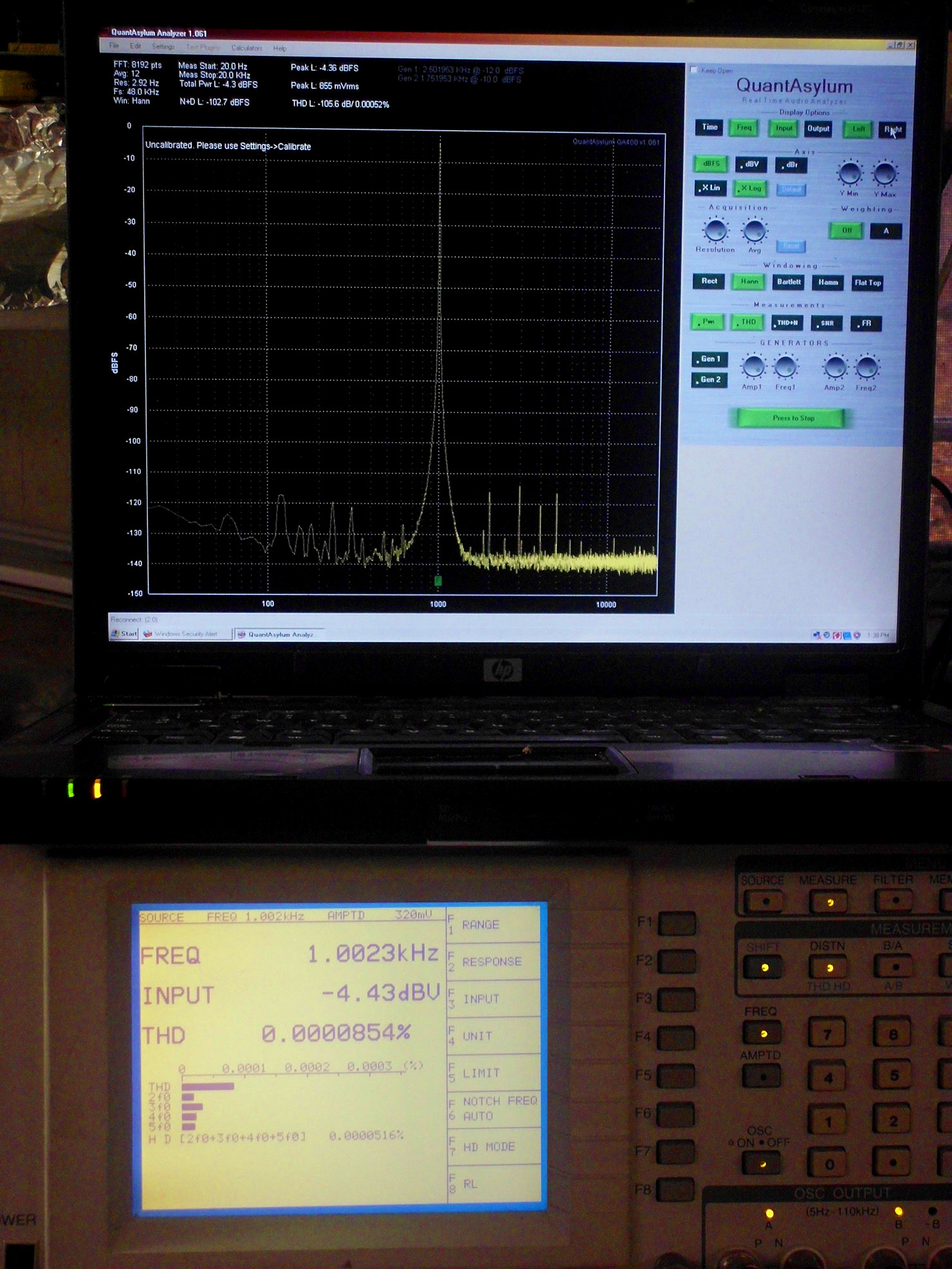

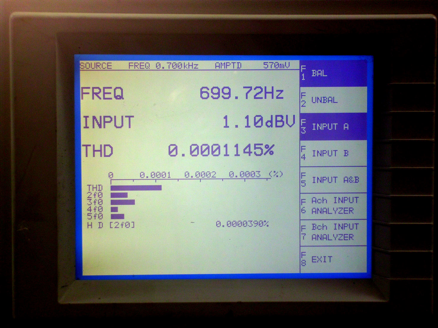

Here are a few results from today.
VP-7725 driving the input of the QA.
Set the 7725 as close as possible to the "bin" that the QA selects for "1kHz" outside that bin, the fundamental's shape gets wider on the display. That was 1.002kHz, iirc. QA called for 1.00198 or something like that.
Forgot to run the output of the QA's oscillator into the VP-7725. 🙁
Oy!
The VP7725 *may* be overly optimistic about what it reads. I did buy this one as-is surplus. Perhaps, perhaps not. Oddly the external loop via BNC coax measures just slightly better than the internal (push a button) loopthrough.
I was also thinking that the LF carp that the QA seems to pick up through the case (maybe it *needs or wants* to be grounded externally? Are the inputs and output BNCs floating - forgot to look at that?) is factored into the number that the QA puts up as THD?
They do not agree about the ratios of harmonics, but the QA does have that residual spike stuff going on, but it seems to be ok down to right at 0.001%. Going above about -10dB on the input of the QA with the VP7725 oscillator driving it still increases the spikies.
My LEFT channel is still somewhat cleaner than the right.
Neither has been "calibrated" yet. And they do not agree on levels, so that needs doing.
At this point I'd be surprised (but that happens too often anyhow) if the A/D is doing the spikey bit, so I am thinking, maybe it is the input opamp(s)? If so, perhaps surgical intervention is called for? That extra 10dB would be sweet.
Oh, the residual with nothing plugged in drops the noise floor down to ~-130dB cleanly.
I looked in vain for a BNC dummy load or just a BNC cap to cover off the unused BNCs, couldn't find one anywhere! Gah! I *know* they are lurking and mocking me.
There is definite feed through/crosstalk between channels of the QA. Although I am not sure if it is internal or the BNCs talking to each other yet. (no I did not make up a shorting or dummy load BNC, time was at a high premium...)
The images shown are with the QA oscillators off. Things are not as pretty with them on - I ran them at higher unrelated frequencies just to see if it showed, it does.
