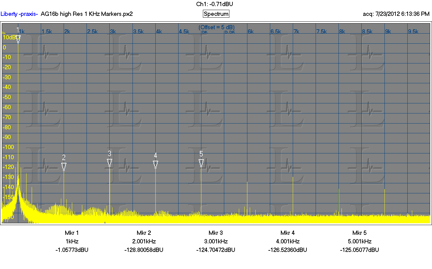

I have had the grass growing on the bottom of the FFT display and I have been able to be rid of it.... as Demian said, it all needs isolation and care with ground paths... and shielding. Doing that is not a P-n-Play operation for most people. But if Demian or another can find the time to complete and get something useful as an add-on product or a DIY project installed inside a QA400 -- what ever -- then it will be more P-n-Play and useful for a test instrument capable of utilizing a greater amount of the potential of it's 24 bit system.

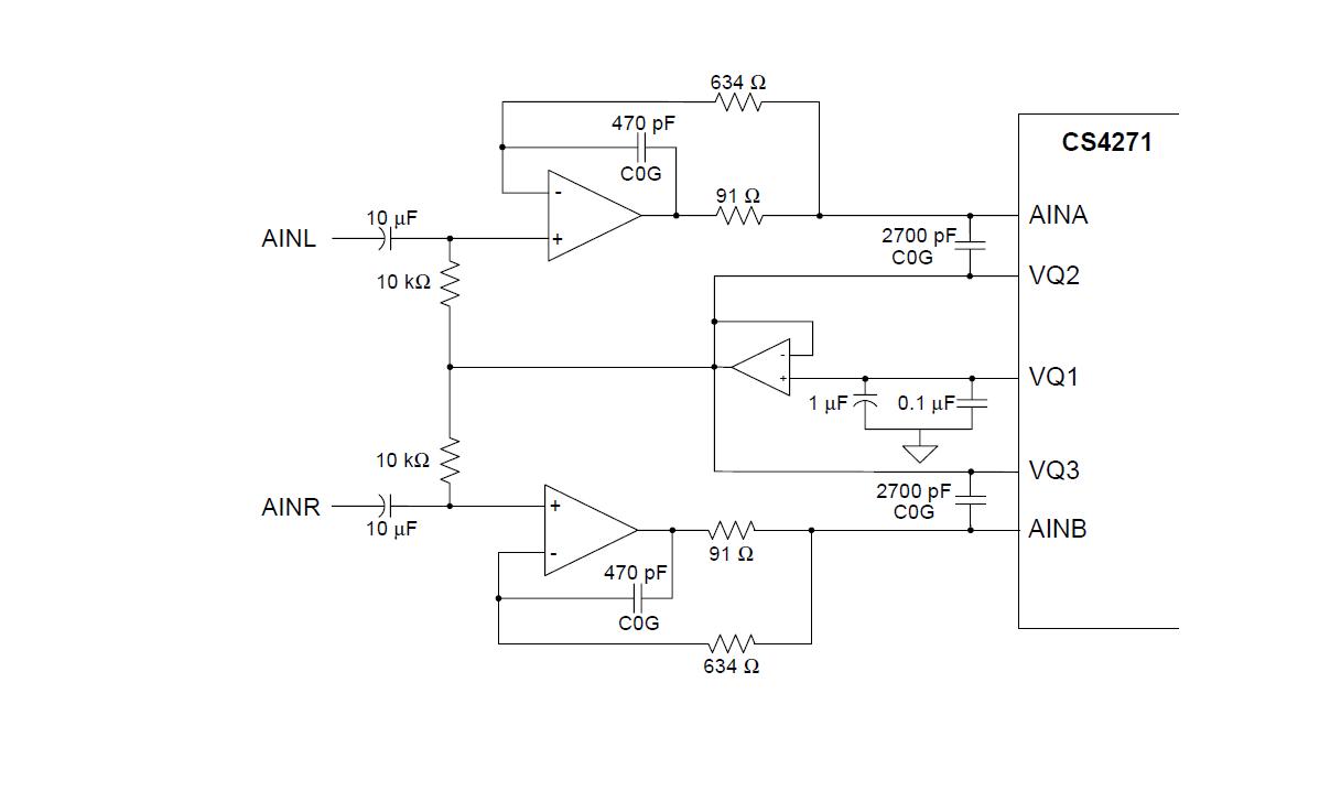

Bear the op amps are OPA1641. Two for each channel making up a balanced drive for the ADC. The op amps have to be a rail to rail to have enough swing to meet the Vpp conditions. The op amps are supplied by a 10Vdc single ended supply and biased from the VCOM buffer through a 100k ohm resistor. The VCOM is buffered with another OPA1641.
What's in front of that is a 1K resistor, IIRC a 10uF ele and an ESD chip.
That's the front end of the QA400.
Mmmm... well those spurs are raising up from somewhere.
Looks like the OPA1641 *ought* not be able to produce these spurs. Wondering if it is something amiss in the power supply doing that?

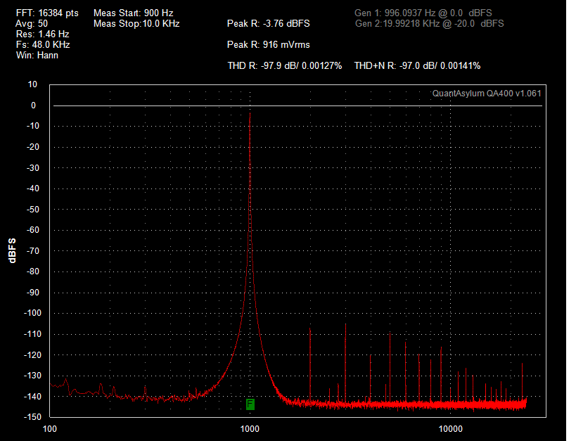

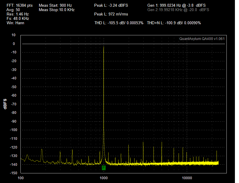

Below are three quick tests I just made with the QA400. It was my laptop on battery to QA400 to generator. I tried a separate ground from the generator to to the QA400 but saw no difference.
First is left, second is right and third is loopback on left. All I see is harmonics with some really low level noise. What I don't understand is why the distortion numbers are different when the plots are pretty much the same. That's to be checked and pursued with Matt when I have time.

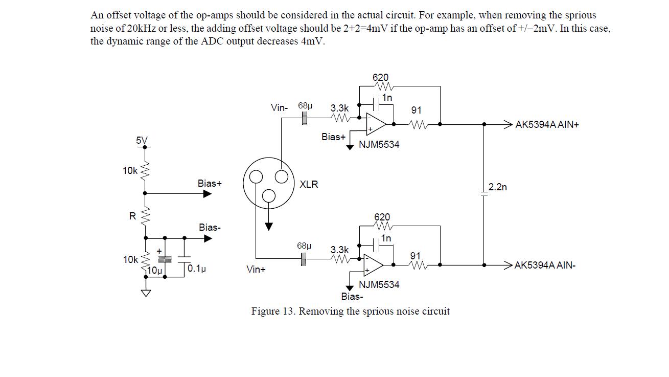

Bear one thing you can try, which if IIRC did have an effect on the spurs, is to lower the VCOM coupling resistance from 100K to 10K. Crystal recommends this value in the app section of the data sheet. The value was increased in the QA400 because it is this resistor that sets the nominal input impedance.
It's easy to just solder a leaded resistor across the SMT part.
There is an offset circuit described in the AKM application section which addresses spurs.
I haven't seen this technique in Crystal's literature but it might work with the Crystal ADC's. The input circuitry for Crystal and AKM is almost identical.

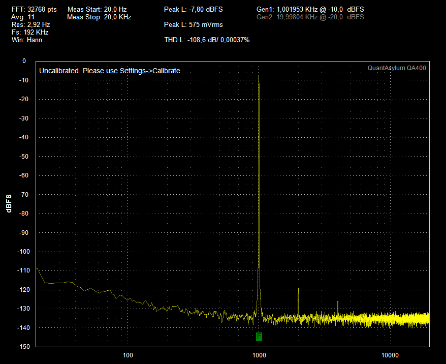

I have actually saved a screen plot of the QA400 in loopback. From time to time I have noticed that I seem to get a very clean spectrum of only 2nd and 3rd, but for most times I get a spectrum similar to yours. Have you seen anything similar?
I have the plot on my laptop. Let me see if I can figure out how to upload a picture.

This is the exact input circuit used in the QA400. The codec used is a CS4272.
A 1K series resistor was added between the input cap and VCOM resistor and an ESD chip after the 1k resistor. The 10k resistors were replace with 100k. Otherwise the circuit is identical to what's in the QA400. The VCOM of the CS4272 is called VQ1 on the CS4271.

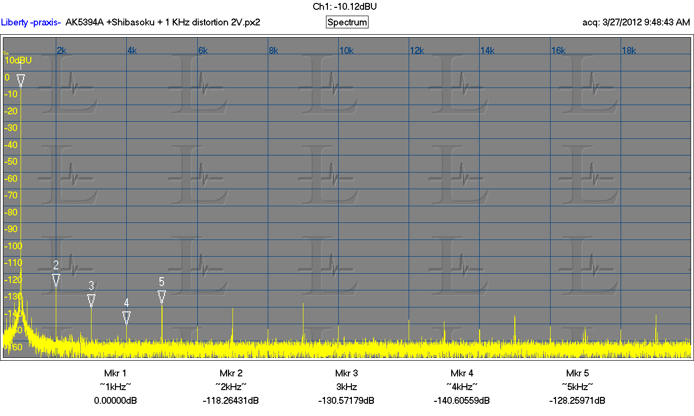

Attempt to upload Picture. Please notice that I captured this while my QA400 was un-caibrated on the laptop and I can't remember if I ran on batteries or with the charger plugged in. In any case, I have seen this also when connected to my stationary.
Am I beeing fooled here?
Mogens
Mogens
Mogens
Nope that's what it should look like.

Ok, a few datasheets later...
AK5394a. The exact nature of "VCOM" or "VQ1" is a bit unclear. AK calls it out as a reference voltage but that no current can be drawn. "VCOM is a common voltage of the analog signal". Eh? What does that mean?
AK5394AVS.pdf
Then they show the bias voltages being derived from the power supply rail and ground via a divider, not from VQ1/VCOM.
But here:
AK4620BVF.pdf
We see in figure 19 for example, the same harmonic spurs emerging with a signal at or near 0dbfs. This chip has similar performance.

The offset in the AK5394A datasheet moves the zero away from digital zero, which moves away from a difficult area for all audio ADC's. Below are 2 measurements of an ultra low distortion oscillator by a tweaked AK5394A. There are still harmonics. All the harmonics are below -118 dB and you can also see some 60 Hz stuff near the fundamental. The first was measured at 2V in with 4 V representing full scale. The second at 4V with much higher resolution. I'm not sure I trust the harmonics, since the oscillator drift could reduce them. The bins are approx .05Hz wide in this measurement and it takes more than 5 minutes to make. I believe this is the current state of the art performance possible with an ADC. It also shows that a bigger microscope will always show more problems.
The Vref is a critical point in the ADC and lower impedance + lower noise reduces harmonics and residuals in the output. Getting that right is difficult since its ground reference needs to match the input perfectly but not cause other noise issues in the chip. Single ended power makes this even more difficult because the chip ground also needs to deal with all the digital switching currents.
