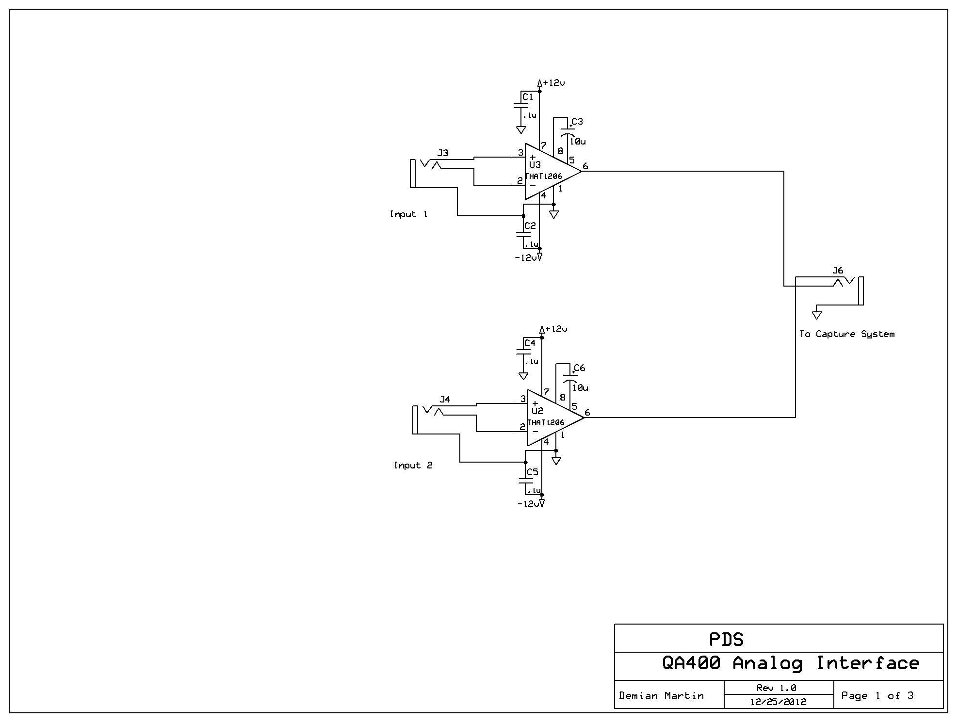

QA400 Interface in JPG:

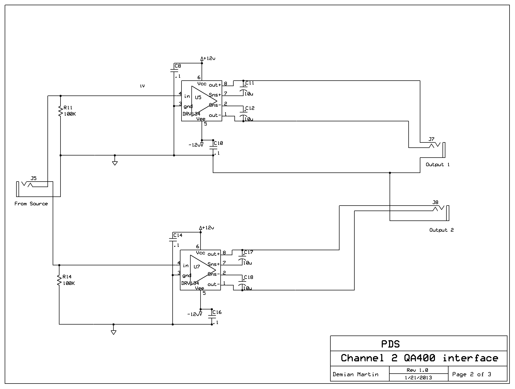

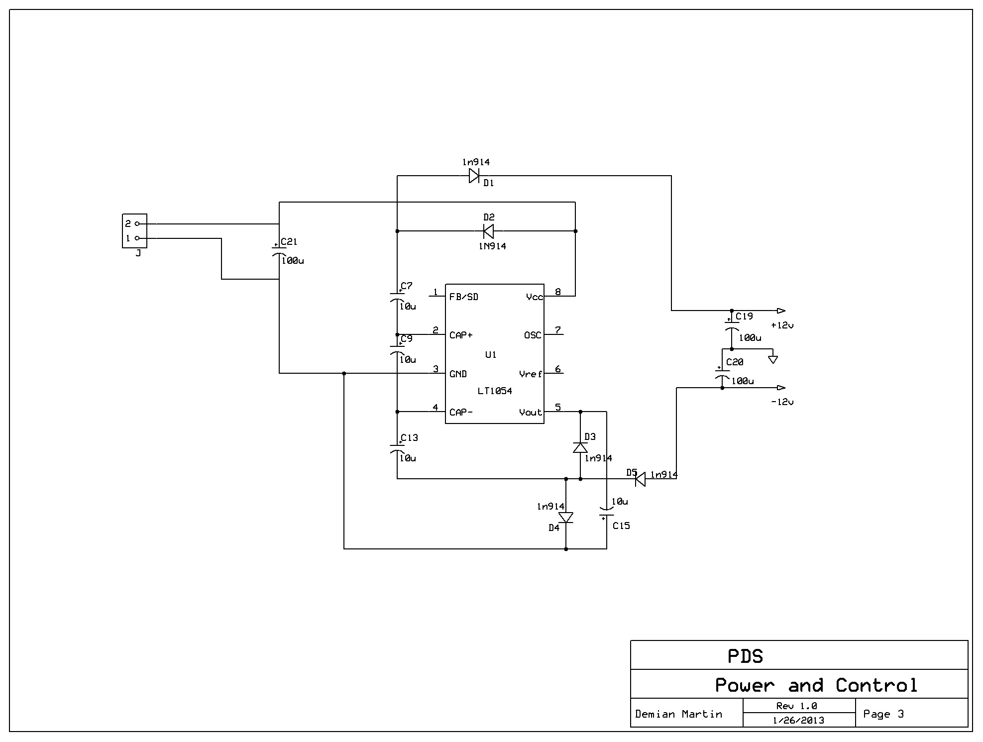

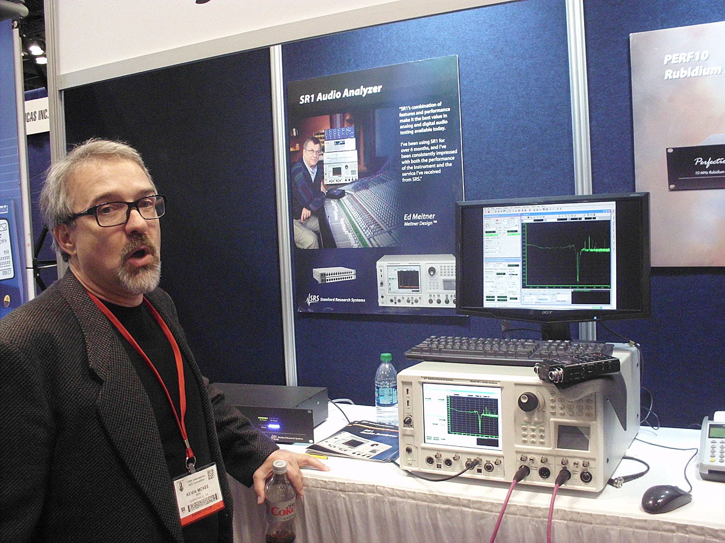

So I stopped at the Stanford Research booth and took a look at the SR-1 distortion analyzer in action. Loopback actually.
Talked for a while with Kevin McKee, one of their engineers about what was being shown on the screen. Which at that time was an apparent astounding 240dB of dynamic range.
Think it was a 10kHz signal, not positive - the pix will show that.
But they were notching the fundamental with about 40-50dB (iirc) of analog notch and (again iirc) about 70dB of digital notch, and then the software "knows" this and stacks that onto the scale for the apparent range. If I have that part reassembled properly.
So, I of course questioned this dynamic range, and then Kevin changed the display parameters and showed what was *really* going on. That is in the image attached.
Here's the crux, the SR-1 has very similar spurs as does the QA. Look!
Kevin also discussed the problem with trying to deal with them by any inversion techniques, etc., and that is that these products, both from the ADC chips and as the result of DUT distortion have small phase shifts that make them somewhat indeterminate at any given time. Again, I think I have the gist of this right.
The discussion also swung to how TI and National test the distortion of these ultra-super-low distortion opamps, and this apparently is laid out in some app note. What they do is to compare what is going on at the inverting input with the input (assuming feedback is present), and analyze that residual. Kevin said that in his opinion this is a fairly variable and not totally predictable or accurate method, but I found it fascinating. I always wondered how they did it.
While the $8400 SR-1 box is cute, flexible, very good and computer agile bottom line is that the basic difference in performance between it and the QA400 is actually fairly small, except the bandwidth on the SR-1 is almost certainly better, as is the input range. Also, it is apparent that the notch provides substantial benefits. Gotta get one!
