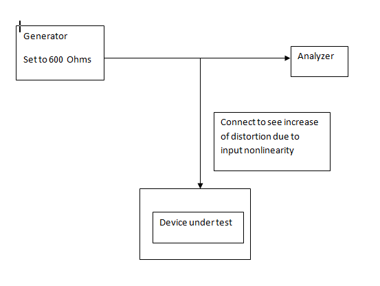

I think this will illustrate what I'm asking:
The gen used was a 600 Ohm output Z (HP 339A)....
-RM

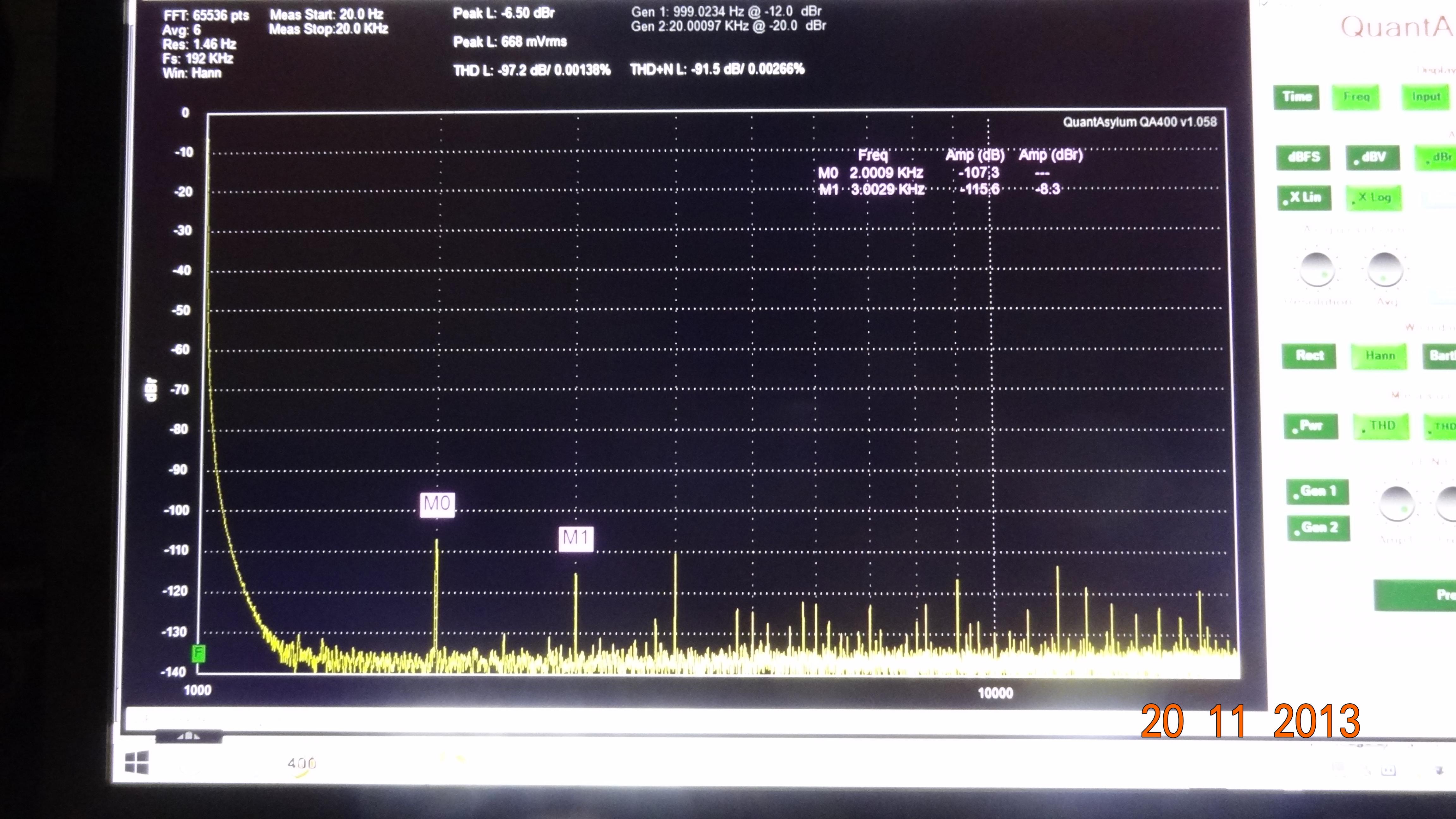

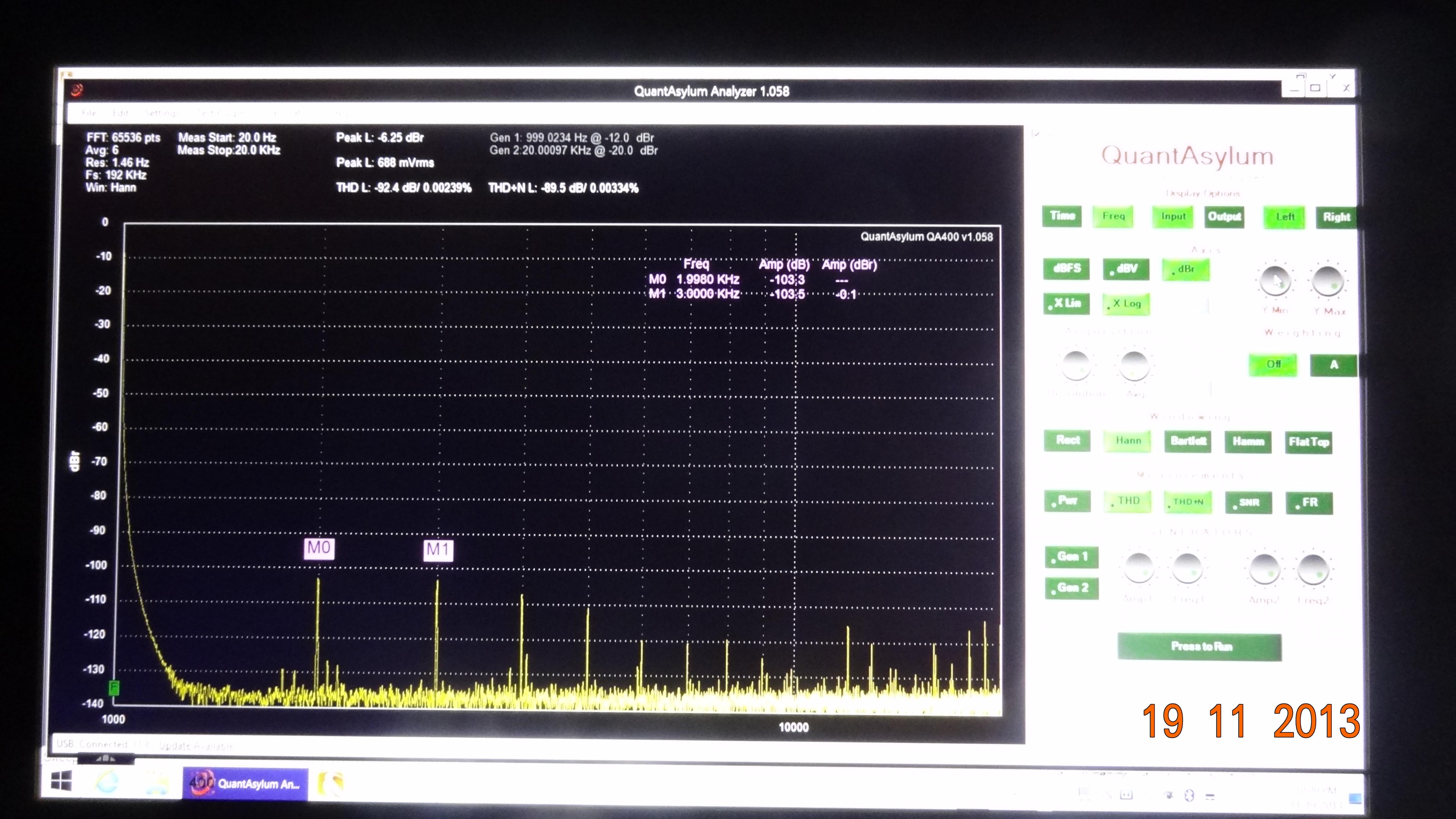

comparison A-P vs QA400

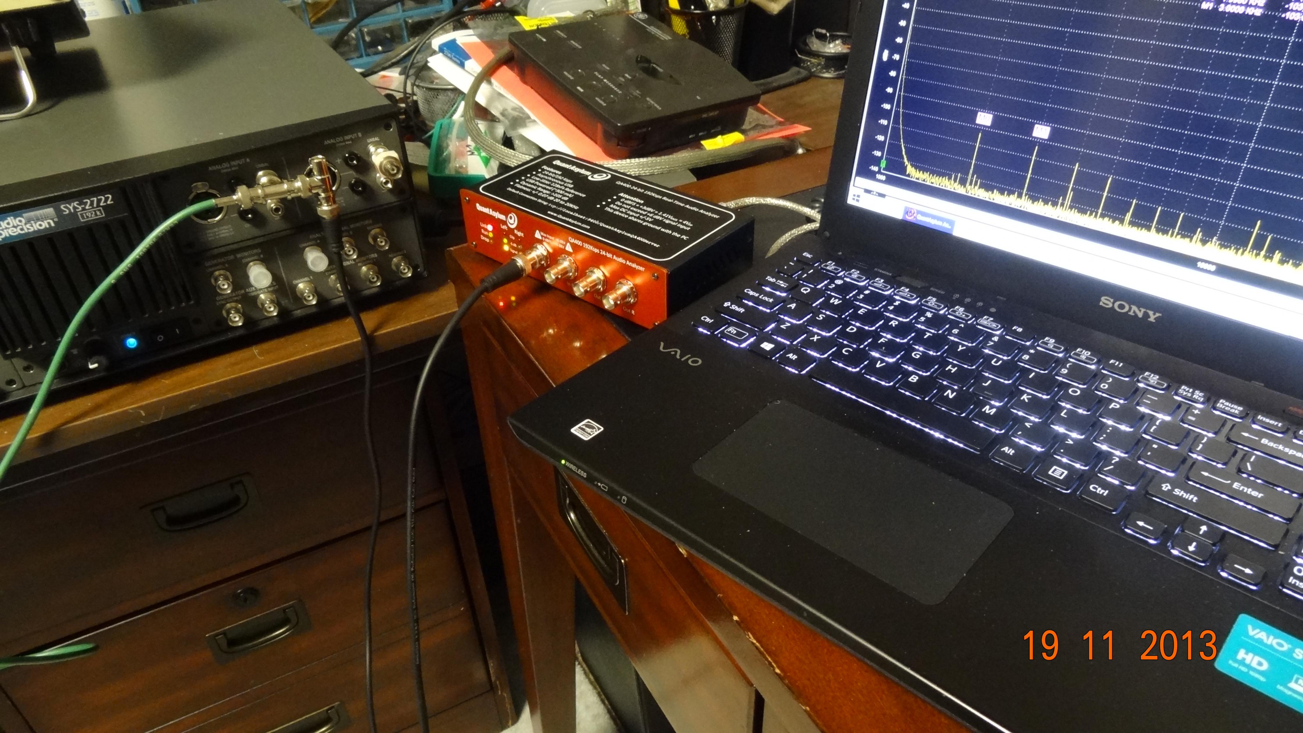

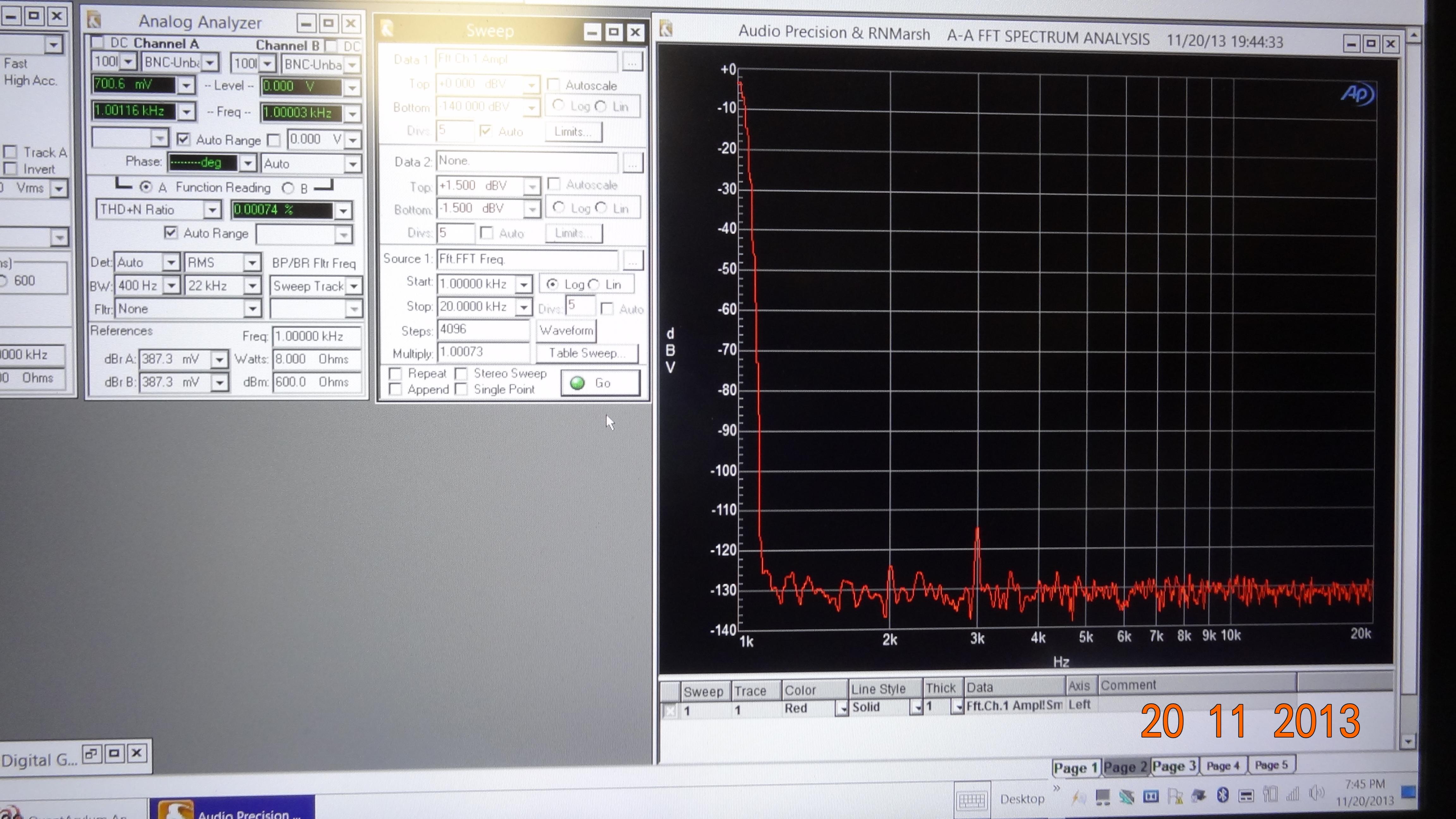

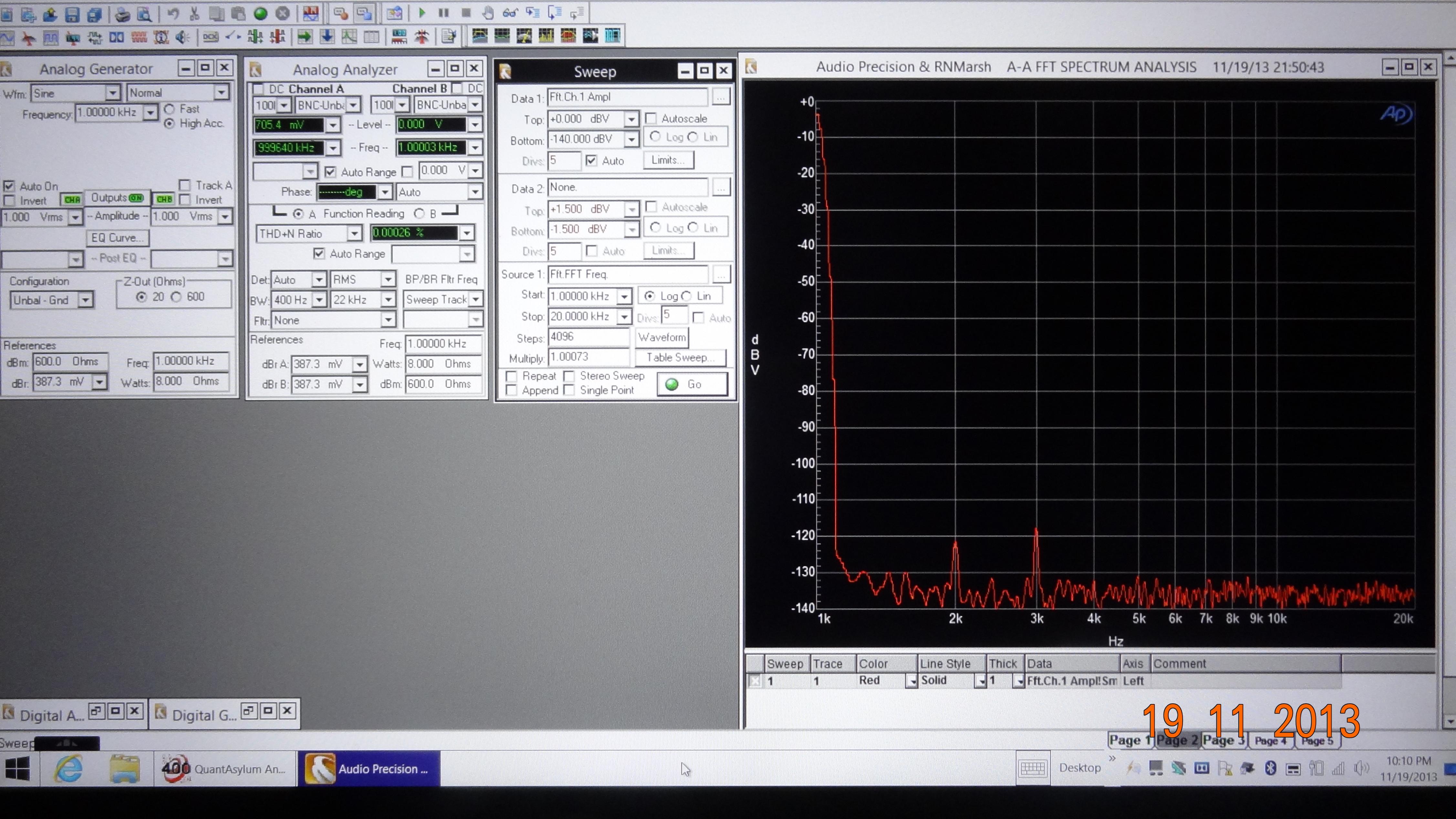

Using the ShibaSoku AG16 source (600 ohms/.7v rms), the QA400 added .0001% THD+N when applied in parallel with Audio-Precision 2722.
That is when the QA400 is in data acquisition mode... when halted and you have only the screen capture display, the THD+N is 2-3%.
The AG16 shows on the A-P as only having 2H and 3H at about -120dB and nothing above the noise floor of -135dB above those two harmonics.
The QA400 however, shows a lot of harmonics and extrainious freqs beyond the first two harmonics and shows the 2H and 3h at a higher level than the A-P.
RNM

The point being that the QA400 etc. will introduce distortion at its input. You can measure the distortion introduced by the input of the QA400 (or whatever) with this test.
