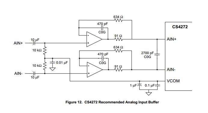

The CS4271 and CS4272 are two variants of the same part and in fact might be the exact same die. One is single ended, the other differential. We’ll do a fully differential product at some point, and we wanted to keep just one part in inventory.
Below you can see the 4271 and 4272 suggested input. Note the 4271 just ties the negative inputs (what they call VQ2 and VQ3) to VCOM. And then the 4271 has precisely 6 dB less DR. The noise floor is the same, but the total amplitude is half because it’s single ended. So the numbers make sense.

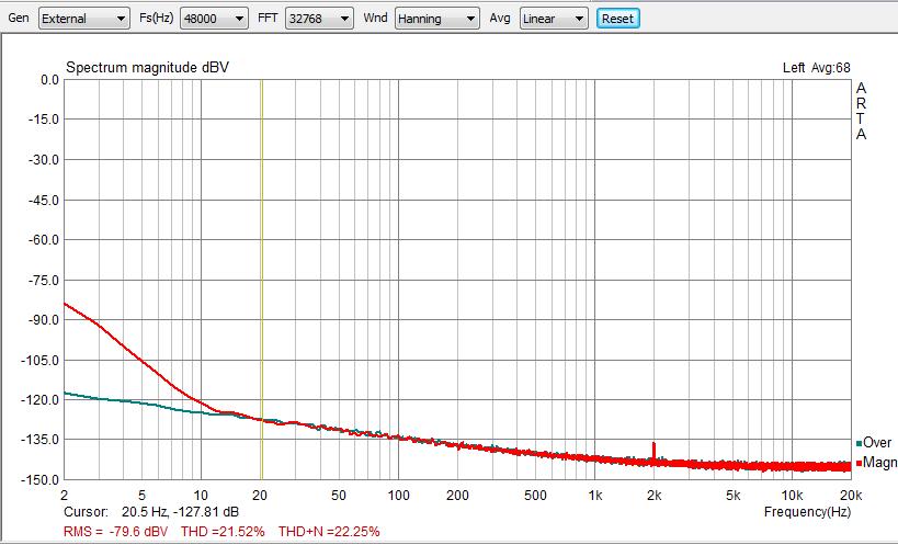

Also agree that EMU doesn’t have this issue to the same extent. But they still have a rising noise floor. They use an AK5385. Below is EMU, cal’d to -15 dB. Red is with nothing plugged in and the blue is with a 68 ohm short.

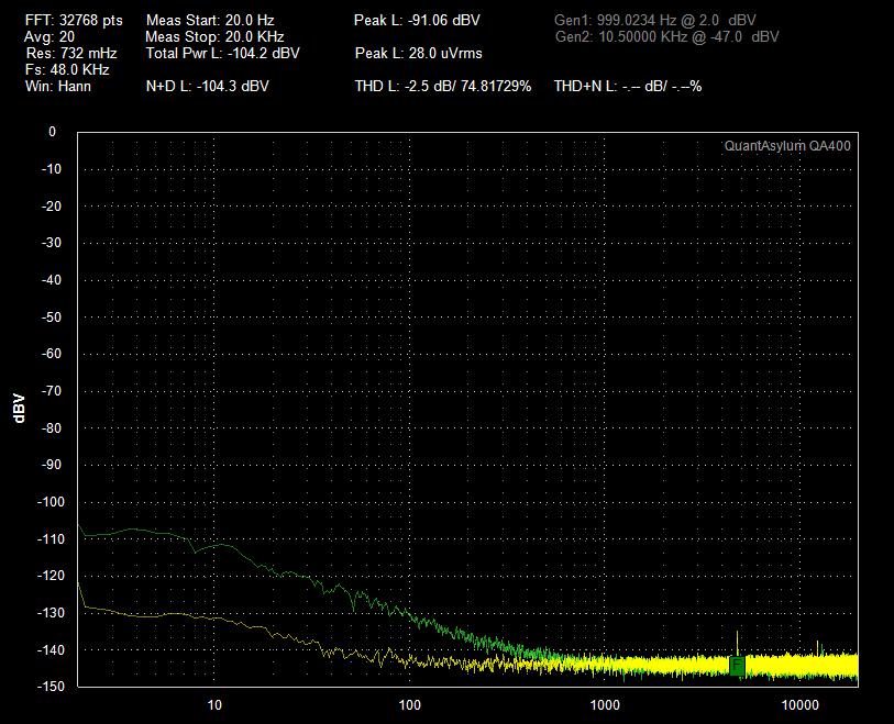

And here’s my stock QA400 with both 68 ohm load and open circuit.

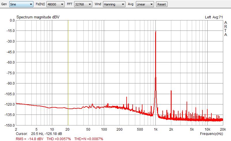

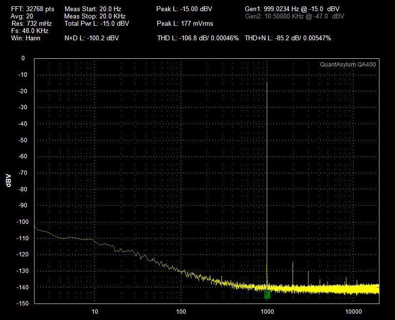

Also, take a look at the EMU in loopback at -15 dBV from its rear output to its rear input. And compare that to the QA400. Not even close J

The real issue is the semiconductor junctions are nonlinear caps. Tricks like Cascoding reduce this effect. Unfortunately its hard to get a large common mode input range with a cascoded input so I don't think you will find it in may opamps if any. I posted a circuit that could reduce the effect here: http://www.diyaudio.com/forums/equi...dc-design-ak5394a-other-adcs.html#post3708537 however its a lot of parts to dot he task. The capacitance of the traces on the PCB are a small part of the issue.
