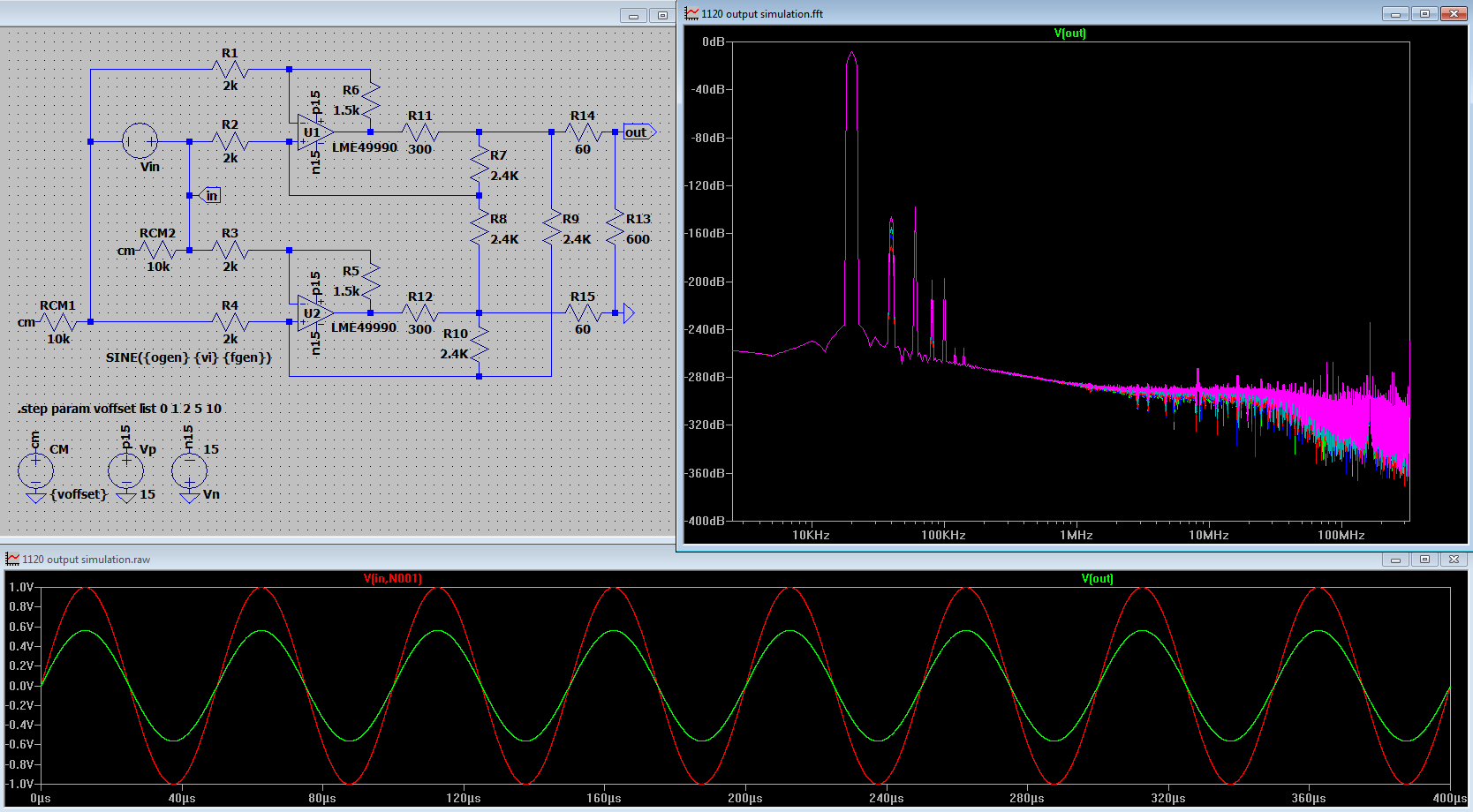

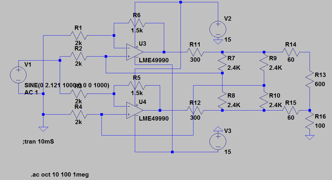

I built it into LTspice with all the details using the LME49990 model I setup in LTspice. That all works well. Included in the model are the 60 Ohm resistors to have a correct 600 Ohm source impedance. You can see the output voltage is constant even when one output is shorted to ground.
Unfortunately this project went from really simple to a forest of parts and the board will be surface mount, possibly for everything except the connectors.
  • 1120 output simulation.zip

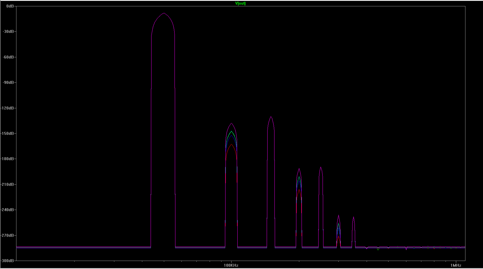

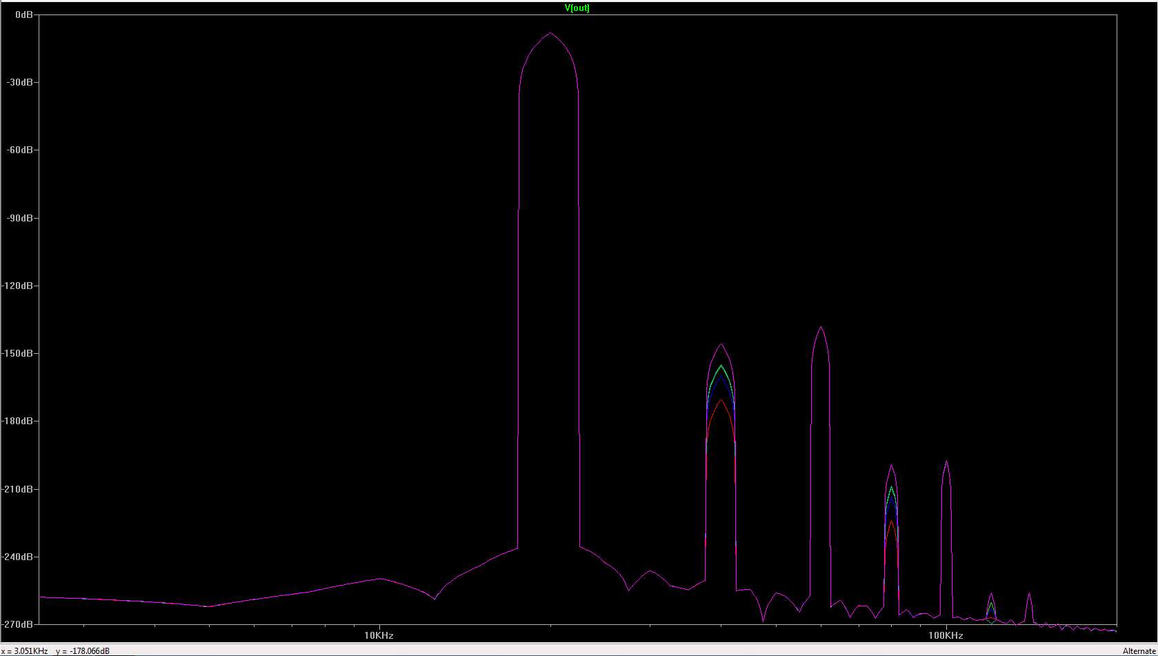

To add a few pictures, the LME49990 at 20 and 50Khz 1V(2Vpp) input. The input offset is stepped 1, 2, 5 and 10V (Green, Blue, Red and Azure).
The gain has to be adjust (I think) (to get Vin equals Vout).
