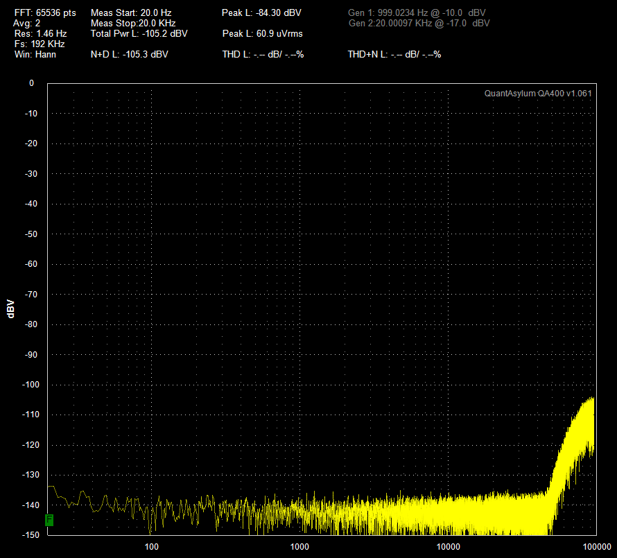

Nice feedback from QA. Notice their caution about noise.
" Note the QA400 has a noise bump that starts just below 50K (attached picture shows no-input ADC noise floor). This is characteristic of most all sigma-delta ADCs. This may or may not interfere with your desired IM measurements. "
I want one, no question. I just need to find an excuse to get one. They do caution they use unique IO and data formats so they are not suitable for use on other software. That is part of why they can get the performance they show.
