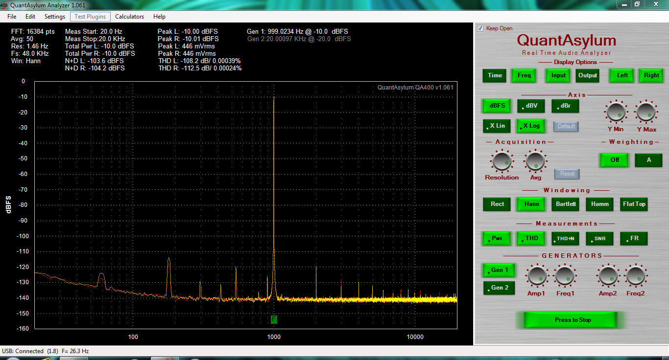

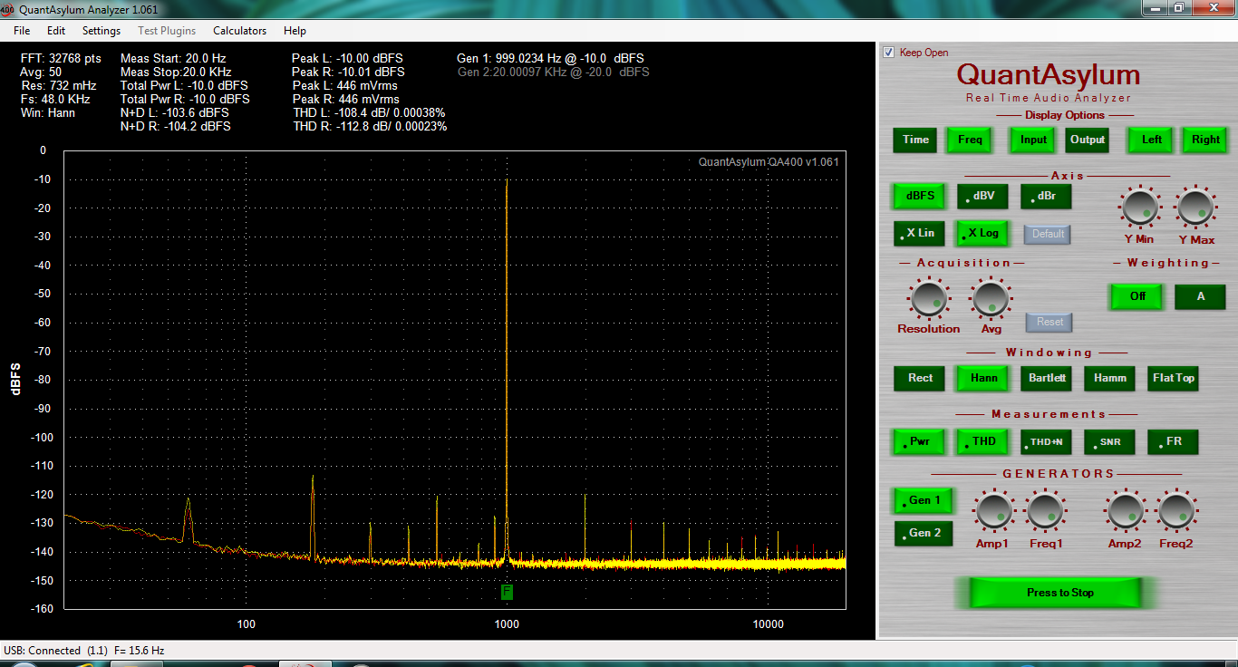

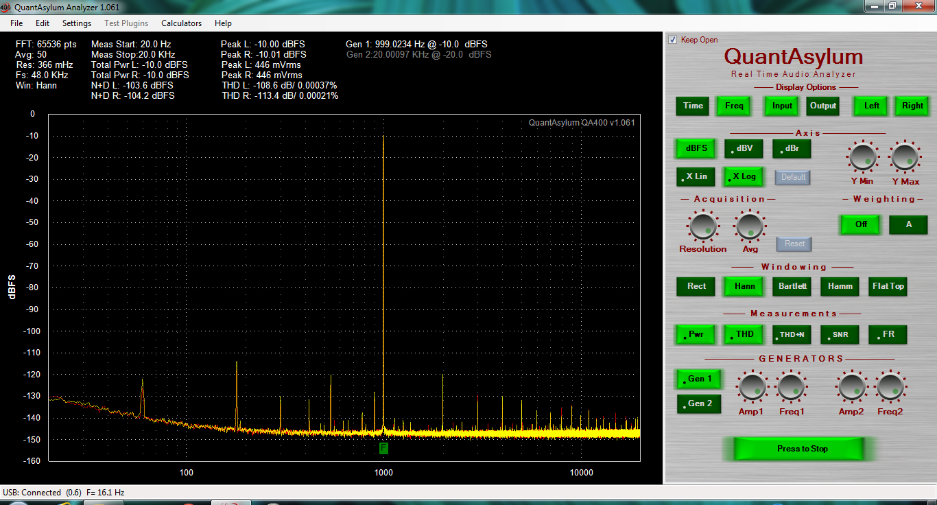

I have a question about the QA400's channel matching:
Can anyone tell me if it's normal to have several dB discrepancy between the Left and Right channel THD readings in loopback mode?
See pics attached - notice the discrepancy grows as the FFT length is increased.

In the closed system of the QA400 it doesn't see the out of band stuff. However it does see the ground currents etc. The reason for the interface I'm working on is to deal with the noise currents. I went over some of this at the beginning of the thread.
I am still working on gen 2 that addresses some dynamic range issues to better match to how this is used.
Meanwhile, try a cliplead from the PC to the chassis of the box you are testing. Give the ground noise currents a separate path.
