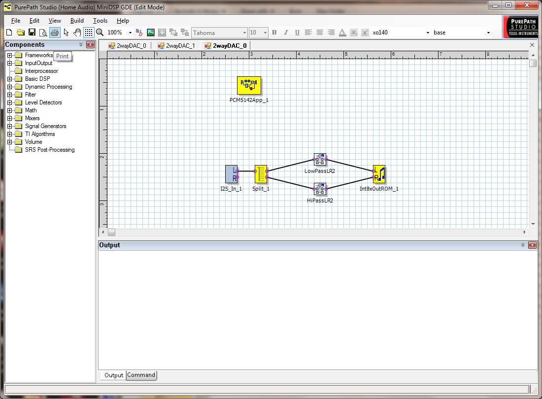

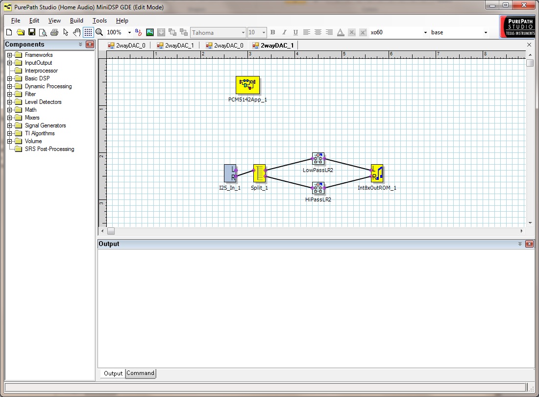

Piano Firmware 2.2-7 - FAST/WAW 2way using LR2
This replacement 2.2 firmware is for implementing FAST or WAW configurations where a woofer and a full range are used together. These XO points are higher than used for a subwoofer [60..200] but lower than used for a tweeter [1000-3000]. So This addition sets the XO at [200-1000] using a modest 2nd order filter (LR2).
The mapping between the Volumio menu and actual XO is:
Code:
- to select the XO point using Volumio mode 2.2 settings using this cross ref
		- mode2.2 sel -> XO freq
		- 60 -> 200 Hz
		- 70 -> 250 Hz
		- 80 -> 300 Hz
		- 90 -> 350 Hz
		- 100 -> 400 Hz
		- 110 -> 450 Hz
		- 120 -> 500 Hz
		- 130 -> 550 Hz
		- 140 -> 600 Hz
		- 150 -> 650 Hz
		- 160 -> 700 Hz
		- 170 -> 750 Hz
		- 180 -> 800 Hz
		- 190 -> 900 Hz
		- 200 -> 1000 Hz
The schematic, readme, projects files and the firmware (2.2-7) are listed below.

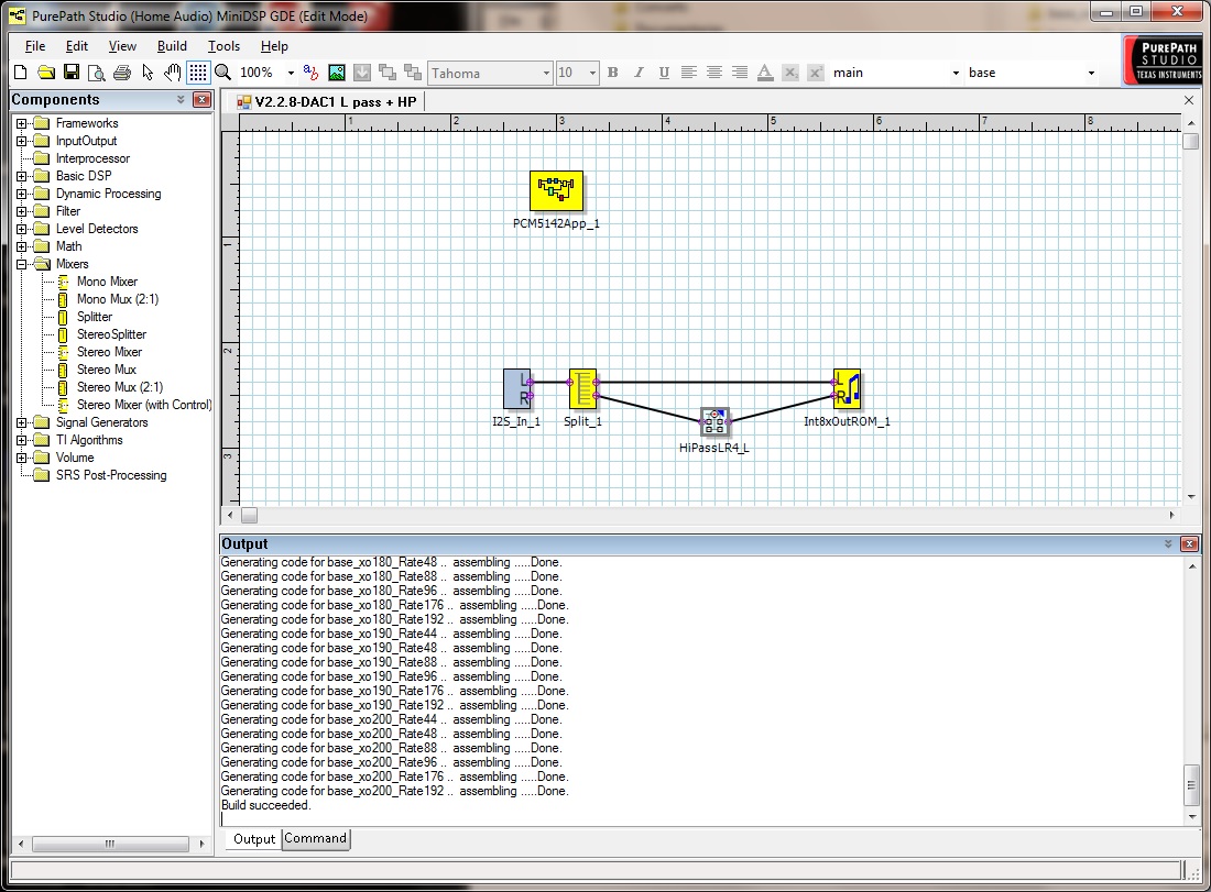

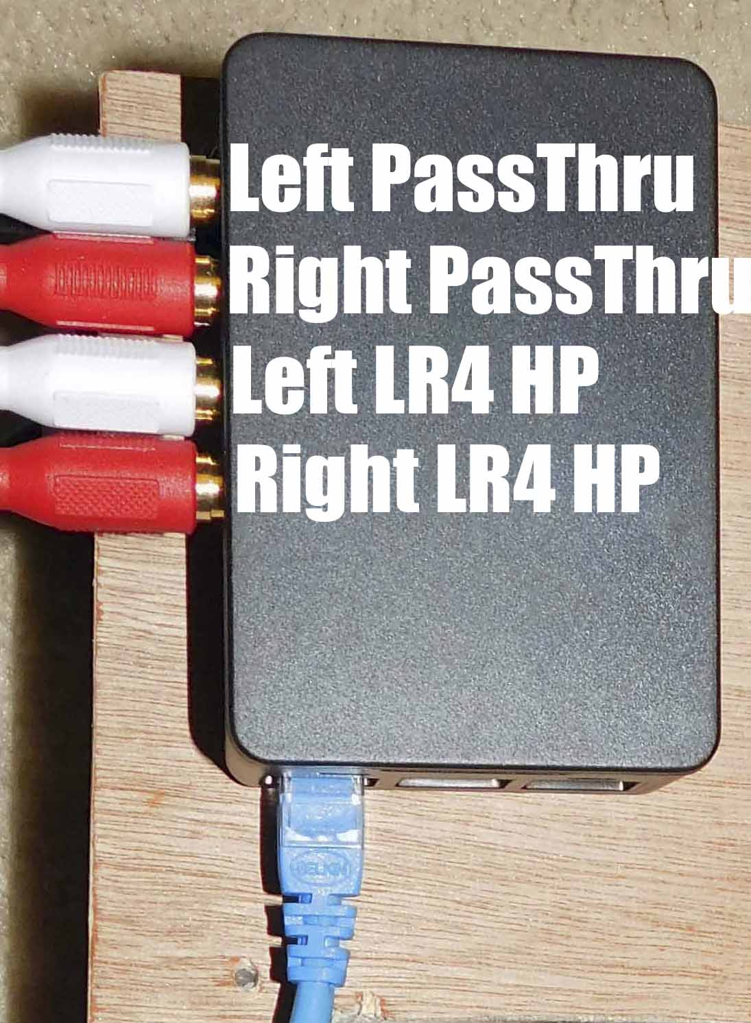

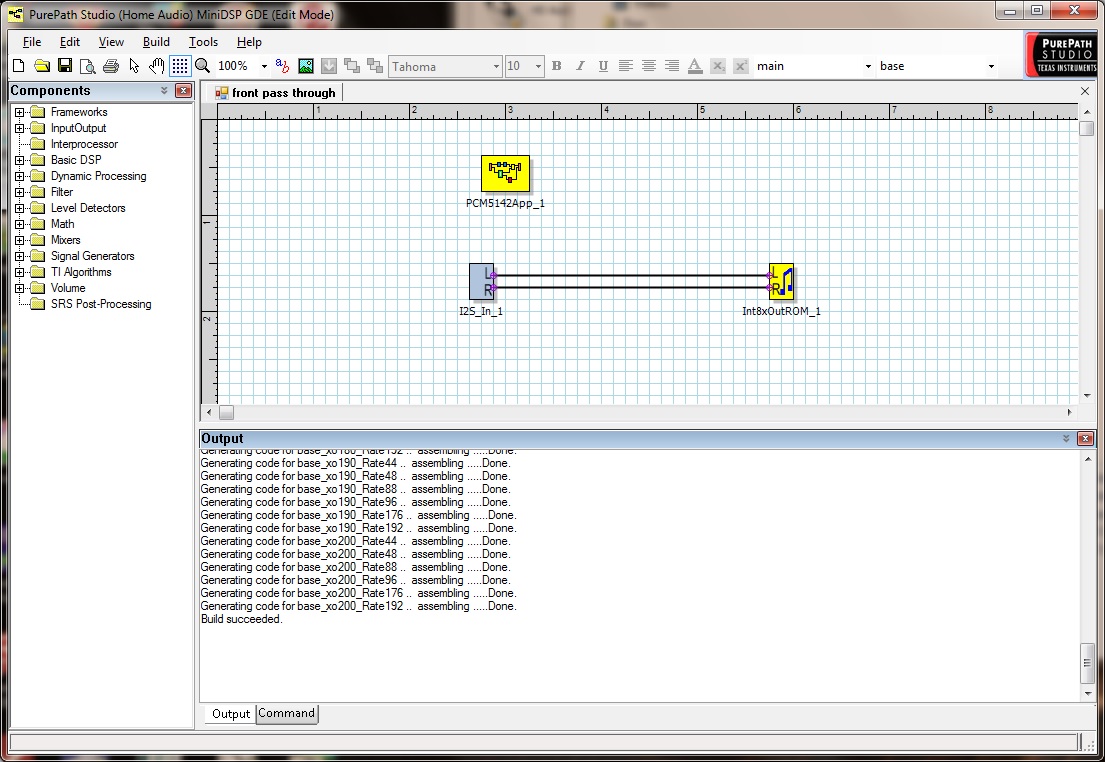

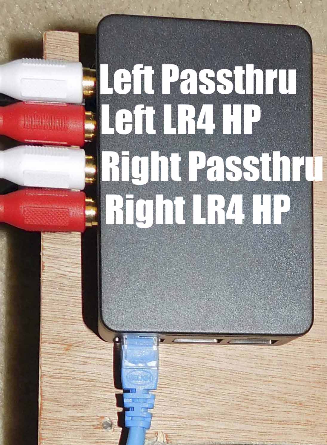

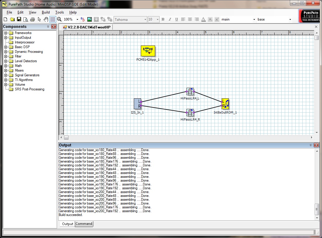

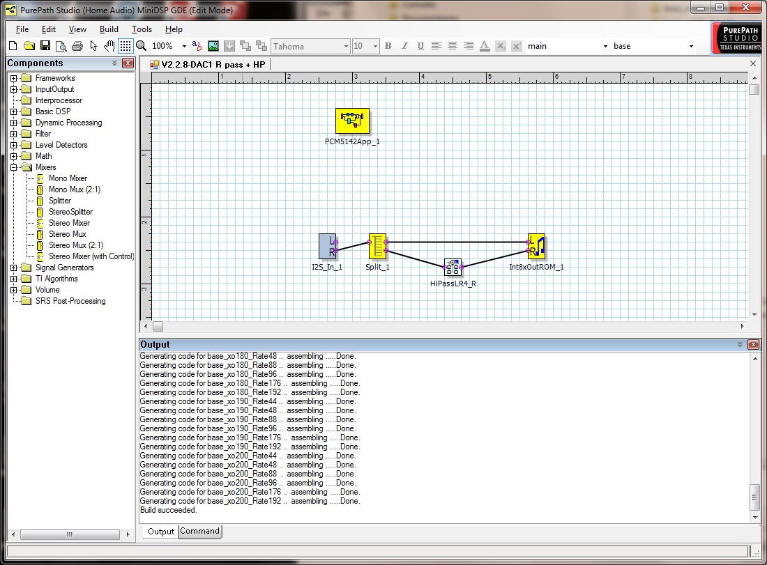

Firmware 2.2.8 - DAC0 passthrough, DAC1 LR4 HP
For @ngfy, try this firmware.
DAC#0 is L+R pass through and DAC#1 is L+R LR4 HP with XO points listed in the table. Firmware 2.2.8 has been added to the index in post#1.
Code:
		- 60 -> 1000 Hz
		- 70 -> 1100 Hz
		- 80 -> 1200 Hz
		- 90 -> 1300 Hz
		- 100 -> 1400 Hz
		- 110 -> 1500 Hz
		- 120 -> 1600 Hz
		- 130 -> 1700 Hz
		- 140 -> 1800 Hz
		- 150 -> 2000 Hz
		- 160 -> 2200 Hz
		- 170 -> 2400 Hz
		- 180 -> 2600 Hz
		- 190 -> 2800 Hz
		- 200 -> 3000 Hz
  • TI PP Projs.zip
    TI PP Projs.zip
  • firmware 2.2.8.zip
    firmware 2.2.8.zip
@ngfy, reverb requires a delay of 10's of ms. This may be from a very large room or a differential path delay (usb vs wifi). I don't know what you are using as a media player on the RPI but it too could have introduced a delay large enough to cause reverb.

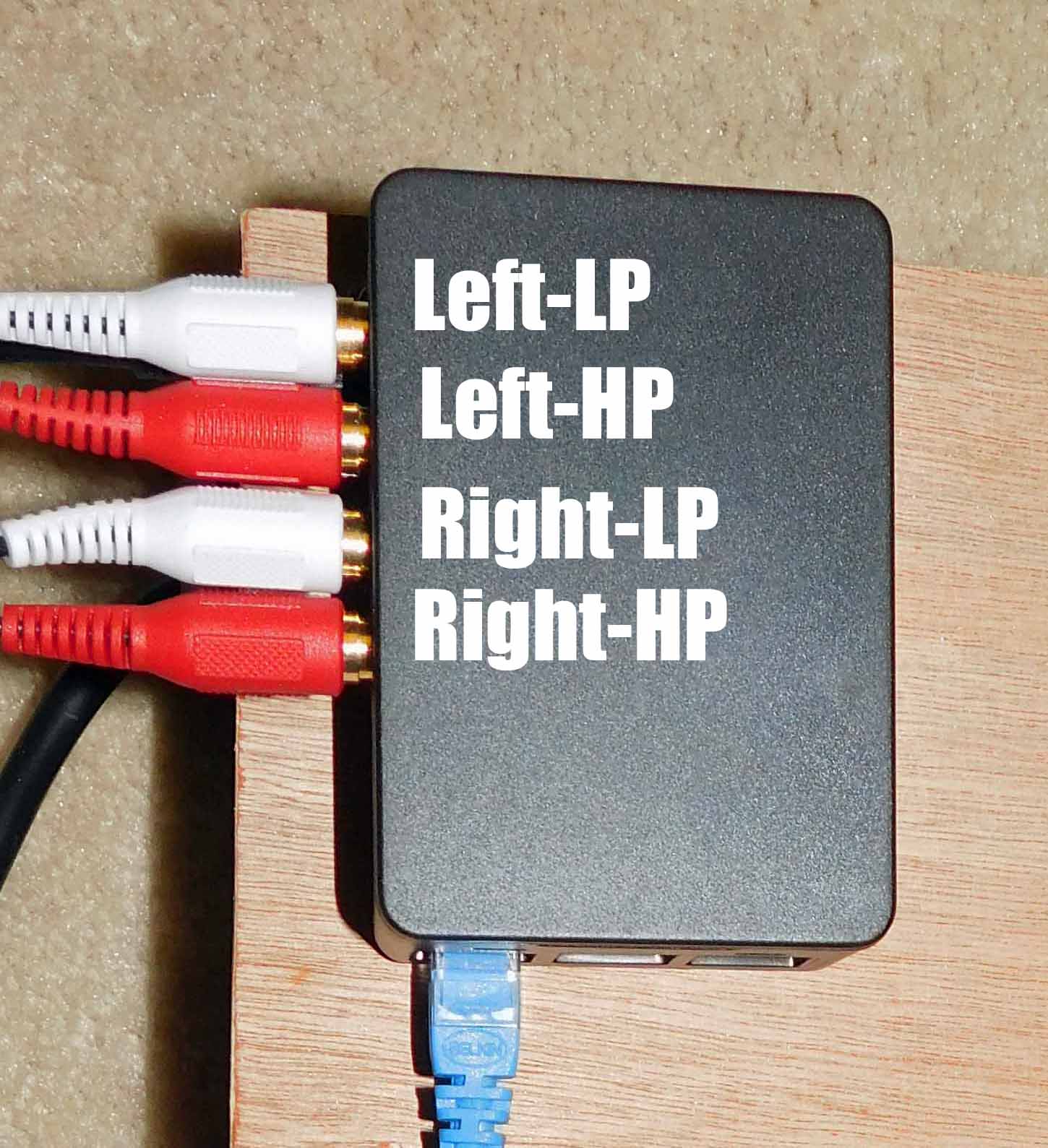

Here is an alternate pin out for you to try. The XO table is the same as before.
  • firmware 2.2.8b.zip
    firmware 2.2.8b.zip
  • TI PP Projs 2.2.8b.zip
The new firmware sounds great and the reverb is minimal in the highest registers. It seems to me that the delay was due to two DACs.
I use Volumio in the version with the 2.2 system working properly (2.457). Once again, BIG thanks!
