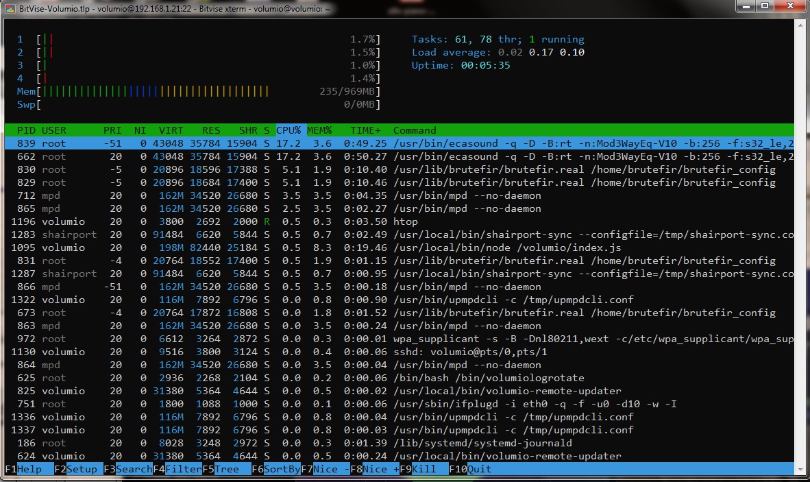

I use a USB mic (UMIK-1) and REW to measure the outputs. The setup is posted at Raspberry Pi with Piano2.1 DAC DSP and Volumio2
I have another SD card with Raspbian and REW installed. You can include Ecasound and Brutefir if you want, or just the embedded DSP. In either case its always worthwhile to measure the results.

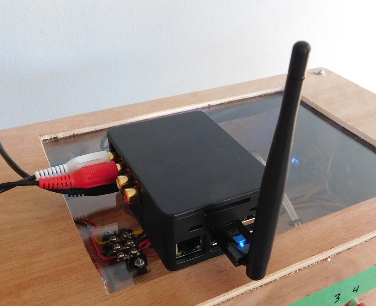

Yes, the Rpi configuration I use is a more complex setup than a purpose built device (aka minidsp). I wanted a networked player solution that could do more DSP including convolution.
If you keep the H/W there's always the option of trying it again in the future.

Ecasound and Brutefir changes
I still run Ecasound and Brutefir underneath Volumio V2.834 and I've made a few configuration changes. This is a summary of what was done.
The Piano2.1 HAT covers the tiny RPI board WiFi antenna and limits its range and speed. So it was replaced by a WiFi dongle with 3.5dBi antenna. These are cheap (<$20), have great range and provide 300Mbps (radio connection) which is enough for my needs.
I now keep the Piano2.1 as card#2 so Volumio's controls are unaffected. The loopback card# for Ecasound and Brutefir are now placed after the Piano2.1. I use Volumio's NAS library, Spotify and Webradio. I ended up sampling at 44K1 because I could not get the Spotify daemon to accept a rate change even through it uses SOX. I prefer 48K because it has lower jitter on the RPI.
Ecasound is running 12 * IIR PEQ's that do minor adjustments to flatten the FR. Brutefir runs a 1K tap phase correction to make the LR4 XO min phase. The CPU runs at 58C in a closed plastic box and the load is shown in the pic below.
The Raspbian configuration changes are :
The additional tools required are :
