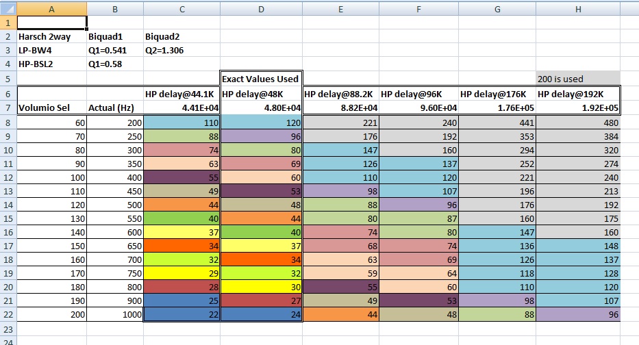

The delay #samples would vary with both fc and sampling rate. A complete filter data set (all XO points at all sample rates) may not be possible because the #samples would get large when the sample rate increases and fc decreases. I'll have a look to see whats possible.
Piano Firmware 2.2-9 -> Harsch XO for FAST/WAW

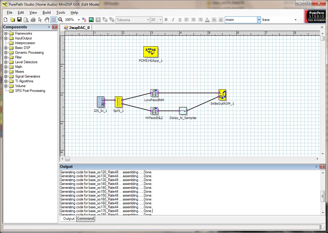

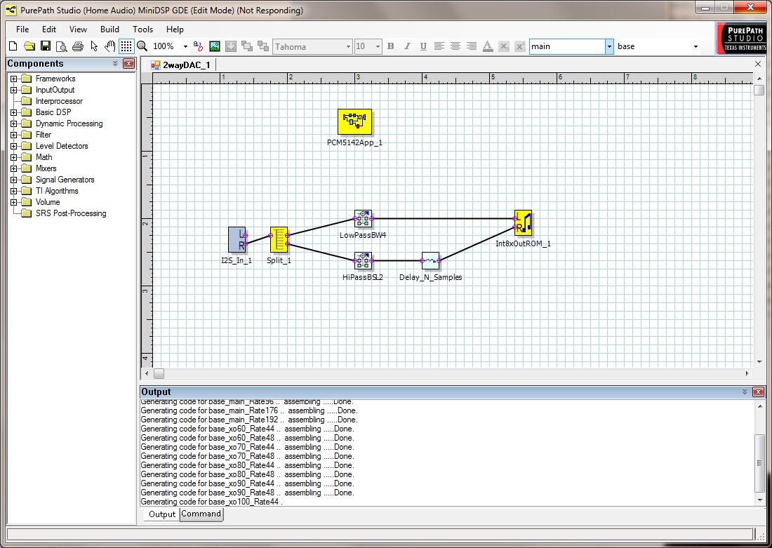

I implemented a Harsch filter for a 2 way, with XO points typically used in FAST / WAW systems (eg. woofer + fullrange)
The LP-BW4 and HP-BSL2 are straight forward to implement and TI_PP supports "configurations" to automatically generate the coefficients for all the required sample rates. The DAC DSP also has local memory that can be used for implementing a delay line. The delay block can store 600 samples (@32bit) using this memory. That's enough to create the delays required for this Harsch implementation down to XO@200Hz with sample rate 192Khz. So a full filter data set, for all XO and sample freq, is possible. One issue is the way TI_PP treats the delay as "constant value" for all configurations and it's value can only be changed in the "main" configuration. So if you want exact delays for every configuration (XO+sample freq) you would need to recompile for each delay value change (via main).
The table below lists the delays (in #samples) that are required for each sample freq and XO freq. I generated exact delay configurations (qty 15) for only the 48KHz sample rate set. The other sample rates have reused these 15 delay values to complete the data set and save me time 🙂. The table cell color indicates which delay value (see 48Khz column) were used, and the number in the cell indicates the exact value required. The project files are included if you want to regenerate them exactly for all sample freq or if you need to add a delay for your driver position offsets. If you just want to try it, the 48K sample rate has the most accurate implementation. I've done some limited testing with it.

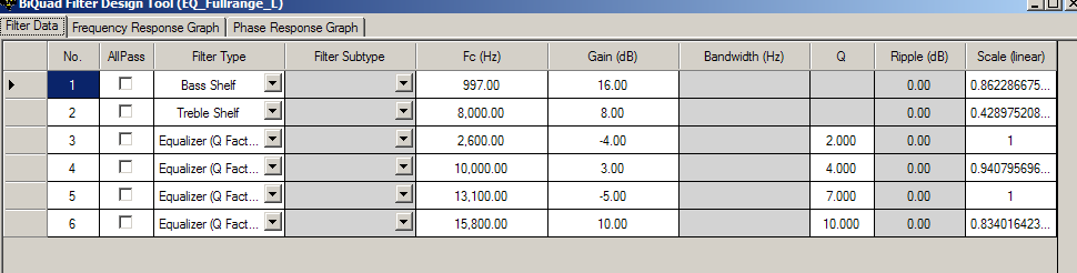

2. When working with the BiQuad block, do you know why/when the "scale" column kicks in? It seems to be setting those values automatically, and it's changing the parameters I aim to set. For example, that #2 in this screenshot doesn't seem to give me the full 8db because of that scale... so I can't set up what I'm trying to do, unless I don't understand how it works (which is likely).
The scaling is actually gain applied to the BiQuad. If you view it in the frequency tab you can see the vertical gain shift. You can only scale down in a BiQuad. The EQ blocks are set automatically based on the Q.
