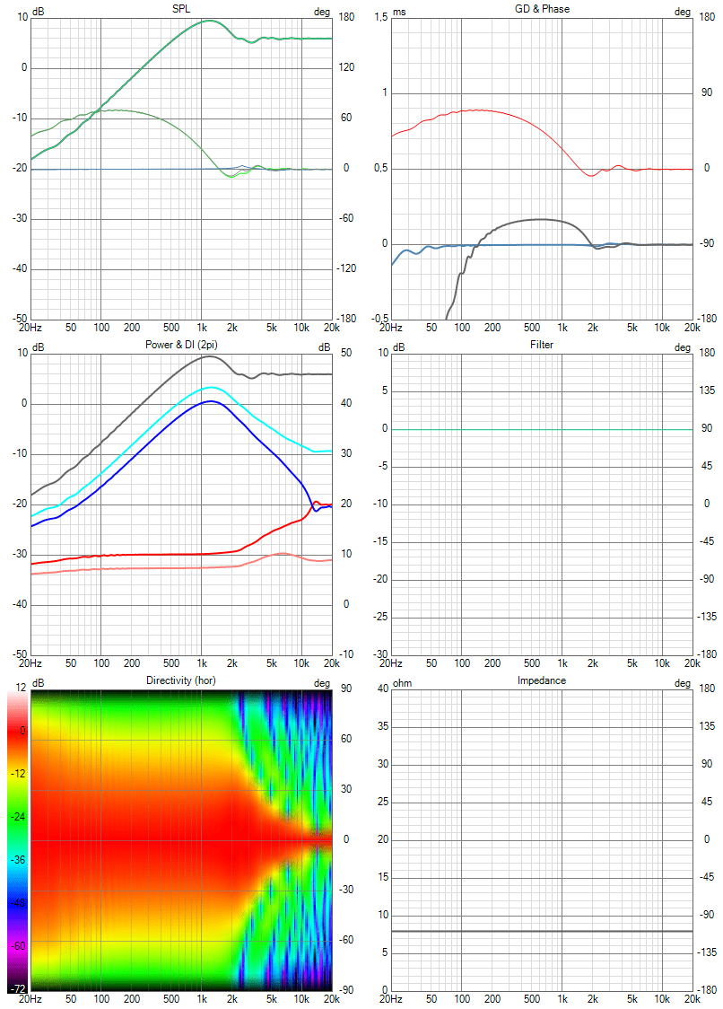

You can check it out in VituixCAD diffraction tool, kinda, just use the ideal driver (don't load any response) and tick "open baffle". Passive cardioid loses the low end similarly as open baffle so we use the open baffle as analog here. You'll see that enlarging the baffle the response stays the same only moves down in frequency. There is the "main diffraction hump" which relates to baffle size and below that smooth rolloff. Above is not very usable due to diffraction so basically baffle size defines the upper end of usable bandwidth and the low end is defined how much bass you can lose. This is why you want to use as big driver as possible, or conversely as small baffle as possible and choose woofer size that can be crossed over to a tweeter.

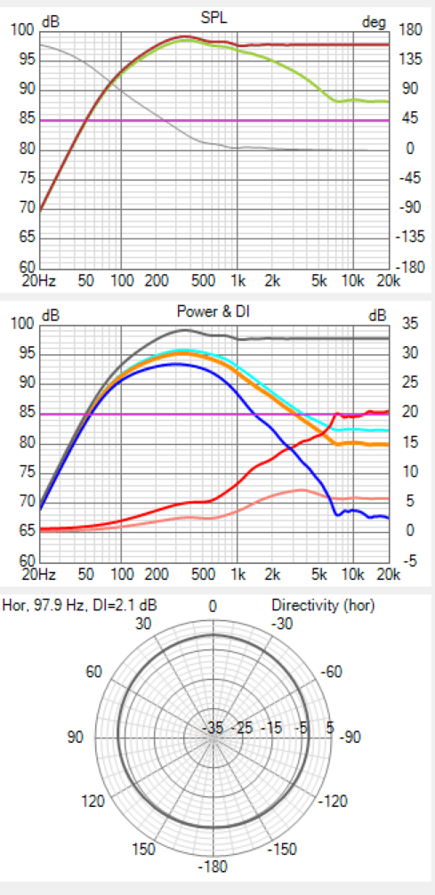

Here is example, ideal 8" driver on minimal 20cm x 20cm baffle, open baffle. You see the power response tops out bit above 1kHz and is downhill from there down, around 200Hz its about 12db down from the peak. If your woofer was rated 92db/1W/1m sensitive, after equalizing the response straight from 200Hz up you'd probably looking system with 80db/1W/1m sensitivity. You'd of course lose some on baffle step usually so not great loss, but something that limits the system sooner or later. You could use two in MTM configuration if you wanted more sensitive system.

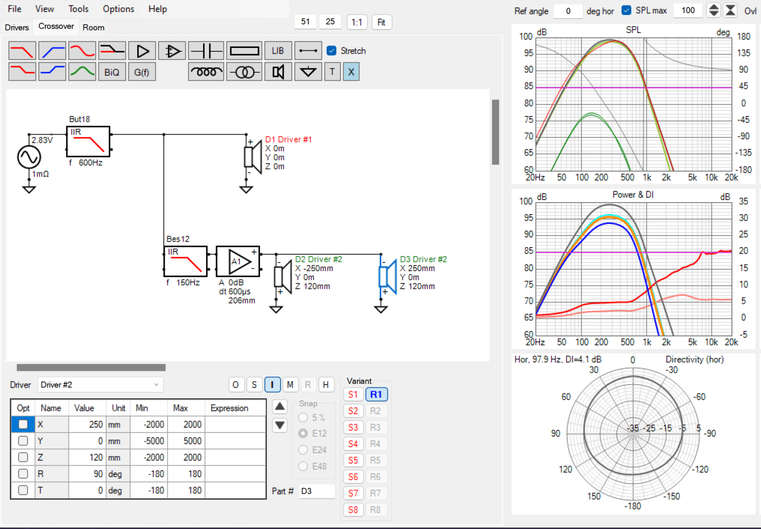

Now that I'm being eagerly spoonfed I might as well ask: since the SPL loss is a particular concern for small speakers, would it make more sense to go for active cardioid (delayed woofer in the rear) rather than passive? On the other hand, there'd be only about 5dB of open baffle loss at 200Hz - an MTM would give more of a benefit in SPL (if I'm not mistaken), and way more benefit below 200Hz if I manage to limit the cardioid action there. In my case it would have to be a TMM though, so perhaps a 2.5-way.

Yeah it gives a lot more control on the pattern if you actively manage the sound on the back. Look for posts by nc535, not remember which threads, but he posted some VituixCAD sims of active cardioid last year I think. You can do it too with VituixCAD, its not very complicated. ideal drivers with diffraction tool generated measurement sets, tweak them as if they were measurements of a real speaker you have in your mind. Then build and test if you get to a system with satisfactory results. MTM would give more system sensitivity, also if you mitigate edge diffraction you can just enlarge the baffle which by itself makes cardioidish response, "shadows" high frequencies to back.

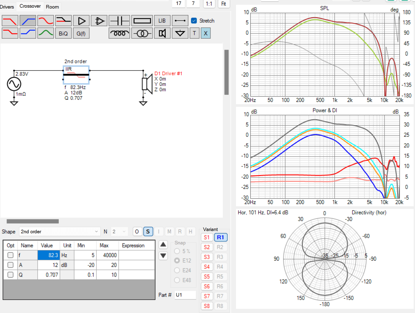

Cardioid = 1/2 monopole + 1/2 dipole
Making the dipole term requires lots of air to be moved around [assuming wide band operation], which has to pass 'through' the (front) woofer. Most of the woofers displacement is spent on creating this term. Therefore the principle that reduces SPL for a dipole, also applies to a cardioid, given a (front) woofer with a certain volume displacement.

An idealized open baffle doesn't have a loss straight ahead. There is an overall loss of about 8dB at 100Hz from the dipole peak which needs to be equalized.For example: compared to "normal" baffle, an open baffle in my case has around 8dB of reduction at 100Hz directly in front of the speaker. Using a rear woofer for the cancellation, there is no such loss. Even if we compare against two woofers in an open baffle, the setup loses by 2dB
An active cardioid gives more freedom to choose the lowpass and delay and in this example there is still 10dB difference between front and rear at about 100Hz.
This is the same driver without the processing and active side woofers, the baffle size gives some cardioid like response to 300Hz
What do you mean by "idealized"? I'm just getting more confused here. If you use the diffraction tool and untick "open baffle", there's an increase in the bass response straight ahead. How is there then no loss in the OB straight ahead?An idealized open baffle doesn't have a loss straight ahead. There is an overall loss of about 8dB at 100Hz from the dipole peak which needs to be equalized.
