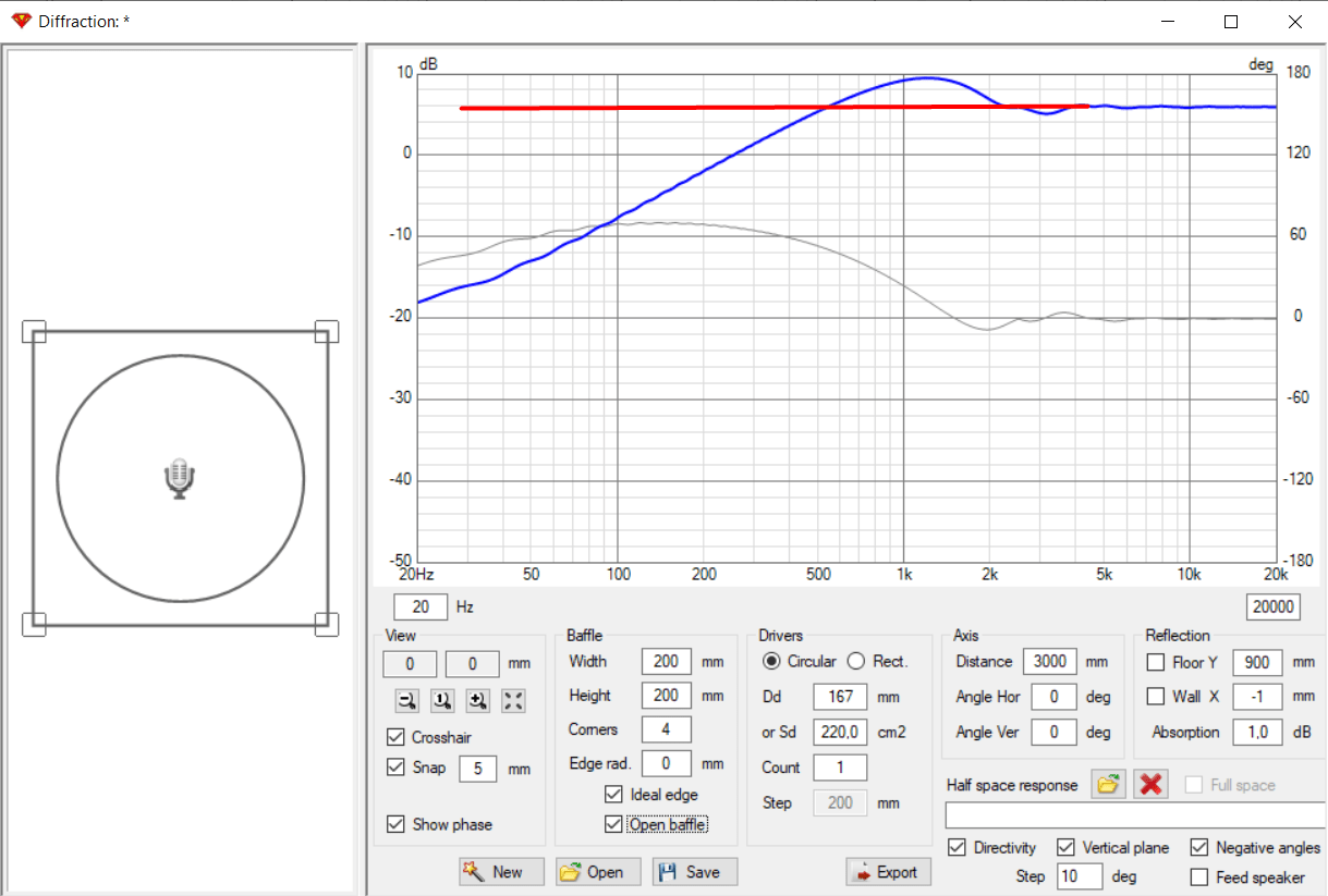

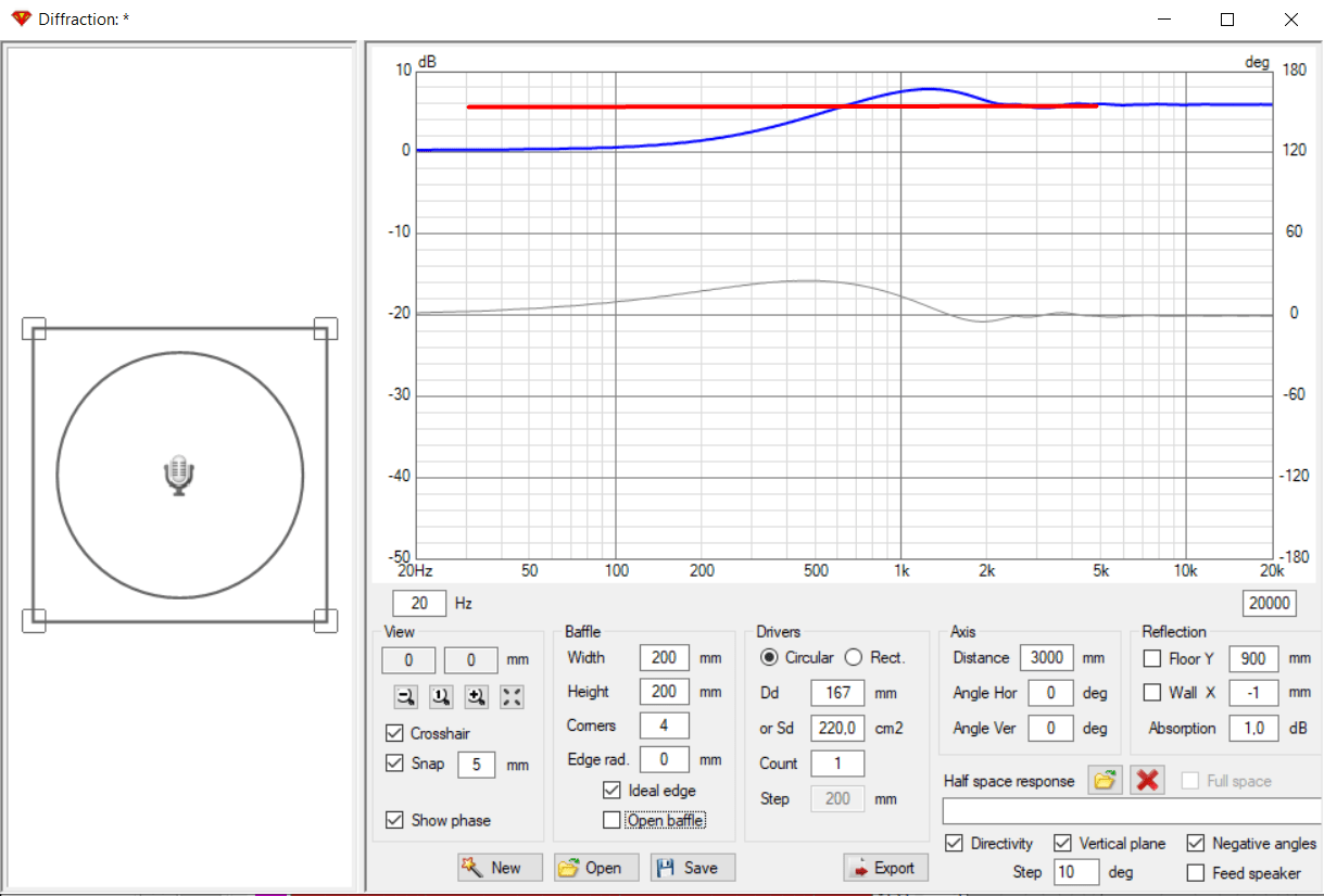

What do you mean by "idealized"? I'm just getting more confused here.
Idealizized means using Vituix to simulate a Dipole using the piston diameter in the diffraction tool with the Open Baffle box checked.
If you use the diffraction tool and untick "open baffle", there's an increase in the bass response straight ahead. How is there then no loss in the OB straight ahead?
The maximum output will always be straight in front of the driver in any configuration, a dipole will have nulls at the 90 degree points and a cardioid will have the greatest rejection at the rear, in between those two the cancellation moves around. Unticking Open baffle will just simulate an ordinary box speaker baffle diffraction.
Yes, but the dipole will have less low frequency output straight ahead than an ordinary box. An active cardioid is an ordinary box except for the rear radiation, so the output straight ahead is not affected (assuming no reinforcement from reflections), right?
Straight ahead is the part that makes no sense. An equalized dipole that does not use a huge baffle will have less output all over at low frequencies than a box speaker using the same driver. But whatever output there is will always be concentrated in the forward and rearward directions. The polar plot shown before of the dipole shows that.
So, why would an active cardioid (box speaker without rear radiation) not allow more LF output than a passive cardioid (open baffle in LF magnitude)?

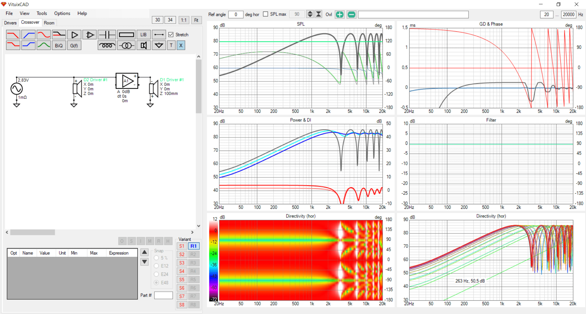

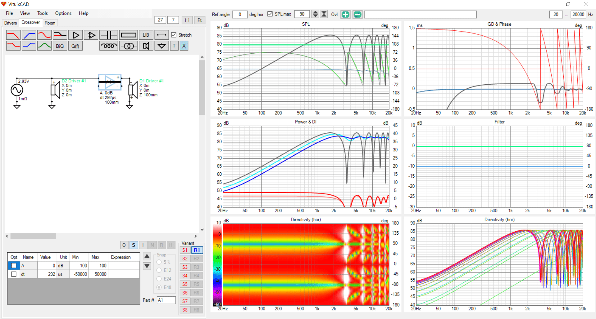

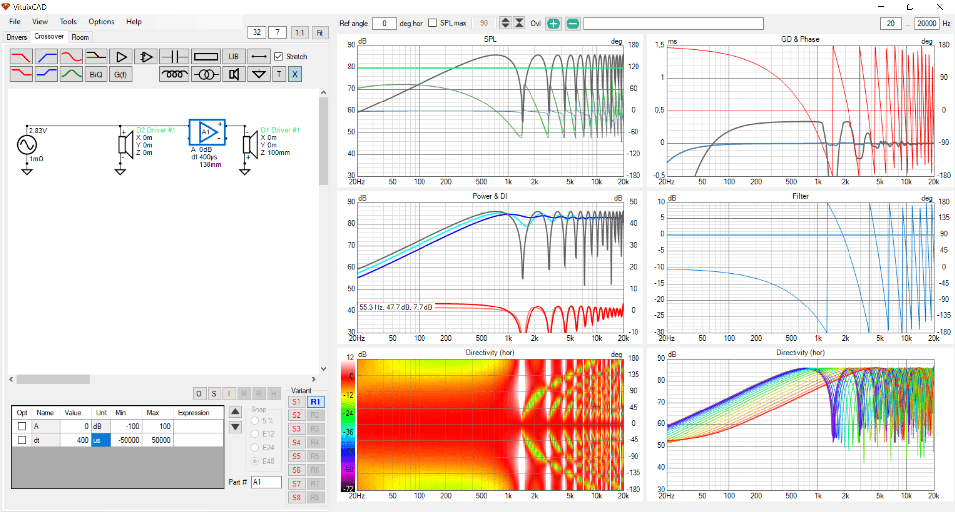

both dipole and cardioid are first order gradient systems, can be made from two monopoles. This is nice and quick experiment to do in VituixCAD since it has ideal monopoles available (driver with no data loaded to it).
One of the monopoles is inverted and some distance (d) between them and dipole pattern emerges, nulls to 90 degree off-axis below "dipole null" which happens when wavelength is d. Here d is 0.1m so null happens at 3430Hz.
If the other monopole is delayed the nulls start to turn to bigger angle than the 90 degrees and when delay equals d you have cardioid.
Increase delay further and there is more lows but the attenuation is worse, called subcardioid or something. Usable bandwidth stays about the same, there is always the "peak" below which the power just cancels out 6db per octave.
So, difference between dipole and cardioid is that the cardioid has some delay added to the "backside" signal. In reality "backside" can be provided from backside of single driver, or with another driver if both are boxed and approximate monopoles.

Dipoles and cardioids can be "tuned" to have nulling freq higher or lower, and below this cancellation we loose 6dB/oct of spl. Only difference between dipole and cardioid is the radiation pattern.
If the construcion has sort of asymmetric/aperiodic feature, restricted radiation from the backside opposite phase or somehow modified spectrum of it, radiation pattern and total spl might be higher than an open system has. DSP and multiple drivers make this rather easy to accomplish. I haven't seen this kind of tests, but there might be some practical benefits with it. PA cardioid woofer systems are closely related.

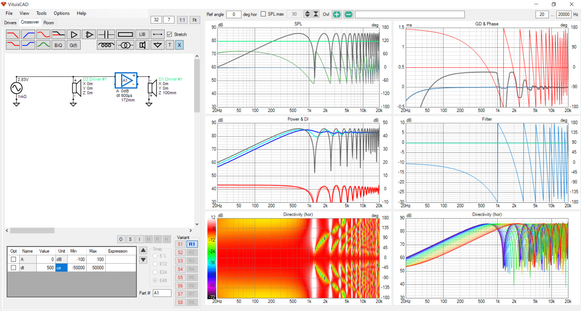

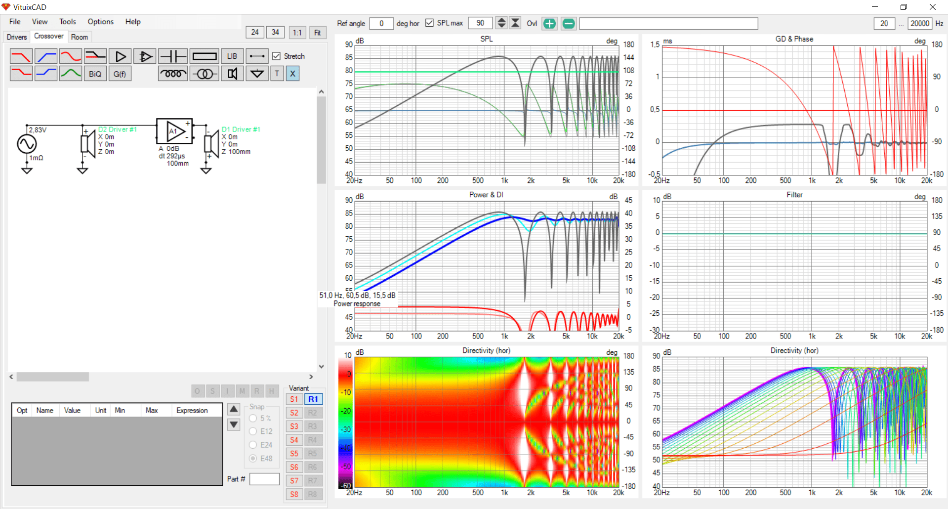

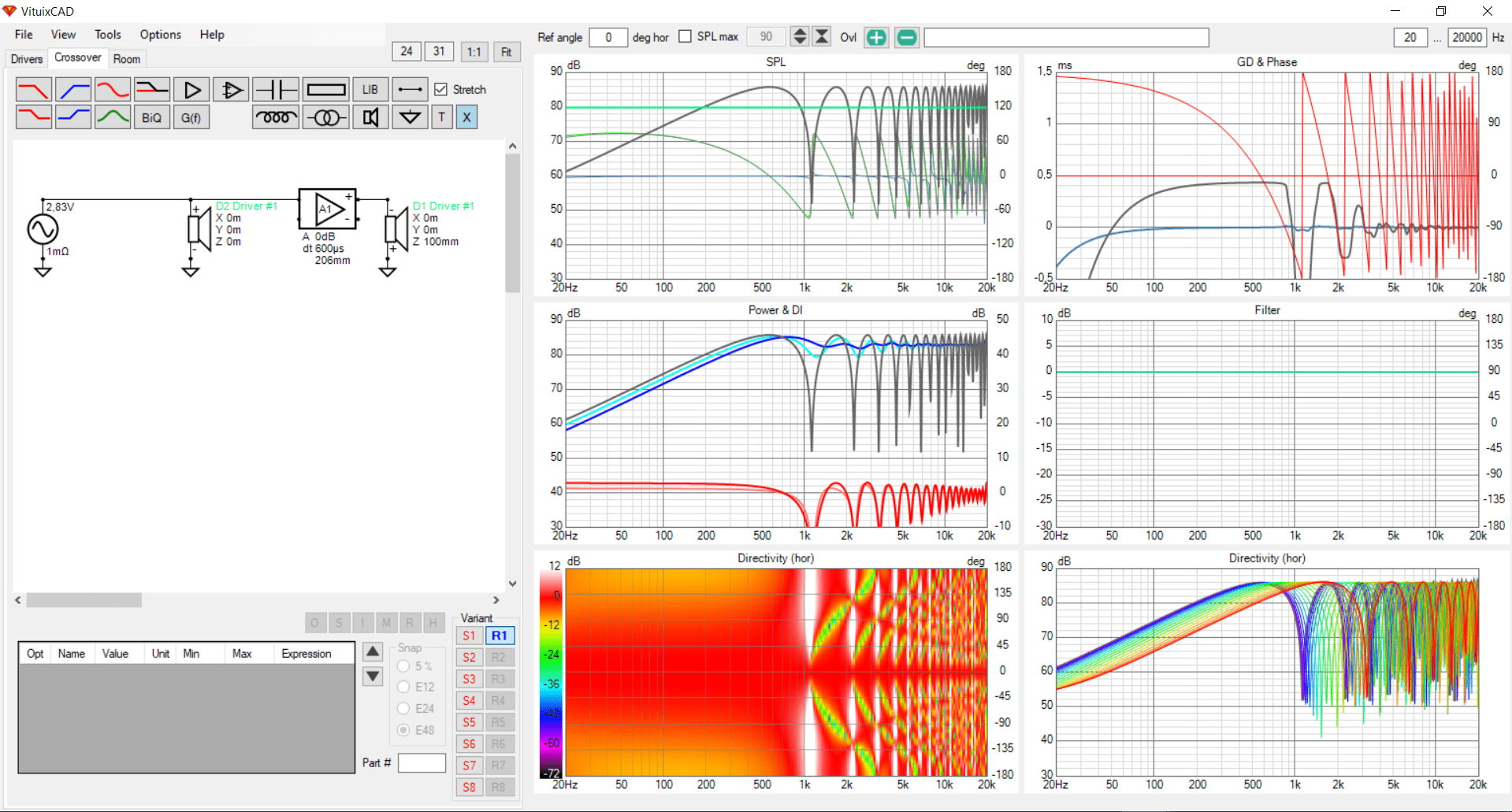

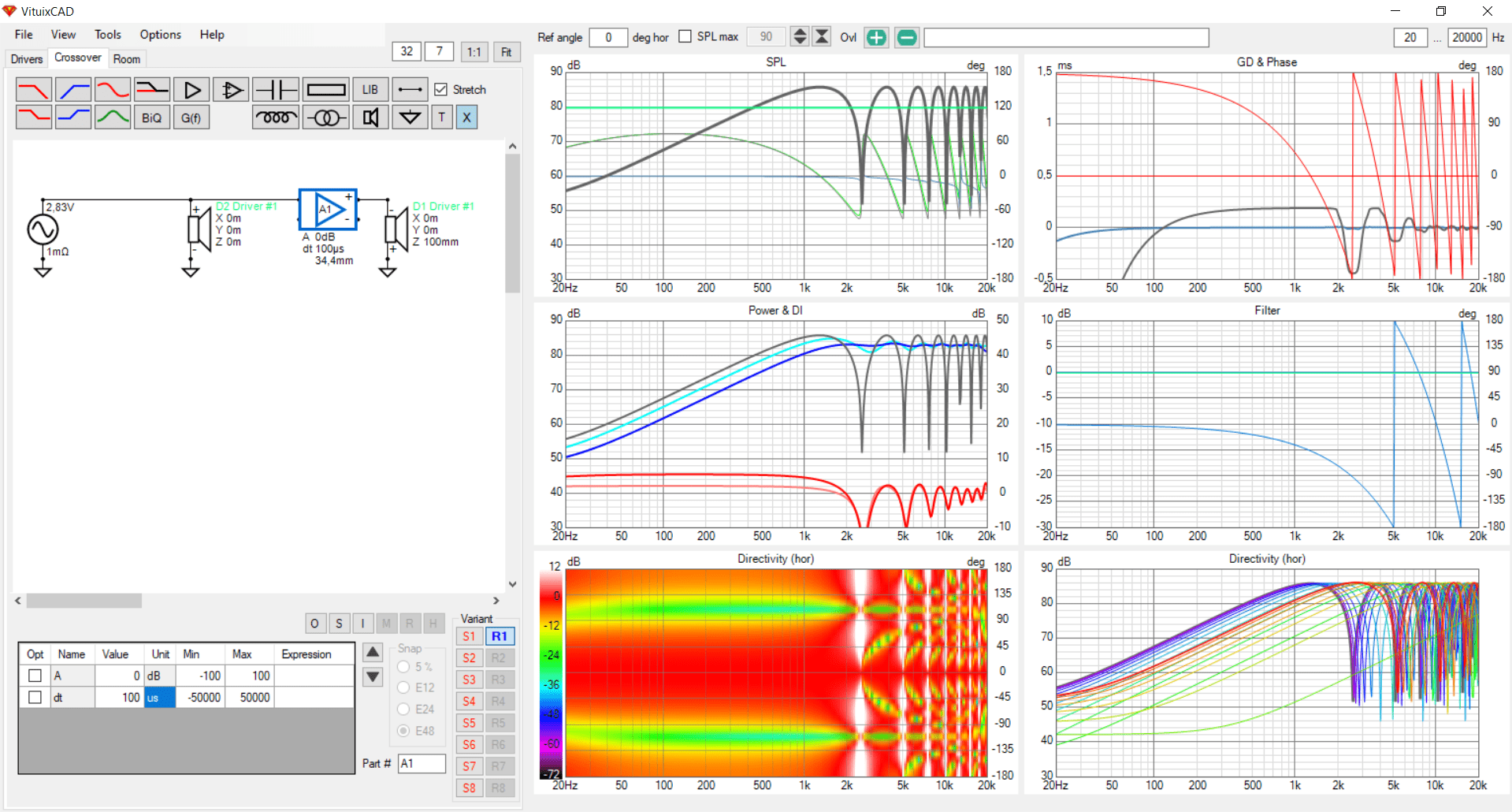

ideal dipole

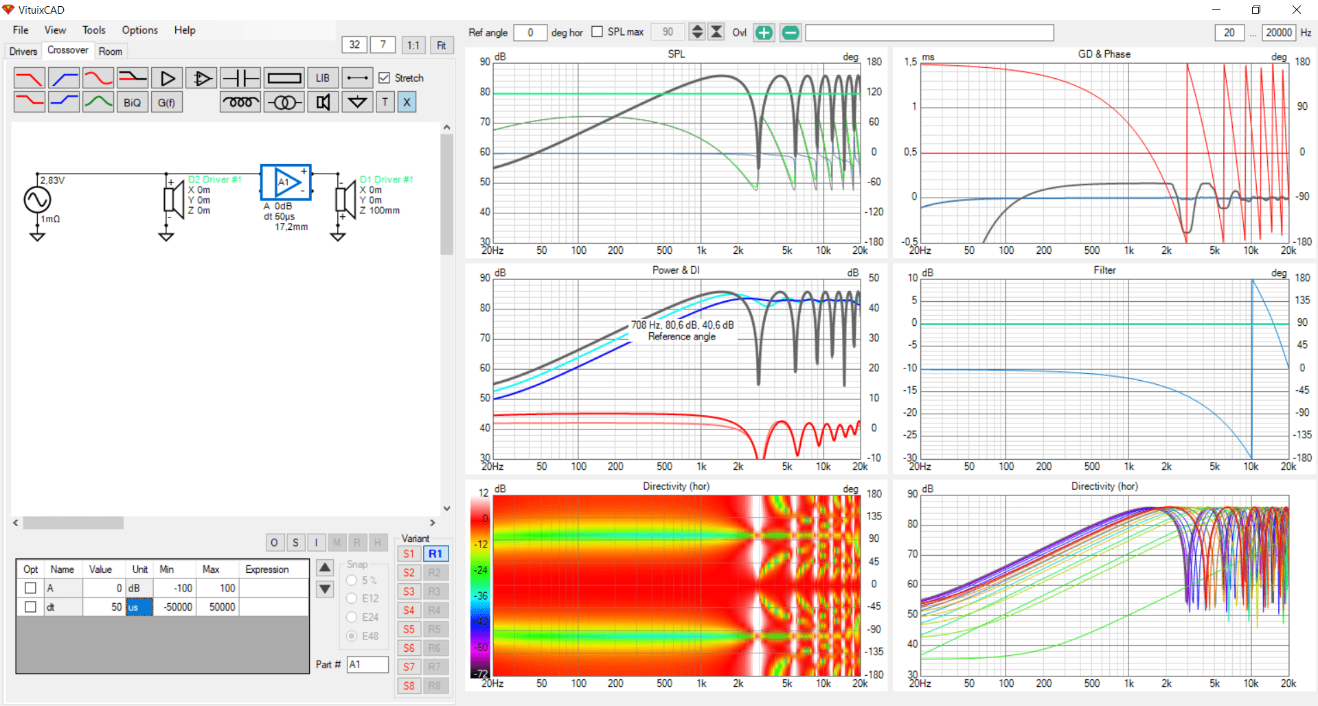

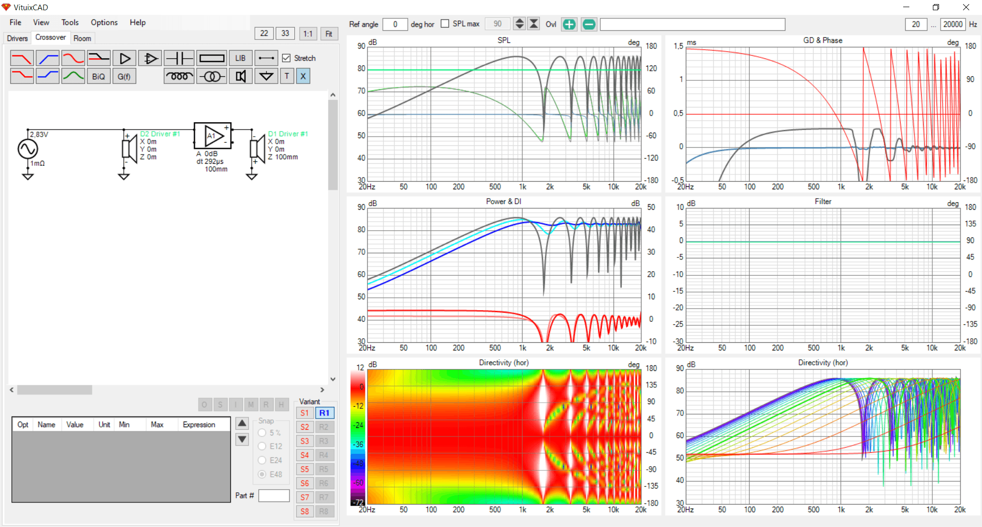

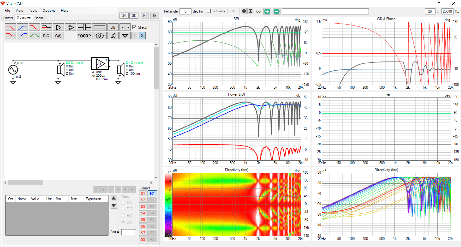

Ideal cardioid below. I'm using two ideal monopole drivers on this emulation/simulation, in reality the other driver could be driver on a box whose radiation is ~omni, or resistive vent(s) whose radiation is ~omni, for similar results. Added delay boosts the bass toward listener compared to dipole but at the same time the usable bandwidth brought down, it is limited on the top with the diffraction / interference that comes down as well with the delay so basically the usable bandwidth is still the same but now tad lower in frequency.

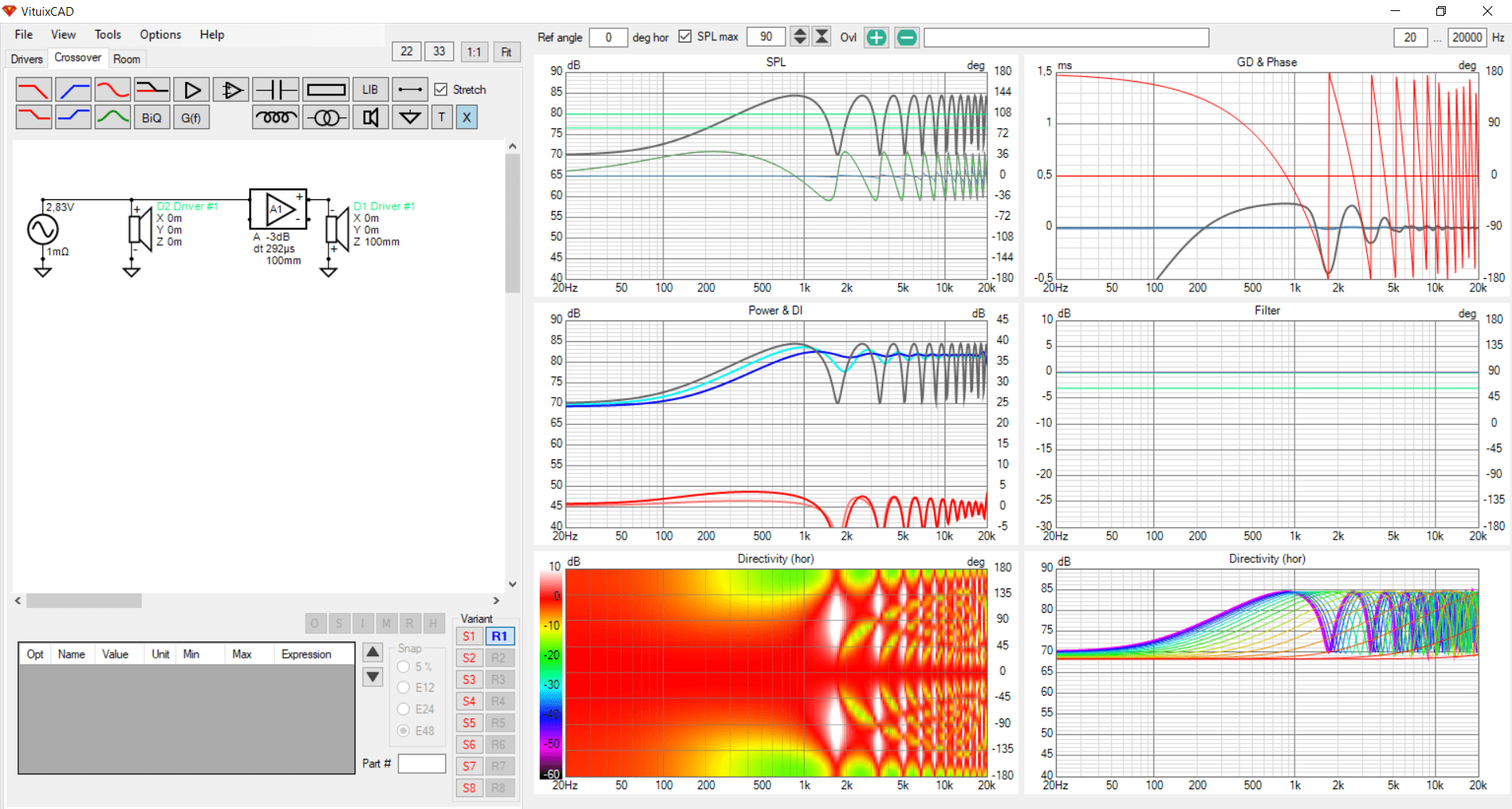

One could play with levels to affect the pattern, if backside is attenuated some the pattern is less good but more bass, less cancellation. In active configuration its easy to adjustments like this. Perhaps passive can do some attenuation as well with suitable damping material.

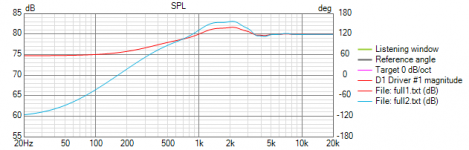

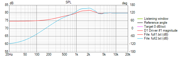

I'm curious where and how you get the data, are you emulating in VituixCAD? Dare to post screenshots? I'm not sure I understand what you are getting at?😀
No real simulations, just playing with the diffraction tool. Pic compares an open and a closed 5.5" wide baffle for an ideal 4" driver. If you then consider that a second woofer would add 6dB, the designs would cross around 150Hz, right? Below that, the open baffle "loss" is larger than the gain from a second woofer

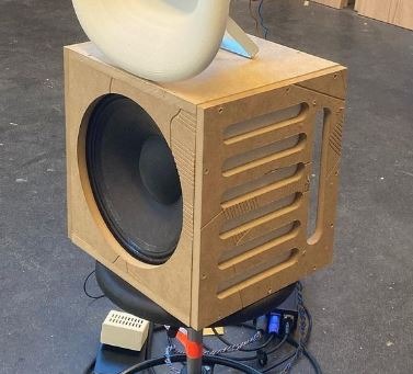

Hey there folks,

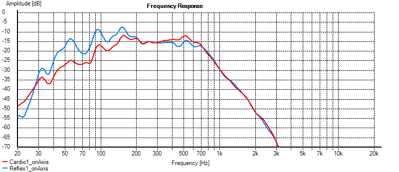

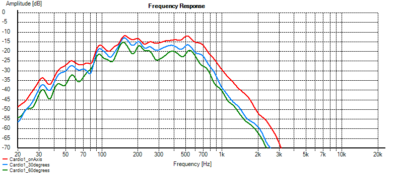

Here is my attempt on a passive cardioid.
On the following graph is a comparison between two boxes of similar size using a 12" driver
The baffle is 35x35cm. Both are measured at same level and at the same place in the room.
Blue is a bass reflex, red is a passive cardioid.
As can be seen from the plot - the reflex has more output, but suffers more from the back wall reflections.

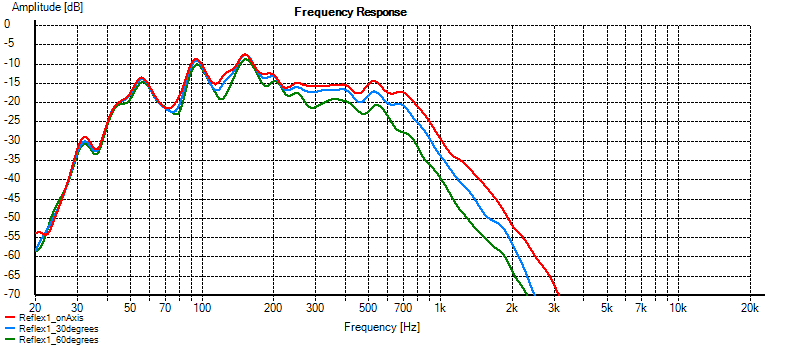

Here are the 0,30 and 60 degree measurements of both boxes.
So by comparison it's obvious that the concept works quite well.
Some tweaking is needed tho.
There is almost no cancellation at 150hz and a bunch of cancellation below 100 that I essentially don't need.
Any ideas what causes the pattern to collapse at a speciffic frequency?
And here is the DUT:
