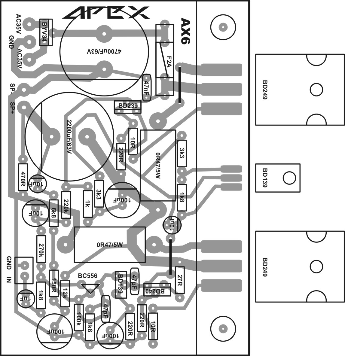

Willy please correct 10uF polarity on this pcb also 25mm diametar caps will be nice![]()
dear sir,
can i use byv32 in place of byv36 because it is not availabe in my town.thanks

Yes, use any TO220 dual diode.

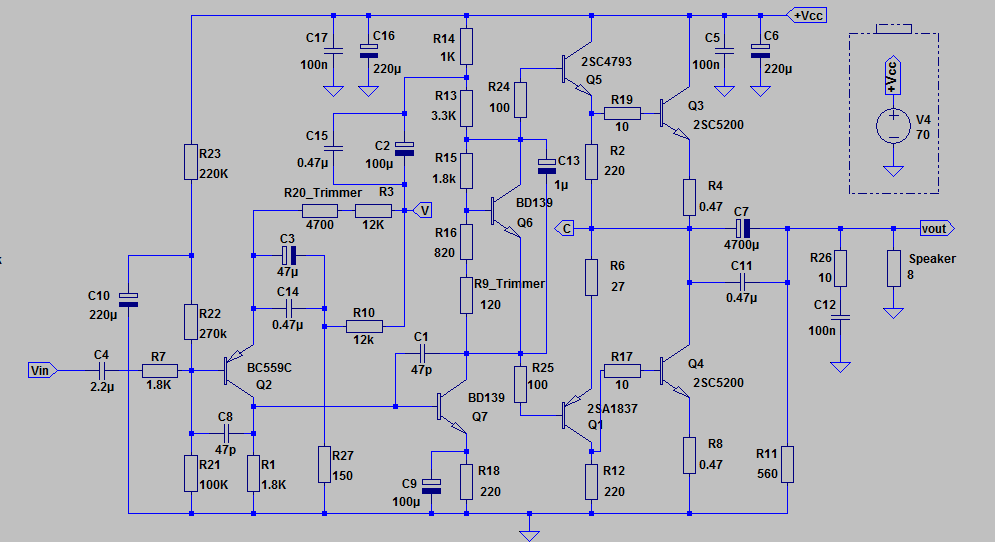

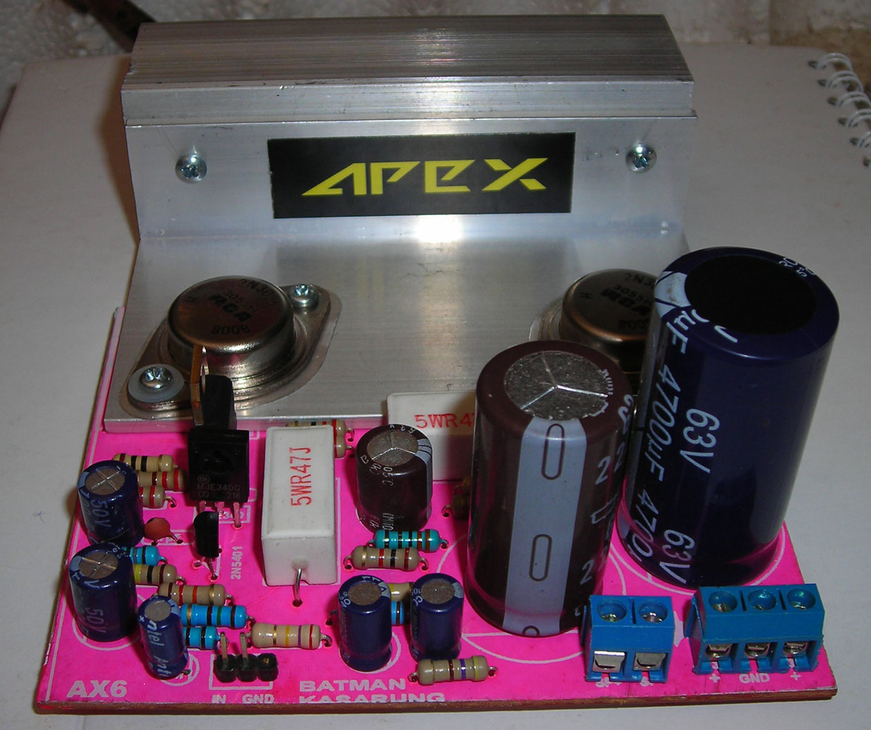

I will report my progress. i modified your circuit as proposed in post #138 http://www.diyaudio.com/forums/solid-state/236256-retro-amp-50w-single-supply-14.html#post3651389 .
I made a new PCB based on the circuit i attach. comparing this with your original(but with mjl21194 as output and vbe multiplier included), i have to say that using 2sc5200 as outputs can unfold high frequency content better but in a tiring way.
On the contrary,MJL21194 are more relaxing and ''warm''.By the way,using MJL21194 as output at both your original circuit(vbe multiplier included) and at attached schematic below, your original feedback scheme sounded better to me.

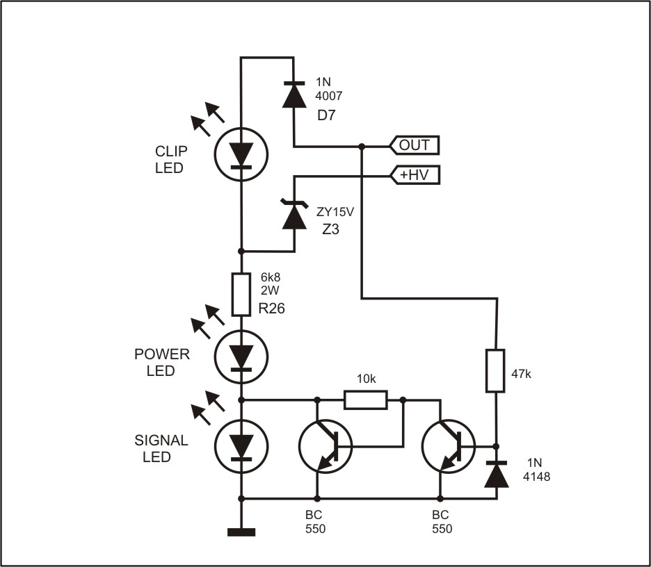

So i m gonig back with post #129 design http://www.diyaudio.com/forums/solid-state/236256-retro-amp-50w-single-supply-13.html#post3649584 which is your original schematic plus a vbe multiplier and a signal,power,clipping indicator.
Do i have to change any values from this signal,power,clipping indicator from your AX20 to work with this retro AX6?
Nice work, use 3k3/1W instead 6k8/2W in clipping indicator.

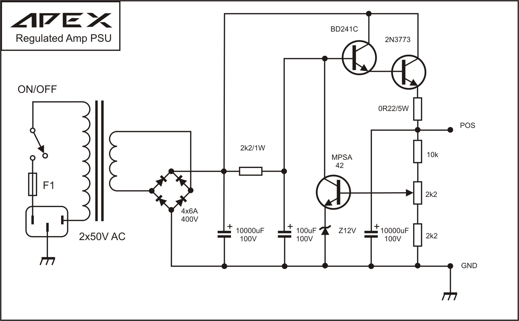

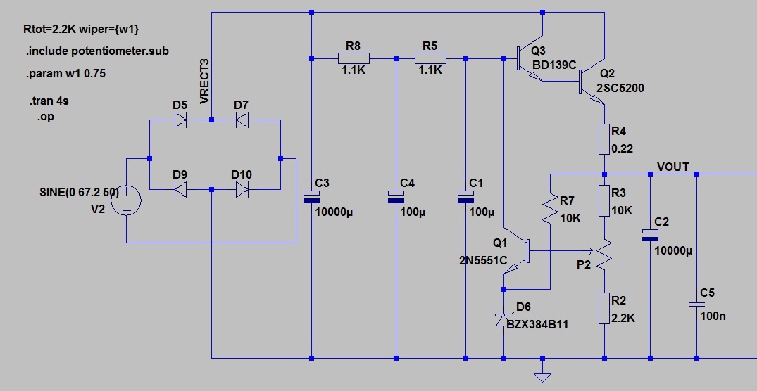

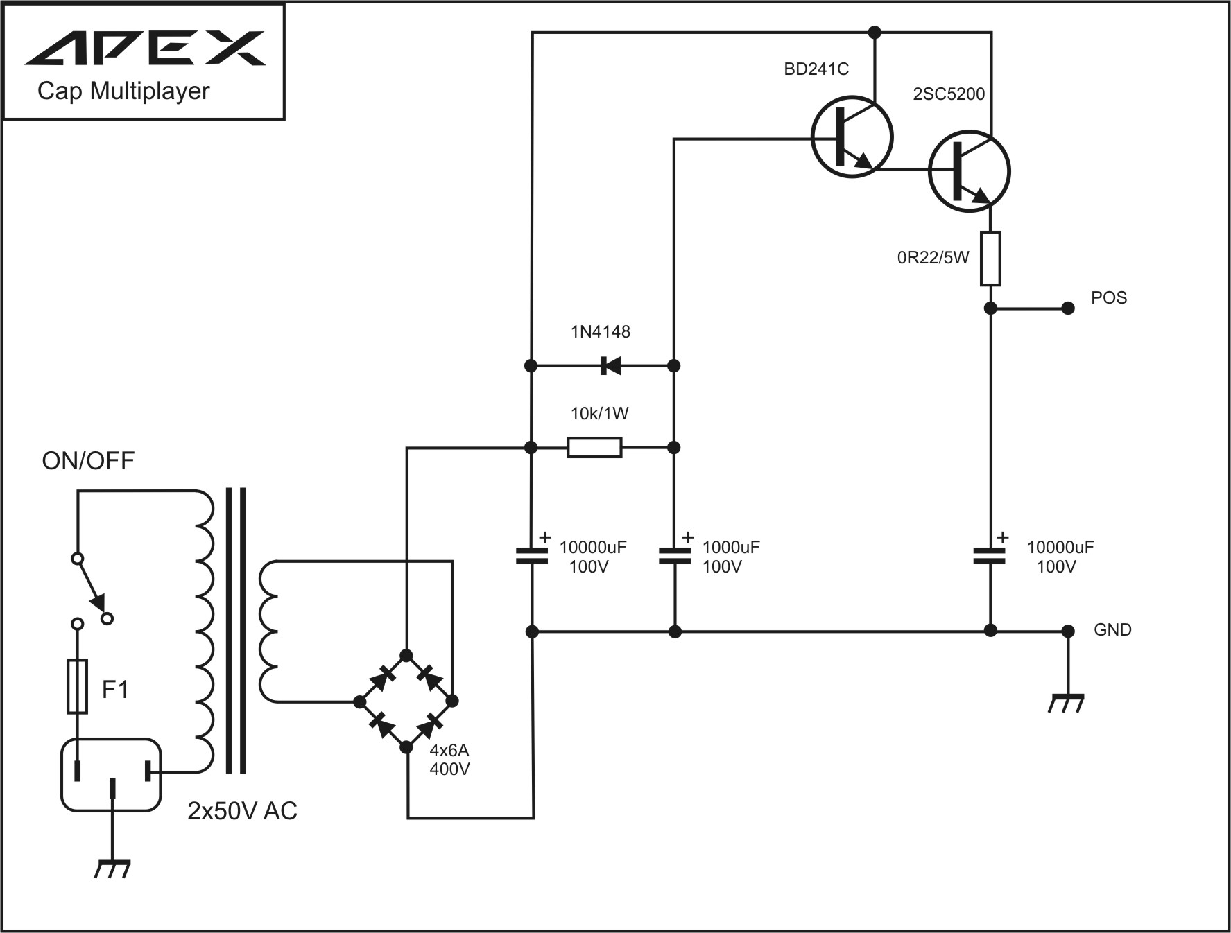

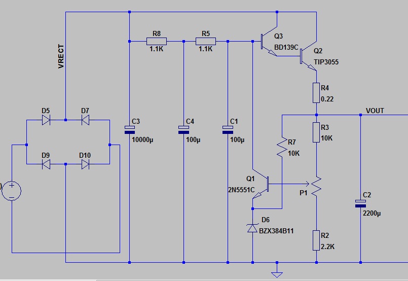

Thank you.I really like your amp.About your simple regulated psu for AX6 you posted,can it drive adequatelly 2 channels? I have a 2x24V ac transformer so i am planning to connect together the center cables so as to achive 48V ac. In your simple regulated psu for AX6 Ripple rejection can be improved by adding an extra resistor and an extra cappacitor.Thus,a second order filter is created which reduces the hum more effectively. What to you think?should i give it a try or stick to your original design ?
Beter use capatience mutiplayer with this low rail voltage.
do you have any capacitance multiplier circuit using transistor?
You can made it from Regulated PSU.

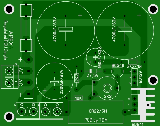

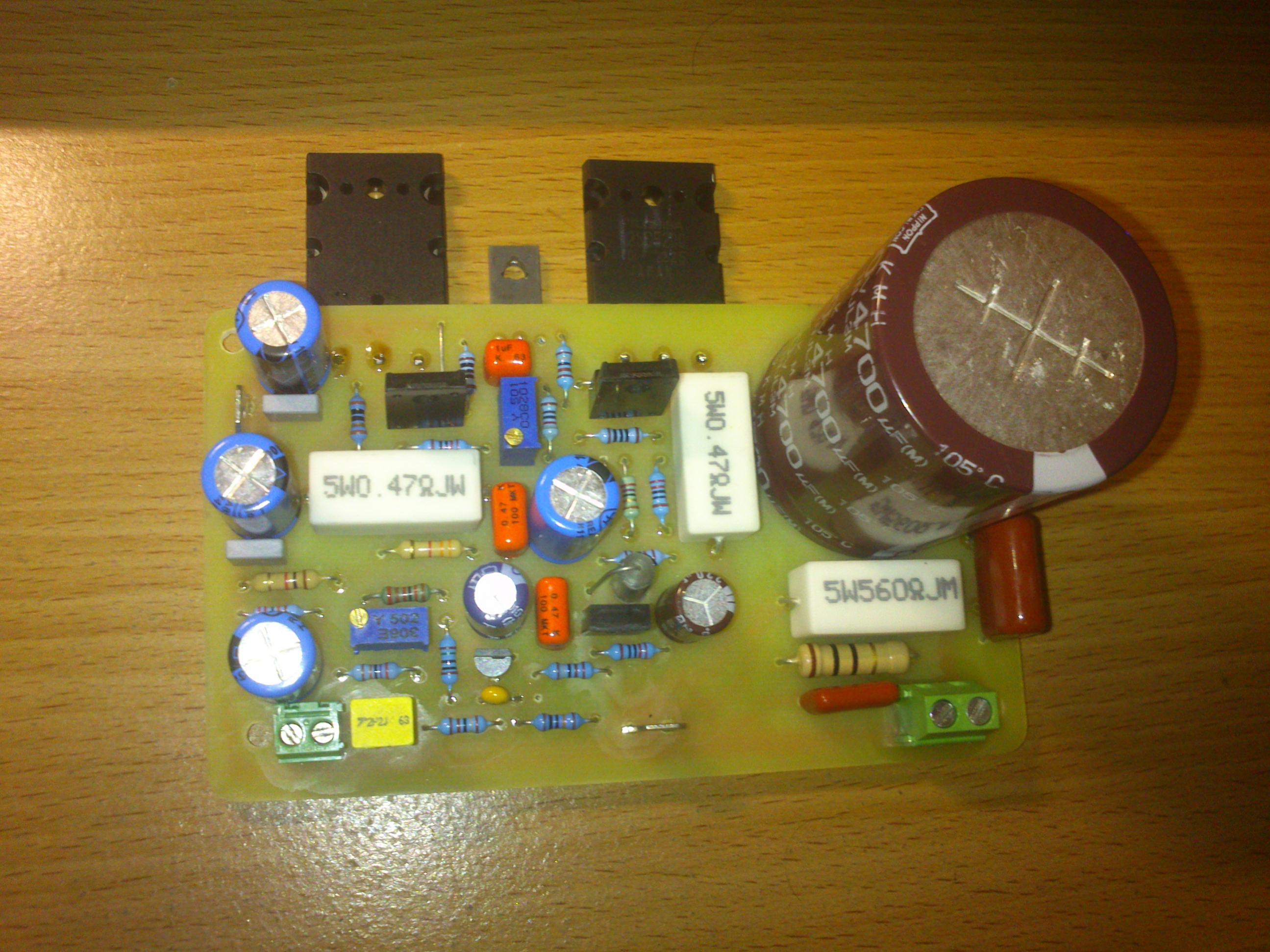

Very informative AndrewT. Thanks.In the case here,we are talking about a single supply PSU so no worry about the voltage at the output of the amp.My progress so far.Any comments for parts placement ,ground returns,and traces are welcomed...(some traces are aniqual in width but wiil be fixed.)
