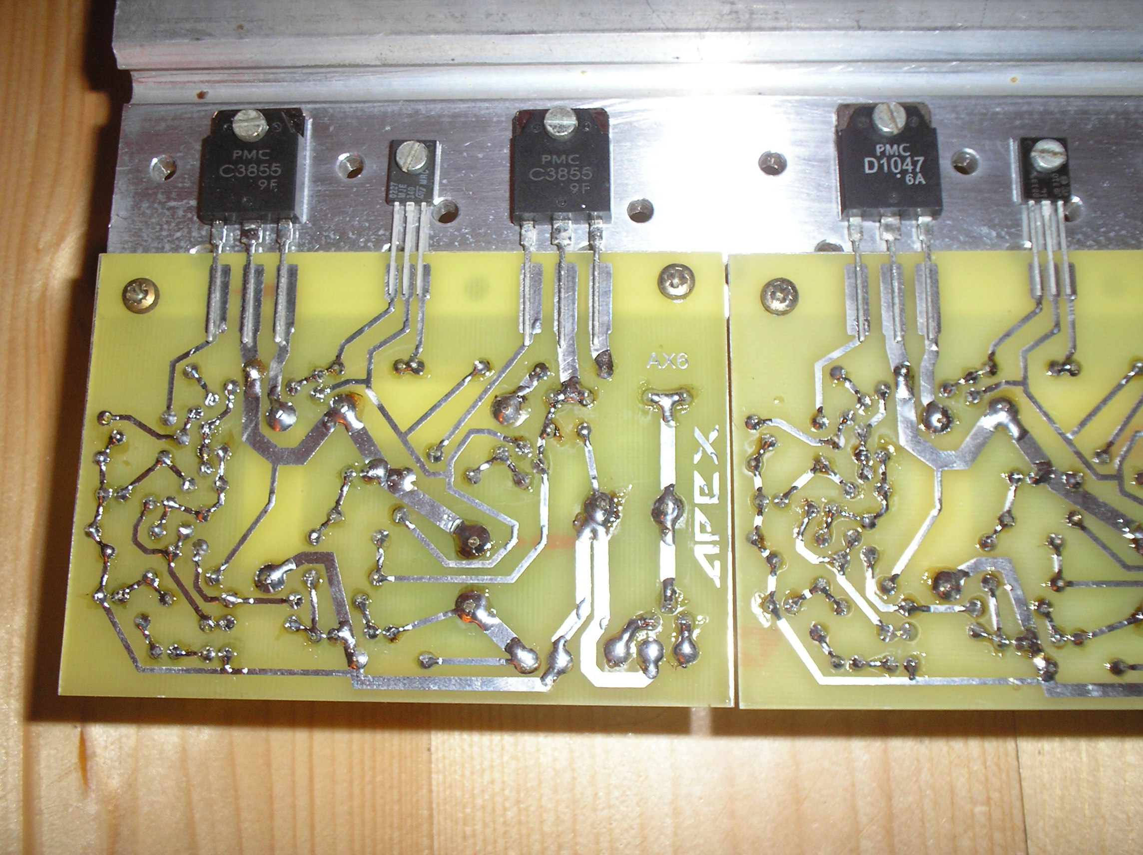

thanks Mr.mile,using 2n3055 RCA old stock with Vcc 40Vac and 5Ampere like ax14 sound
AX6 sound like AX14?
my AX6

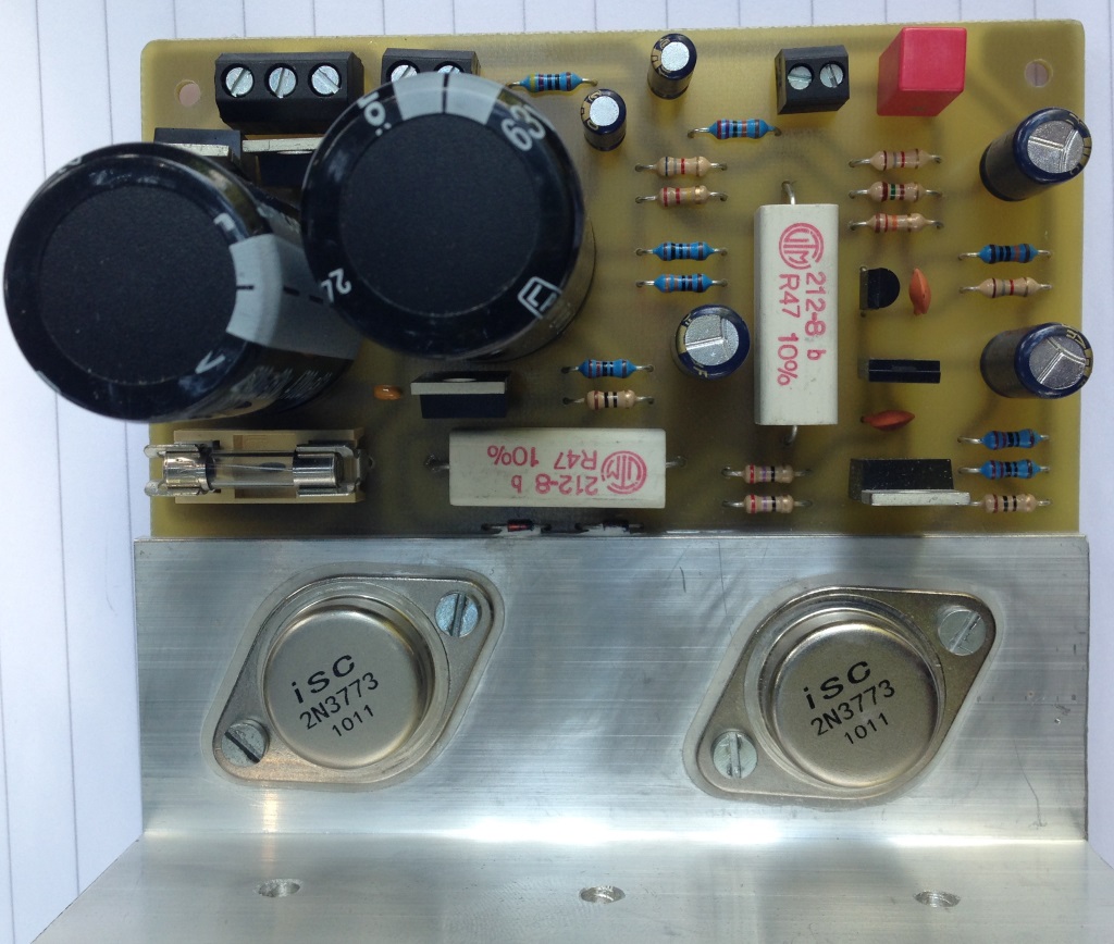

Very nice little amplifier.
Built and work. Nice warm sound.
regards Olaf

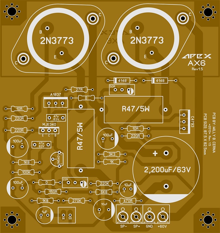

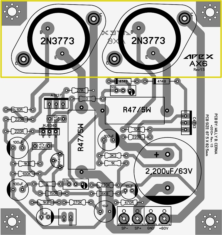

Hi, here are the files. Sorry, I made this layout only to print. The components are not named. Basic for the layout comes from Willy B. Cerna from post #79. Please look at the pictures there and check the component values and the polarity of the capacitors. May be you will find the better layout there
regards Olaf
Hi, here are the files. Sorry, I made this layout only to print. The components are not named. Basic for the layout comes from Willy B. Cerna from post #79. Please look at the pictures there and check the component values and the polarity of the capacitors. May be you will find the better layout there.
