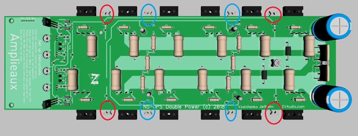

Yes i know that's the drivers but how many drivers?
The drives are circled in red, the clamping transistors in blue. They're all TO220s. 3D rendering is a bit off.

Apparently a pair of drivers seems to serve a pair of output transistors.
Doesn't that demand matching all the drivers, with the extra cost that supposes.
To me that's the problem with some Goldmund versions, as that is difficult (and expensive) to do in DIY.
Yes, as Jeff just mentioned, each pair of drivers serves 3 output pairs.
All drivers are loaded with the constant current sources. So each pair of drivers employs 4 transistors, not 2 of them.
No particular matching required - if hFE difference is less than 2x it's no problem.

What exactly do the clamping transistors? Limiting?

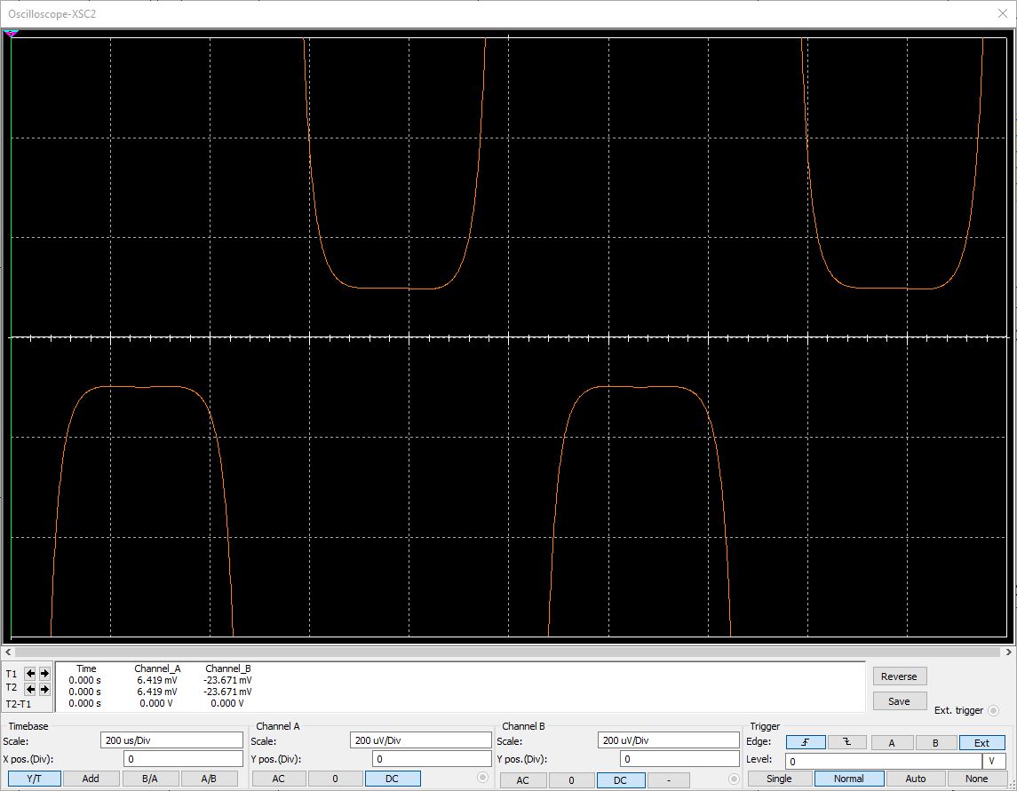

Limiting the minimum bias. This is a part of the non-switching mechanism. There is a second bias spreader, setting the minimum bias used when the positive or negative half of the OPS is not used, preventing the output transistors from closing. As soon as the bias voltage reaches that minimum voltage, it gets clamped there.
The attached image shows a close-up of the crossover region of the output stage (voltage drop over the emitter resistors, proportional to the collector current). You can see the voltage does not drop to zero, being clamped at a certain value - output transistors never close.
