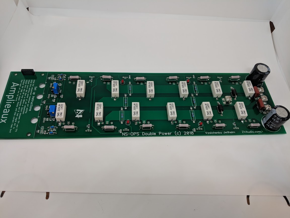

The boards arrived today. The boards are so large hey won't fit in my toaster oven so I had to solder them with a hot air rework gun. I don't have enough output devices to power it up though.

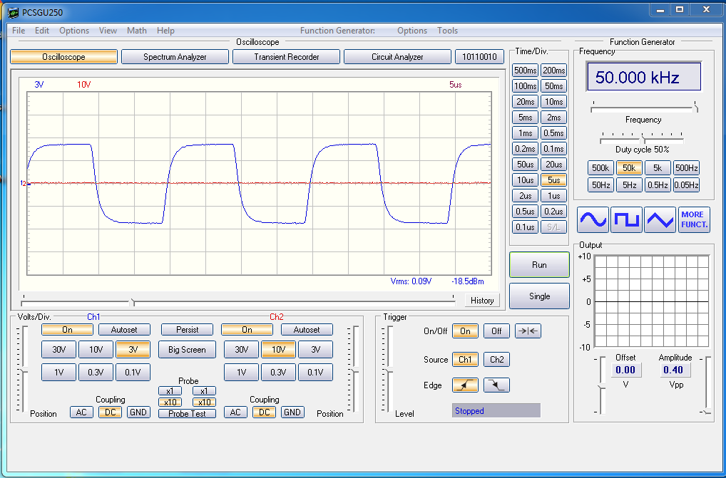

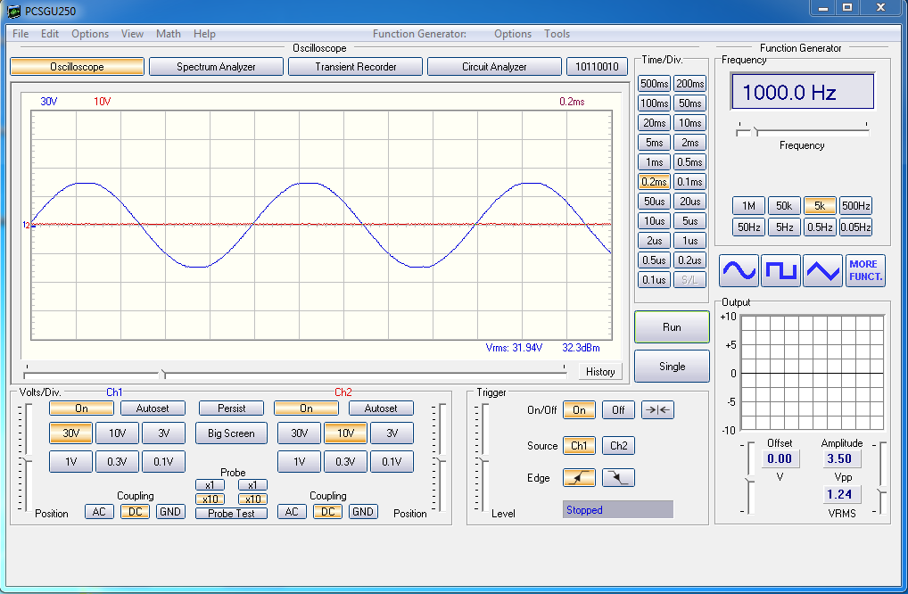

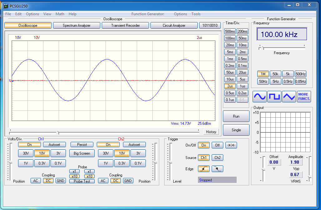

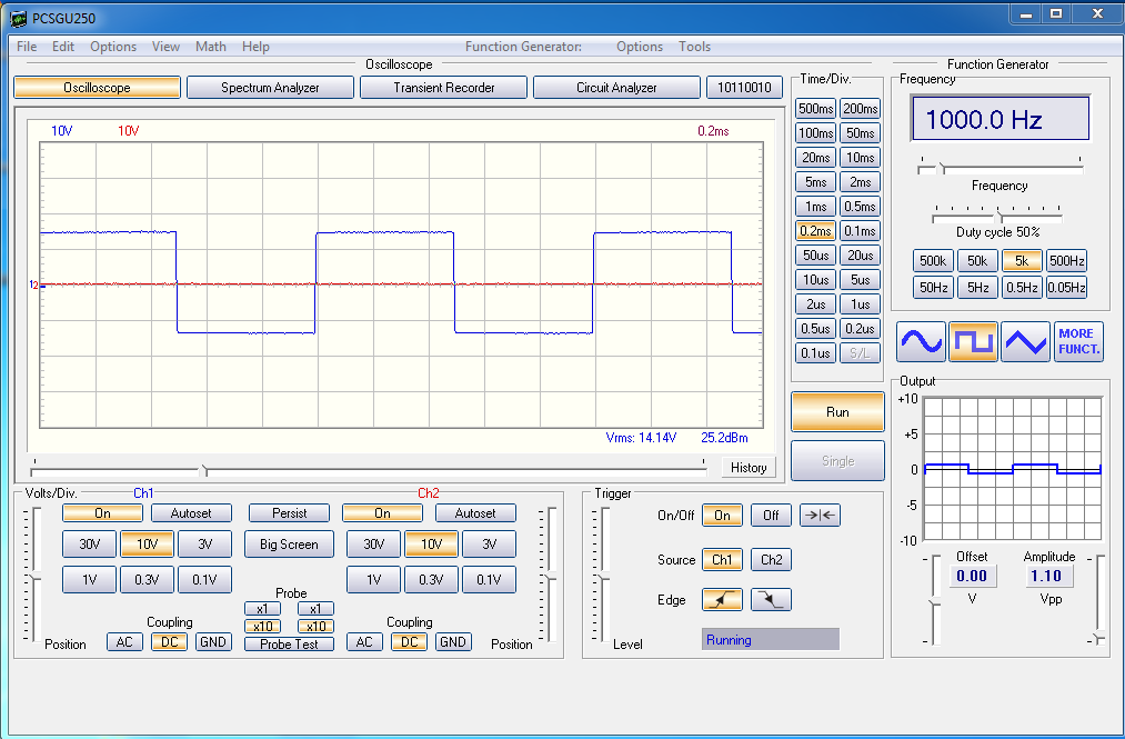

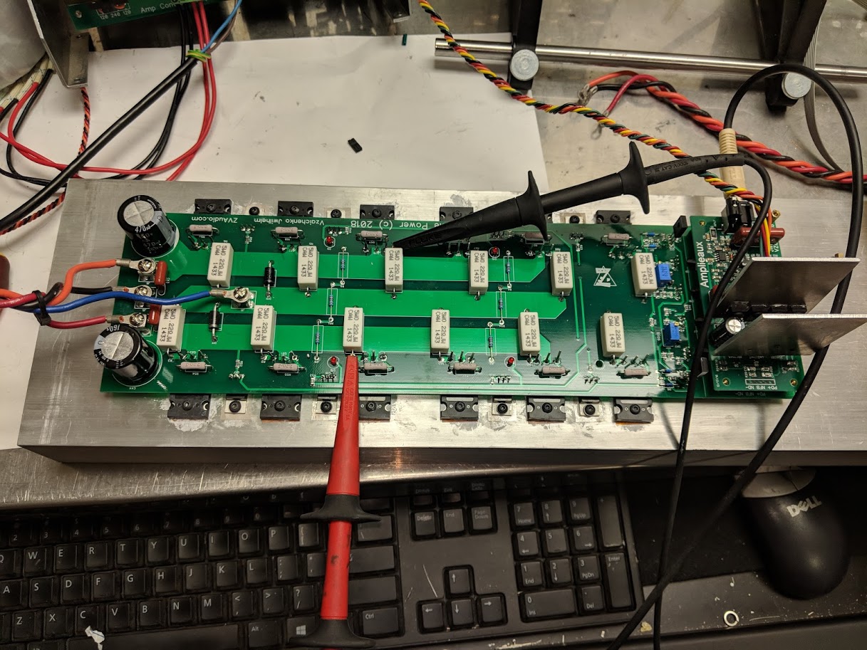

It's running nicely now. I did some quick scope tests with +/- 56V rails with teh X4-JFET input and an 8 ohm dummy load. I gave it a short audition too, sounds great, very punchy bass! Dead silent with no signal as always.
Pictures are 1k sine at clipping, 1k square waves, 50k square waves at 100k sine.
Next I need to put together a chassis with proper cooling so I can done some proper high power testing and stereo audition.
